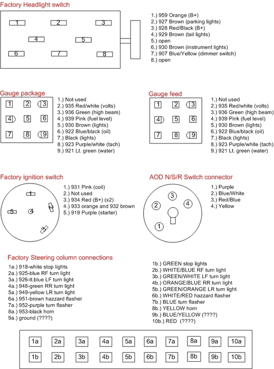

Did you have any problems hooking up guages and switches without the stock connectors?
No, but I replaced all of my gauges at the same time with new Autometer ones.
So I am not a good example of tying it into the old gauge harness. Sorry
I also bought insulated spade connectors for all of my ty-ins. that way if I made a mistake, all I had to do was unhook the connection and route it to the right spot.So far it has worked pretty well.

Edbert,
I used your illustrations and downloaded the instructions for the painless kit from their site, that combined with the EZ instructions answered all my questions.
I would also consider a trunk mount if I had to do it over again.
Your site was VERY helpful, so thanks for taking the time to share your info.:flag:

Now for the embarassing part...I was looking through my documents the other day and saw that I had fugged up my drawing for the light switch, and then saved it AND published it to the www...AAARRRGGG! I know I can recreate it but figured if anyone was sharp enough to save a copy it could save me some effort. Did you make a local copy by chance?
I think I have a local copy at home, I am at work today so tomorrow I will look into it. I'm pretty sure I do have it though!
I have saved copies at work as well, check your email!
I updated the doc and the webpage. Here it is with the missing part put back in..
