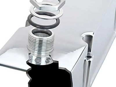

There's also this valve cover breather clamp from Wysco, pn WA6090, $23 apiece at Jeg's (pn 938-WA6090):
This looks like it would provide a totally oil tight seal at the valve cover surface, and the added height would prevent any blowby oil from coming out the breather or at the supplied O-ring that the breather plugs into.
