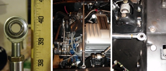

Here's a home made one... look at the bottom of this page.
http://www.midnightdsigns.com/Mustang/Engine.htm
