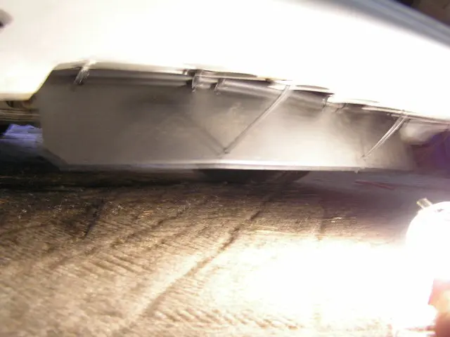

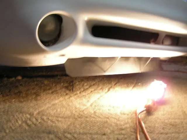

The air dam under my front end that i installed in January is really paying off now. My engine used to run alot hotter cruisin at 70 80 90 . now its sittin at the lower end of the gauge.
i used a heavy duty lawn edging material with zip strips i have hit curbs and have done 110 mph withit ,it is attached just in back of the rad intake and then brought it forward on the bottom with three heavy zips...it looks alot better than in the photos, and is easy and fast to replace ....just need the material,torch for a hot screw driver to make holes
