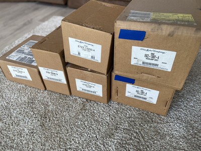

NOS pipes are getting up there. Guy on the 93 Cobra group sells them for $1k each and they sell at that price.
That’s a tad bit high IMHO but the fox market is bat:poo: crazy right now so who am I to say it’s high.
Case in point

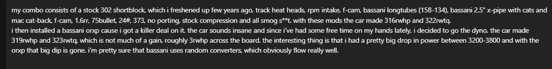

Didn't find the thread, but found an older post from the guy I am thinking.
3HP gain going from a Bassani catted X-pipe to a Bassani off-road X-pipe. Car was making 316HP to the wheels at the time. I know he's got a turbo now and has done a bunch of dyno testing. I'll keep looking for the post as it was pretty interesting.
