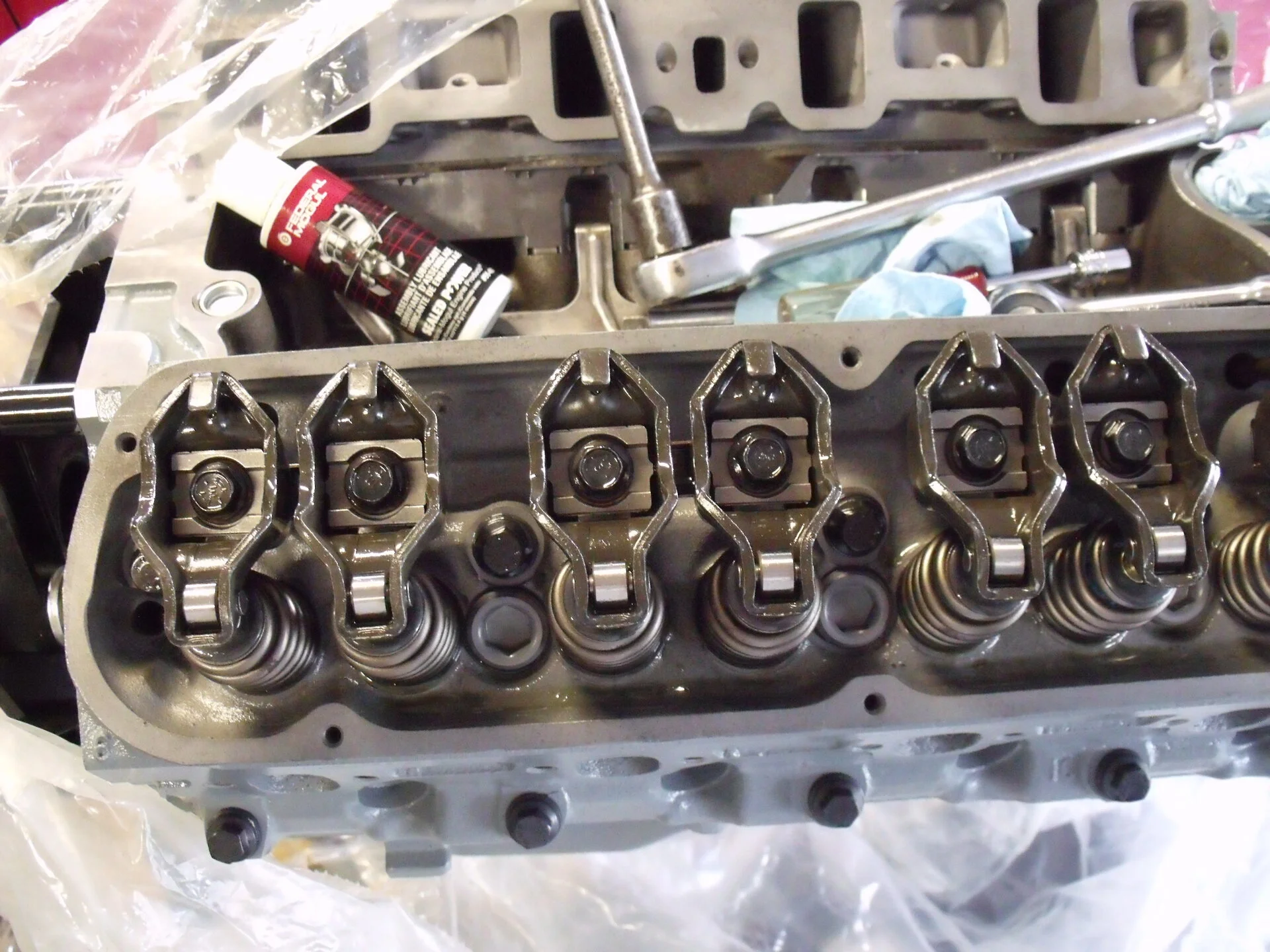

Lunati makes these roller tip... I am going to try out a set on my P heads......
