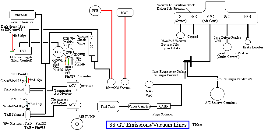

The maze of colored snakes on the passenger side strut tower are the
vacuum lines that work the emissions gear. You patch plastic lines by splicing
in the proper size rubber hose between the broken parts.
The white line operates the EGR valve.
Diagram courtsey of Tmoss & Stang&2birds.
See http://www.veryuseful.com/mustang/tech/engine/
for more good diagrams.
