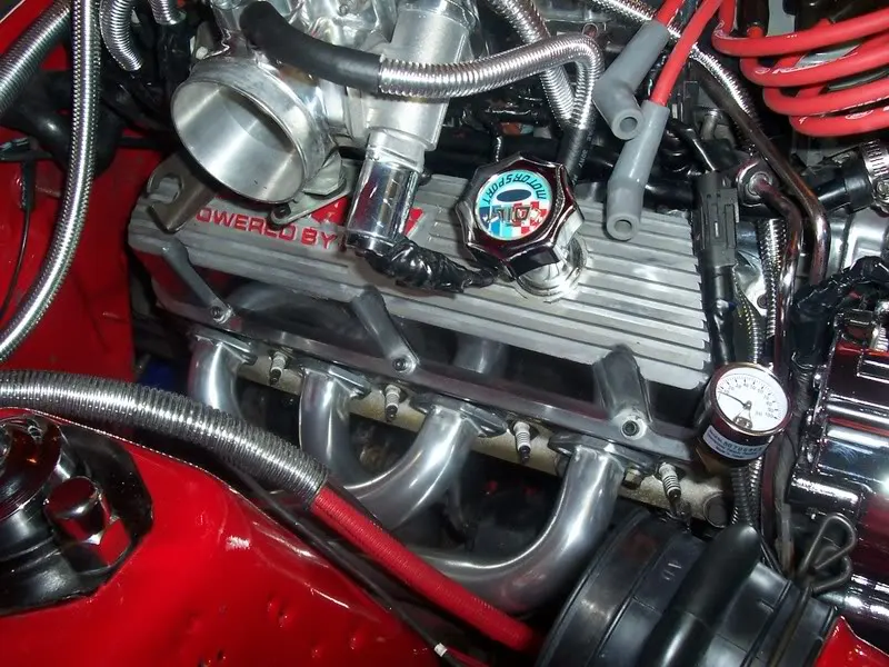

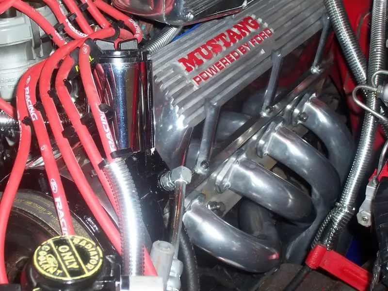

Well I figured I'd put a pic or two of my first fall/winter projects. I was tired of watching my LT's get worse every day..I did a high temp paint job that held up for less than a yr...nothing like seeing 5 hours wasted! So I sent them out to "high tech coatings" just outside of town. Very pleased with the result, price was far less than new..plus I knew these fit so I wouldn't have issues if I had ordered new and found problems. Aside from a few scratches during the intsall (in non obvious locations thank god) the install was a breeze. I got the big "great...I'm hungry" from the wife, so I thought I'd share with a better group :)
So from this mess.....
To this.....

They will significantly reduce the life of a starter. Usually members will upgrade to a mini starter offered in later models. They will also require you heat wrap the clutch cable where they either contact, or come in close contact with the header pipe.
