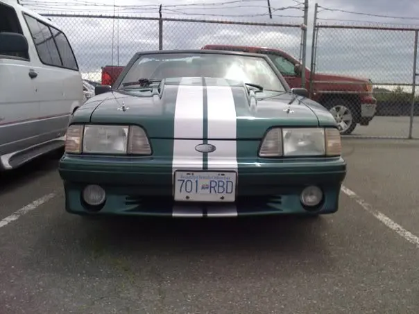

Ive also read that the Gts are suppose to have a deflector underneath does anyone have a pic of one I have no clue if I have one heres what my front out looks like

I can't tell if you have the deflector or not. It's just a piece of plastic - you'd know if you had one when you look under the car (and you'd probably catch your chest on it while changing oil).
I'd get a deflector and if you need fan components, consider upgrading your alternator and going to an E-fan.
