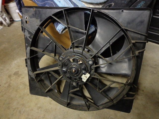

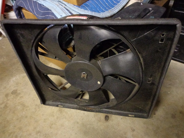

This is a Lincoln Mark VIII fan. Fits the 93 and under 5.0 radiator perfectly. Not much clearance. Maybe a half inch from back of fan to water pump pulley. You have to cut the shroud back until the point where the fan almost rubs the radiator. Rear-ending someone will send the engine into the fan and fan into the radiator. If you have the 94 - 95 short water pump style then you have more room.
You can see on the back side off the fan. The center metal ring where the wiring connector is. The parts on top where the black paint is missing is where the water pump pulley bolts dinged the fan.
You can kind of tell how far back I cut the shroud. Any further and the fan rubs the radiator. I had to sand off the ribbing and add holes on one side so I could bolt on the overflow tank. Added a strip of rubber insulation where it presses up against the radiator.
