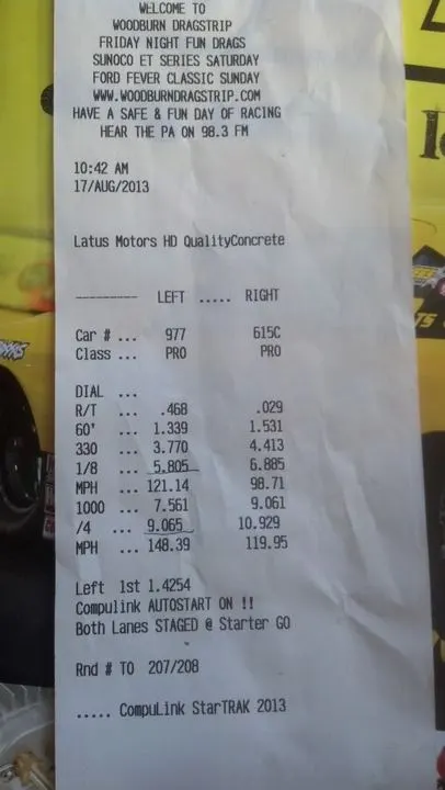

here is our quickest pass. literally ever number on there is our best ever... that said it was 85 degrees and not exactly mineshaft conditions.
