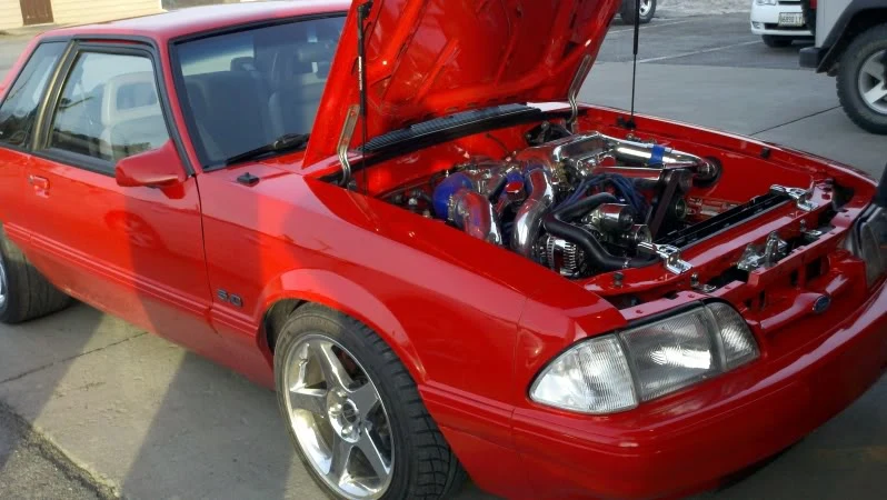

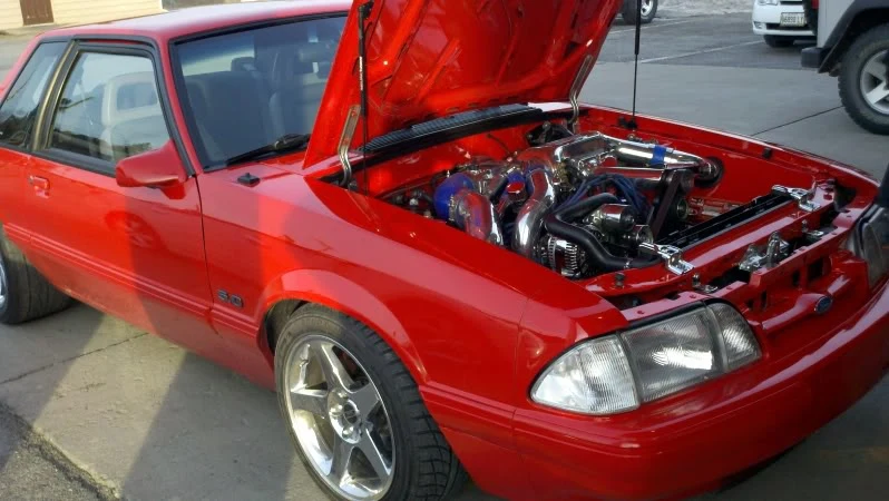

This is what I like someone who wants to make a PR KB go fast. I'm gonna be tapping at your door soon. Here is a link to my A2A on a Dart based 363 I made 550whp and 685TQ last fall no track times yet, but they will be coming next summer. My winter projects include 2o5cnc Tw heads new Freezy cam larger Sheet metal race intercooler and 3.5 inch pipping and to top it all off I'm refabing my intakes for a 2.8L H series :)

Well, the Trick Flow R lower manifold is taller that the stock or GT-40 lower, so going to a stock type lower intake would shave about 2 inches off of the height. Also the custom outlet manifold from the supercharger could be trimmed down about 1/2" without to much disruption in airflow. The upper manifold that holds the intercooler core could also be trimmed or shortened a bit. Part of the reason for the tall cowl hood is that the throttle body is positioned facing up and when a air filter is installed for street driving, you end up with a tall hood. If you did not mind a longer path for the airflow, the throttle body could be relocated so that the overall height is lower. We were interested in MAXIMUM airflow. Thus this is how it ended up. The original design was under a Cervini hood that was much lower. But we found that the shorter the inlet path to the rear of the supercharger, the more boost and power we made, and since the car was being driven less and less on the street and more and more on the track the big cowl hood was not an issue. The current design is the 4th or 5th version and the one that promotes the most power. Being all custom, and having to farm out the aluminum welding, it has not been cheap, but it is worth it. Outside of the welding, all of the fab work and design work is ours. The hrs it took to map all of this out is crazy. Plus throw in dyno time, track time ect and it is no wonder it took 4 years to get to where we are. NOBODY sells this stuff. Hell, that is what makes it cool, and that is part of the reason we did not go turbo or ProCharger, we wanted it to be different, and half of the fun is in the engineering exercise. We are now starting on a similar set up for my car, with a few differences thrown in, namely, I want a cleaner looking install.

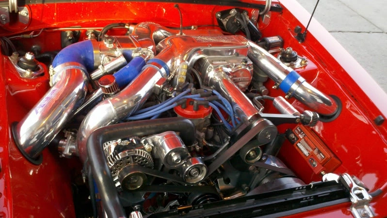

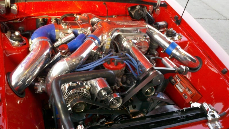

Still great numbers on the dyno and no doubt with an auto getting accurate dyno results is hard. I to ran the HP calc and came up with your number RWHP. The pictures of the motor you posted had what looked like a older 2.2L KB, since then you pit in the LC 2.8L. I would love for you to post up more pics of your setup with the LC 2.8L. You guys are real poineers here and I respect and admire your attention to this project. As you can see I to love to think out of the box. I would love to pick you brain on your project great job. What is your pulley combo with the 2.8L crank and snout to get the 21psi before IC.
Old picture was posted. Will have to get back to you on what crank and blower pulley were used. Also in the old picture, the intercooler tank is in the engine compartment, and it now resides in the trunk. The supercharger snout is off of the 2.2L combo as Kenne Bell does not make one for the 2.8L LC for a 5.0 PR application. To fit the 5.0 PR engine the supercharger was flipped over because otherwise the blower drive is offset to the wrong side. Thinking back, it was actually the front blower case that was flipped, and not the supercharger itself. This required tapping the front case for the fill plug/dipstick to be on the new "topside". I believe in the next month the engine will be going back together and I will take and post updated pictures at that time. We have not taken very many pictures at all as we did not think about doing a "progress" thread. So pictures are few and far between. I will be sure to takes lots of pictures when we put it all back together, plus I now have a good camera for doing so. We would LOVE to get a 1.29 60 foot like that 94 Cobra, but is Very hard to get traction with only a 8.5 wide tire. Our best 60 foot to date is 1.47. We may come springtime with the new combo put a 28X10.5 tire on just to see how fast this bad boy is. :)
