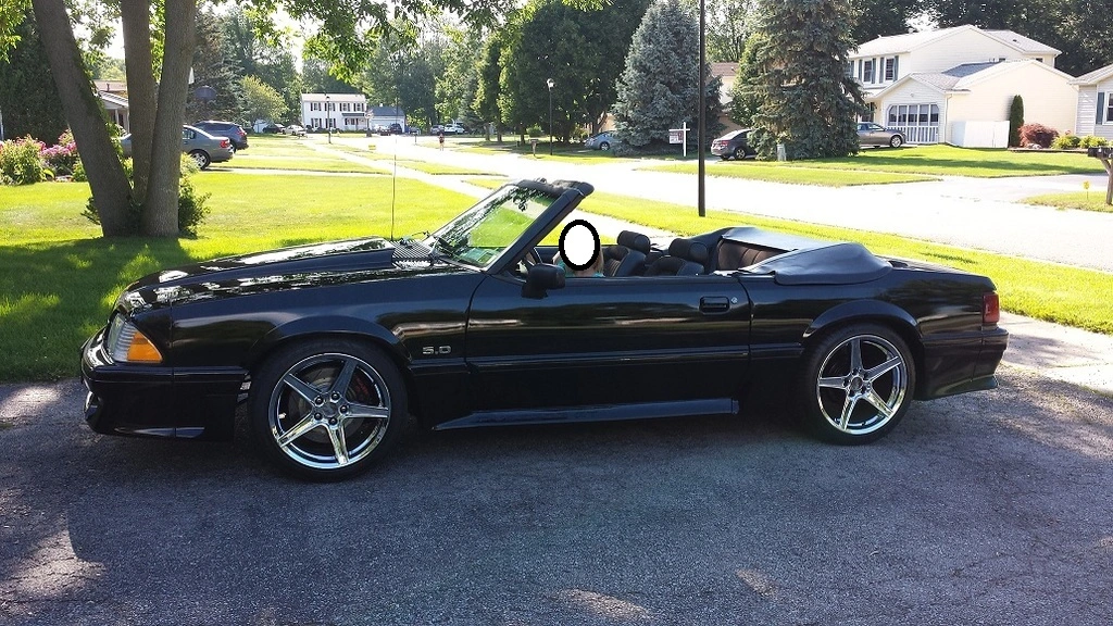

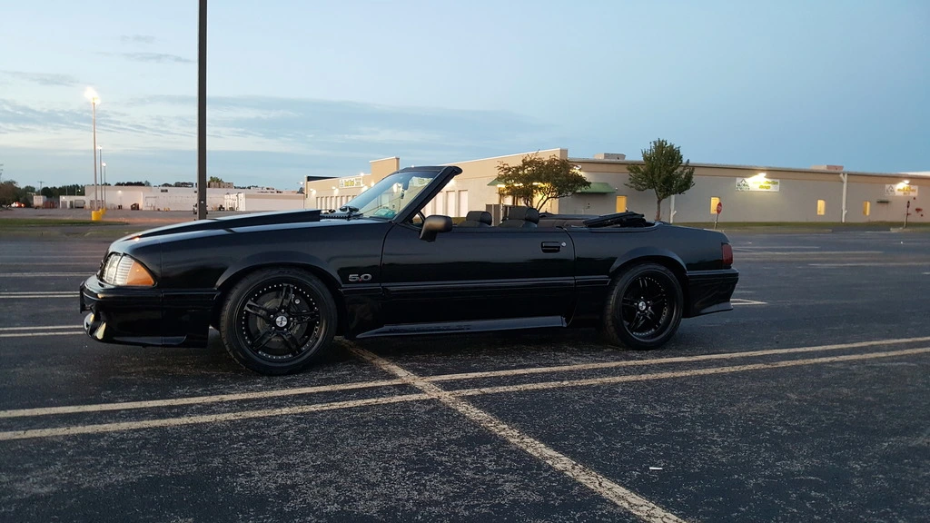

I have a 1990 foxbody mustang I want to go 18's all the way around i know I'll probably need to roll back fenders especially 275/35 /18 in the back just know how to seen video's but thats it

Its Beautiful the way it sits man.

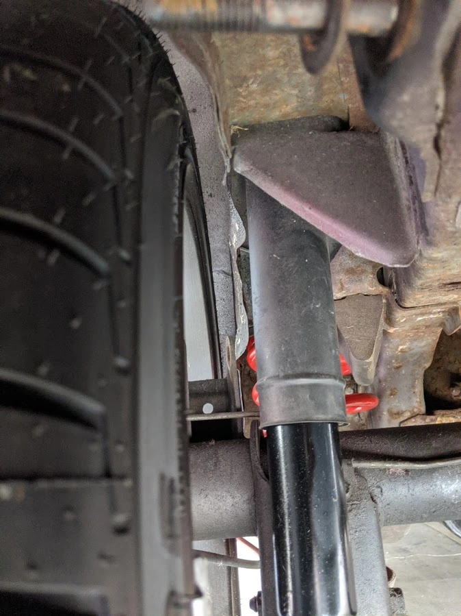

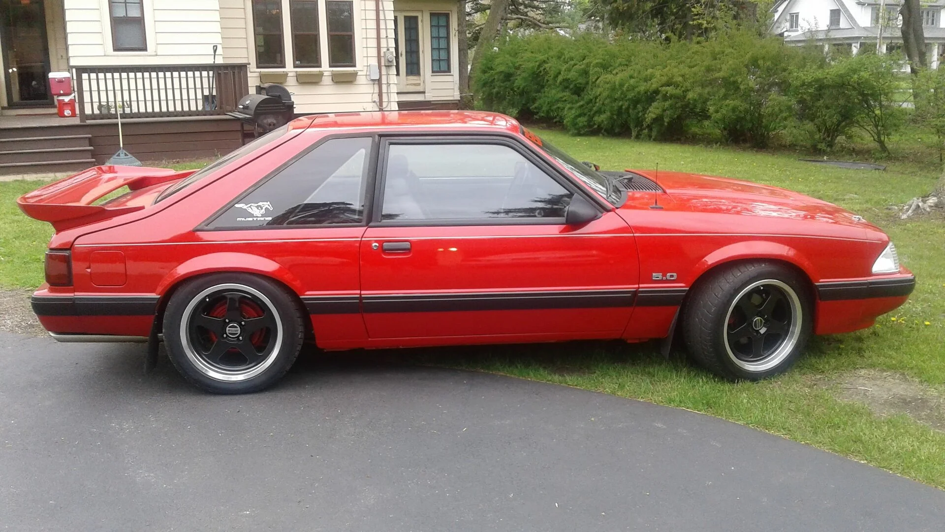

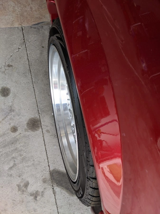

I used a 5/16 inch spacer, it rubbed pretty good, I removed the quad shocks and "massaged" the inner fender, I might try out a 1/4 inch spacer to bring them in a hair, the Car isn't on the road yet so I can't test it out on our wonderful roads but driving around the block nothing is rubbing, here are few pics to show how much room I have.

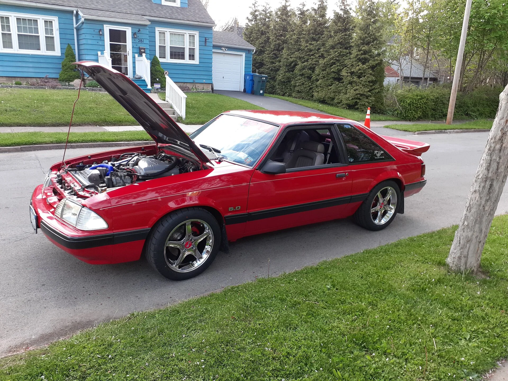

So are you from Rochester? I selling my cobra r rims and tires I just bought and put on this week 245/45/17

yeah I live in Greece. I massaged the inner fenders first, but was limited to much space I had so I went with the spacers.

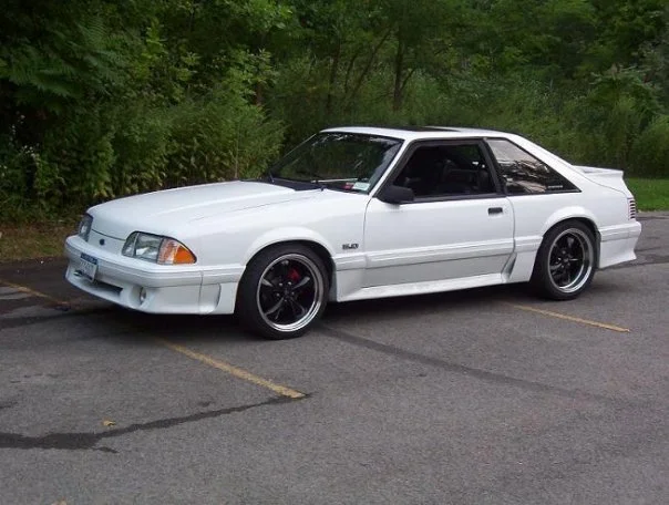

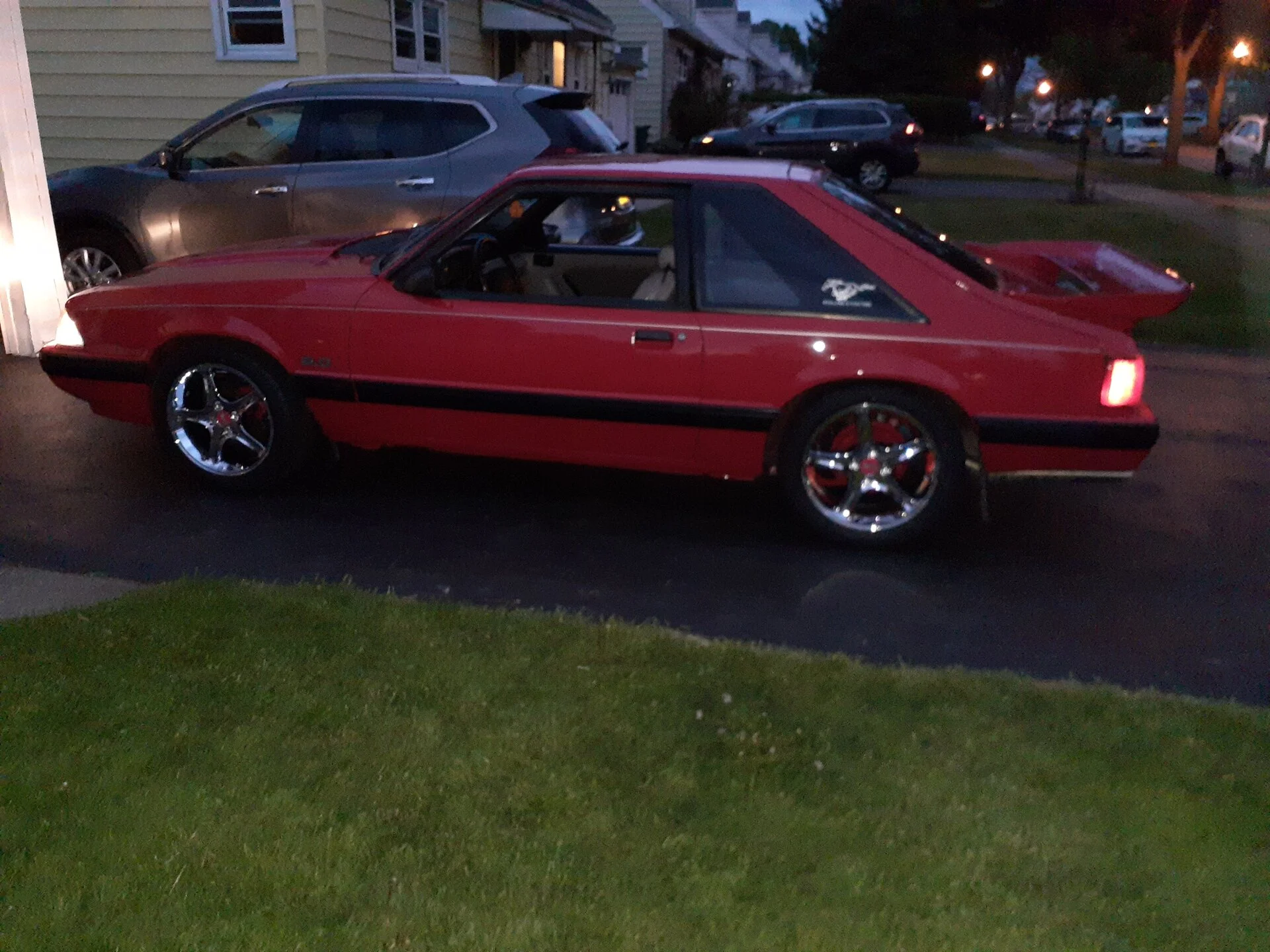

spacers were to pull it away from the inner fender tub not the fender lips, the Lips still had to be rolled or you'll cut the tire. I've run 18x10's on all my foxes the vert and white gt had 285/3518's with 22MM offset wheels and all needed the fender lips rolled
