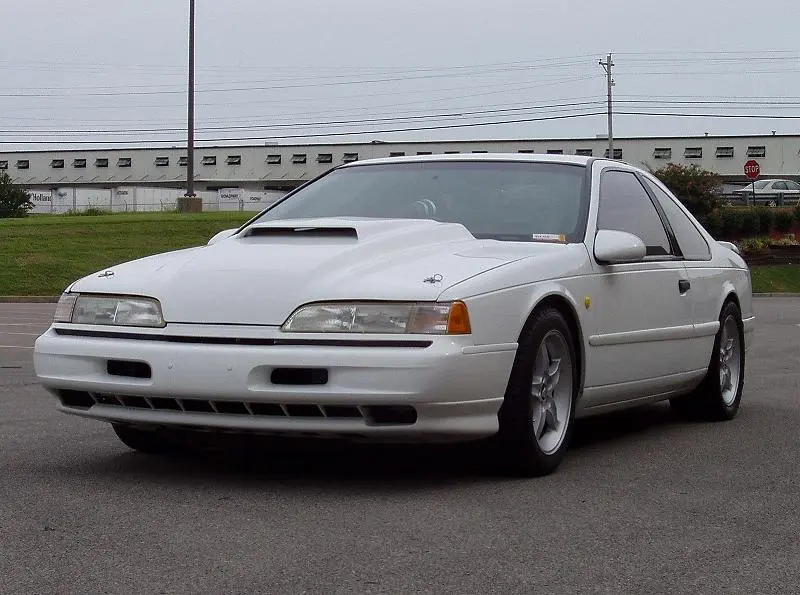

Considering the cost of the hood, the labor of getting it to fitted properly, then getting it painted, I would never run a fiberglass hood with out real pins, and the hood latch working properly. I have seen too many come up. I like the look of them also, if installed properly.

nice t-bird
i have the latch on my fiberglass cobra r. but hardly ever use it cause alot of people ask to see the engine and i get tired of having to pop the hood. all i have to do is pull the pins and raise the hood.
