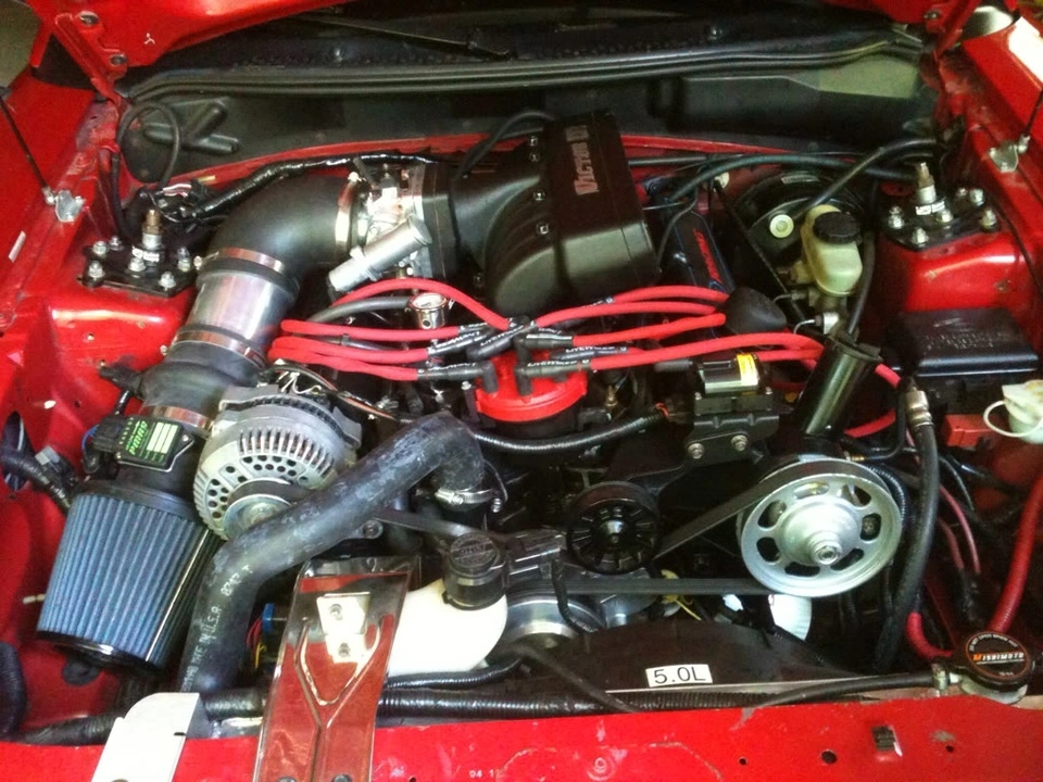

Got the livewires on today after they were on back order forever! Had to have summit call DUI and have them send the stupid things out to me. Anyway the engine mods are complete. Found a few loose spark plugs when doing the wires, prob had a lot to do with why it was kinda lacking some power. Tightened those back up and took it for another drive, everything seemed good (except for the small seeping coolant leak from the thermo housing which I'll have the dyno shop fix, Im doing doing stuff to it for awhile now) and did a nice little lighting up of the tires in first gear :) Been along time since I have been able to do that, the STI is not to good at burn outs lol. Also fixed the brake pad dragging on the caliper issue. No rubbing now and it brakes really well again.
