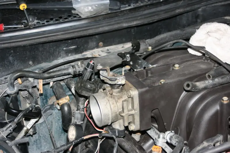

"custom" throttle body. really, it's the one off the explorer--got rid of the 90* elbow and bolted it up sideways with my iac and tps. my bro-in-law (who's a sociologist, hehe) fabbed up a bracket for the throttle cable/cruise control cable using my original tb quadrant. works quite well and pushed the gas pedal up more even w/ the brake and clutch pedals. gonna need to put a stop at the back of the pedal, but it's definately nicer than having it way down into the carpet. going the fox-tb route would've been much more simple, and the tb elbow adapter would've taken too long to get here, but we really wanted to use the explorer tb as it looked way bigger than the fox tb and my orig.

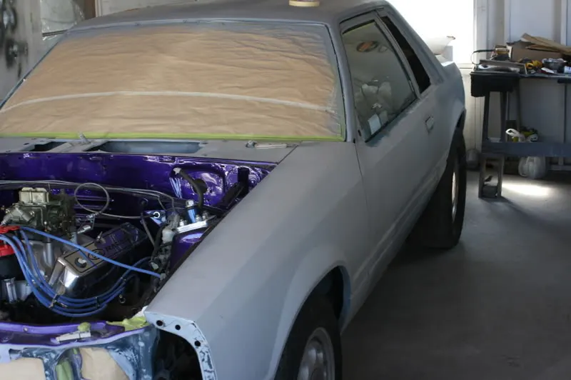

foxbody my bro-in-law's brother (guy who painted my car) is building up:
color's some house of color purple. definately nice for the color.

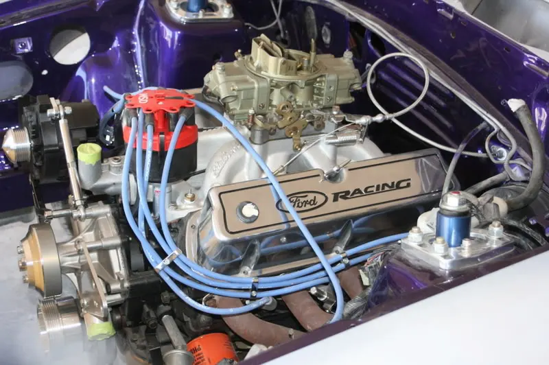

the engine my bro-in-law built for him:
