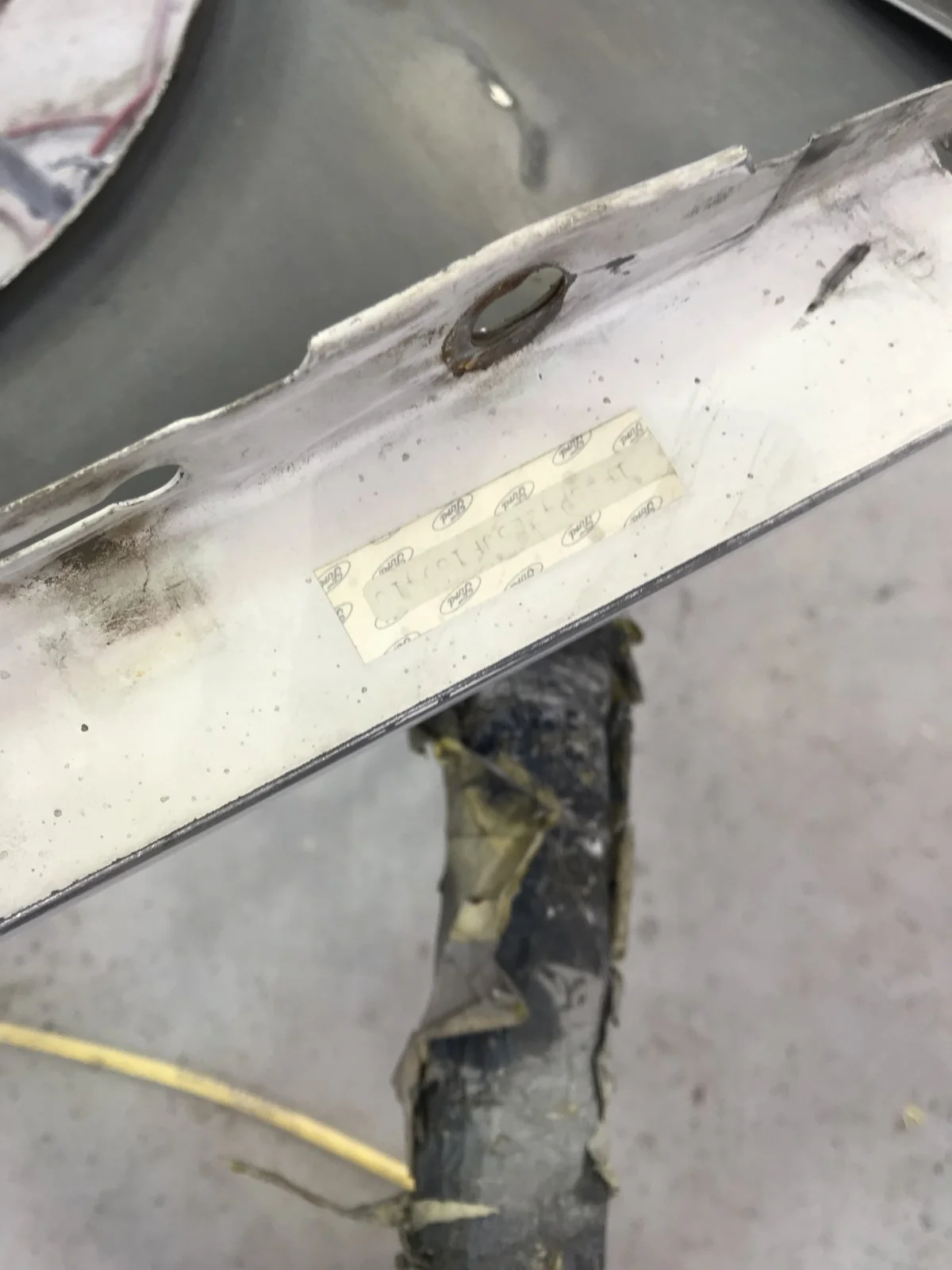

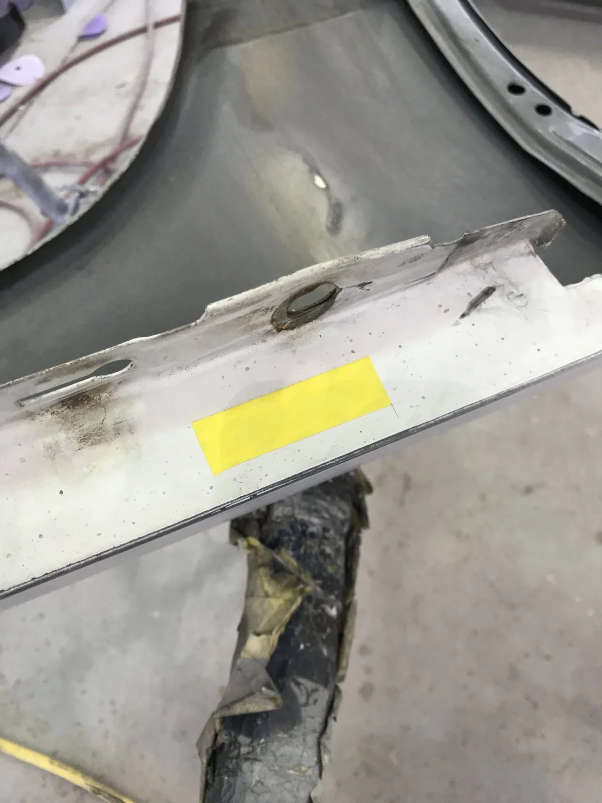

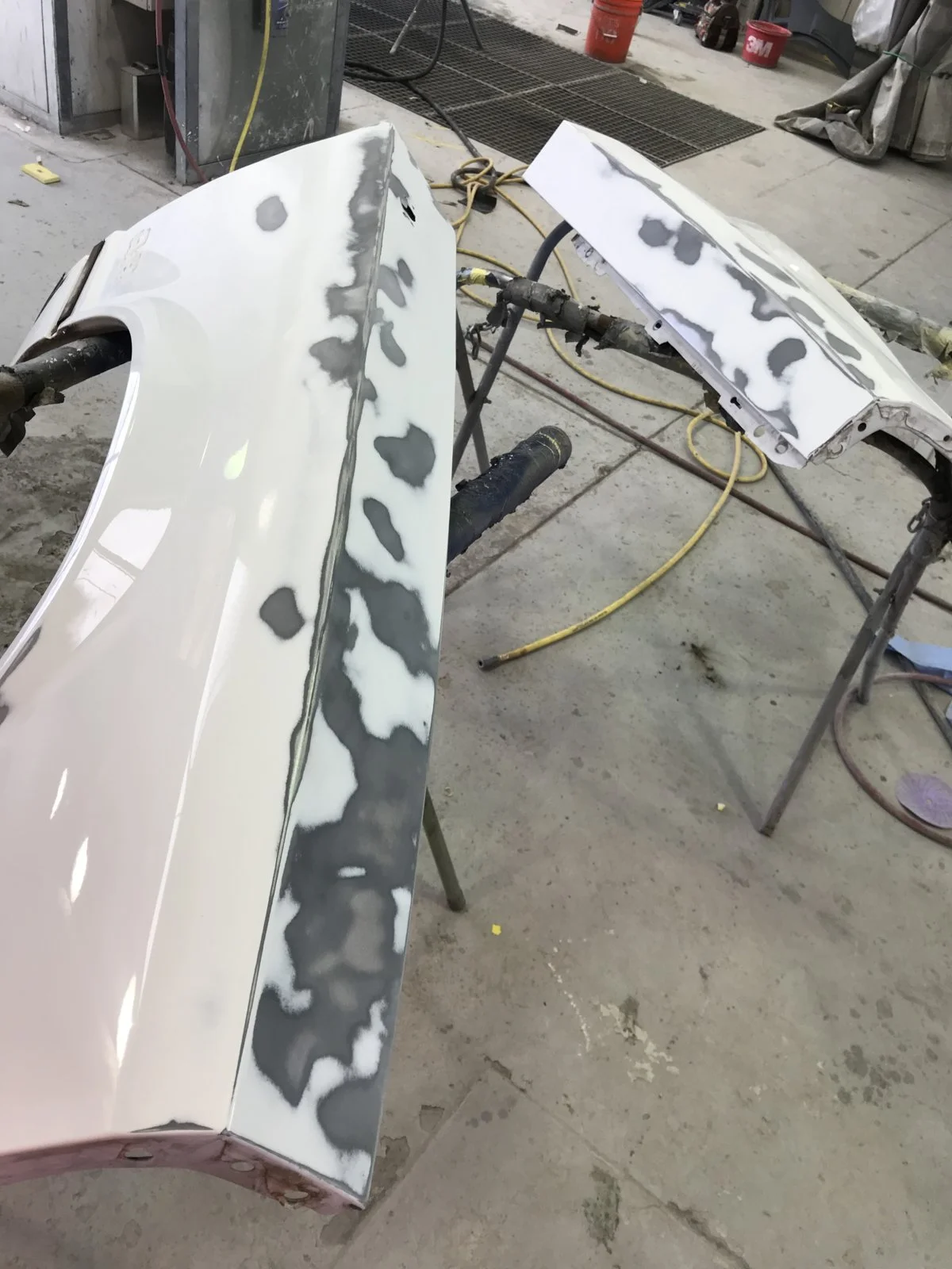

Getting the fenders ready for primer. I have a little bit more work to do to the bumper so I won’t prime that now, plus I have time and it’s plastic so no rush. So I’m going to prime the metal parts so they don’t start to rust in the meantime. I’m hoping to have the pulls on the front end done sometime this week so I can mount the fenders back on the car. I’m pretty much just going to tackle one panel at a time. Keeping the vin stickers is critical for me so I taped them off, even though you can barely read em.

Don't get any lacquer thinner or wax and grease remover near them stickers even with tape on them, it wipes the out.
Yes sir, good call!
