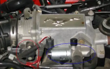

Alright since I'm still confused about where these things are I took some pics of the throttle body and the surrounding items. Can someone tell me or maybe somehow mark on the pictures and circle the items I am looking for. I am looking for the IAC, and the TPS. I also need to know how are you supposed to adjust the TPS sensor. Can someone show me where the screws are? Also when you are checking the volts with the meter, should it be on AC or DC Volts and on what setting amount or range? Anyways here are the pics:

The red circle is the TPS and the blue circle shows the IAC...
