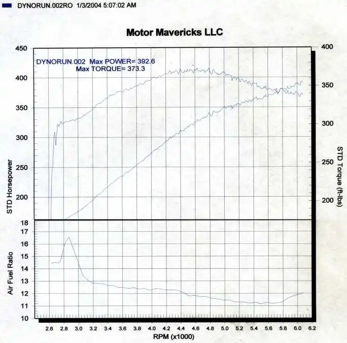

After having installed my supercharger a year ago, I finally made it to a dyno last friday!!!
I was very pleased to say the least:
393 hp 373 tq with the a/f still under 12 at redline.
Mod's are in my sig. :D :nice:
Vortech V-2 SQ, 30lb frpp injectors, 80mm steeda maf, steeda tune, steeda power pipe, steeda dual fuel pumps. Other than that it's stock, the bottom end and heads have not been touched. Stock Exhaust too, except welded in flowmasters.

VERY nice! Grats!

Carl, could you check the SAE Numbers on that.. my mods are similiar to yours, and I put down 357 HP and 360 TQ with everything stock other than the blower. Power pipe should be on this spring.
the sae correction factor was 1.03, it was terribly humid and pouring the rain. So, the uncorrected numbers doing the math (393/1.03)=382. But it's only fair to use the sae corrected numbers in my opinion, because of those variances in elevation and humidity, temp, etc. That way everyones numbers can be compared using equal variables.
