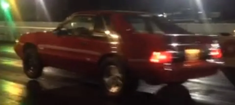

the good...
nothing broke... drove it back onto the trailer under its own power drove it into the garage again this morning under its own power
now... the bad...
i have 1 of 3 issues...
to much gear... to loose of a converter... 3rd gear slipping
im thinking its 3rd gear slipping. when i tried to use the transbrake it held for about a second and pushed forward. if i run it past somewhere between 800 and 900 feet its on the limiter. so the plan is to adjust the bands and make sure i didnt screw that up when i put the trans together. change trans fluid and see if i can tighten up the converter a bit. and lastly i need to pick up a PMS to get past the rev limiter
so the results
7.55@90 to the 1/8 on 10* of base timing which results to around 11.7@113 ish out the back. 1.62 60'
got a few tricks still up my sleeve to pick up some ET still...

after talking with bob over the weekend we have a few tricks to throw at the car for the next time i can get it out.
i still think i can get this car to go 10.90s how it sits
