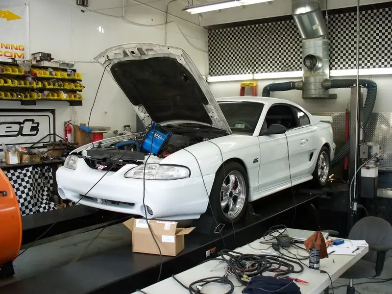

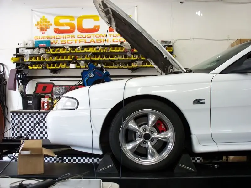

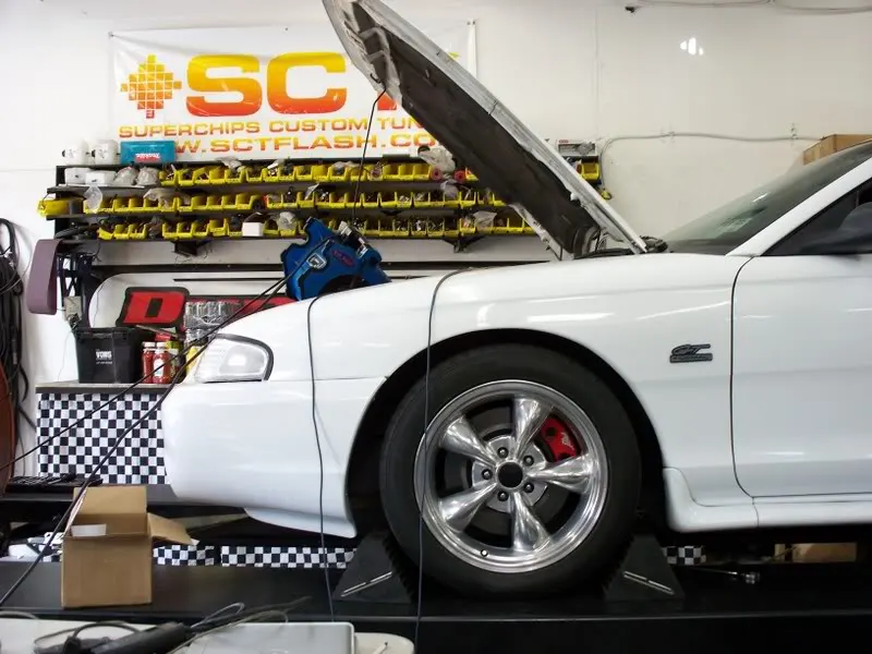

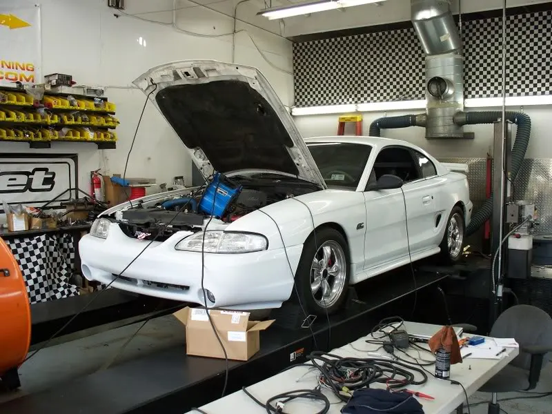

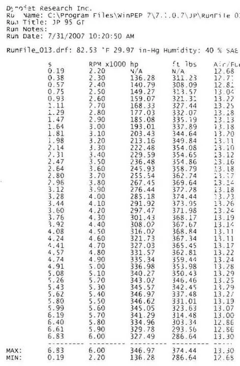

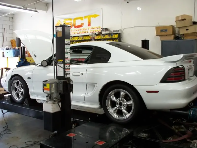

Alright well i had a great time with the guys at San Diegos local mustang shop DPR. Spent about 2.5 hours playing with it on the dyno. My old numers were with 1,000 miles on the motor and just raw guesses in the TwEECer.
OLD NUMBERS: 327rwhp and 356rwtq
My first baseline pull was with the same tune as before but with the addition of 1 3/4 Long tubes and a new DR. Gas X.
Baseline: 336rwhp 348rwtq
I was pretty happy with that gain just from the long tubes but i did lose a little tq probably to the bigger primaries
That baseline was also with the Anderson Power Pipe on and the A/F was right on. Next i swapped that out for C&L inlet tube i kept my pro-m MAF.
Numbers:330rwhp and 355rwtq
So i lost some hp but gained the same tq. BUT mainly the C&L pipe made me much richer. So i took some fuel out of it and got
Numbers: 337rwhp and 356rwtq

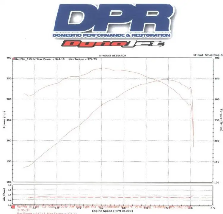

Now that i decided to keep the C&L pipe on i started to mess with timing i had it at 33 degrees in the base line and pushed it up to 34 degrees. I lost 6rwhp and 9rwtq. So next i went down to 32 degrees and my A/f went way rich but i only lose 4rwhp from the high of 337rwhp. And TQ went up to 359rwtq! So now i just had to lean it back out and would be in the money!
I got the A/F back into the 12.8-13.0 range and got these numbers!

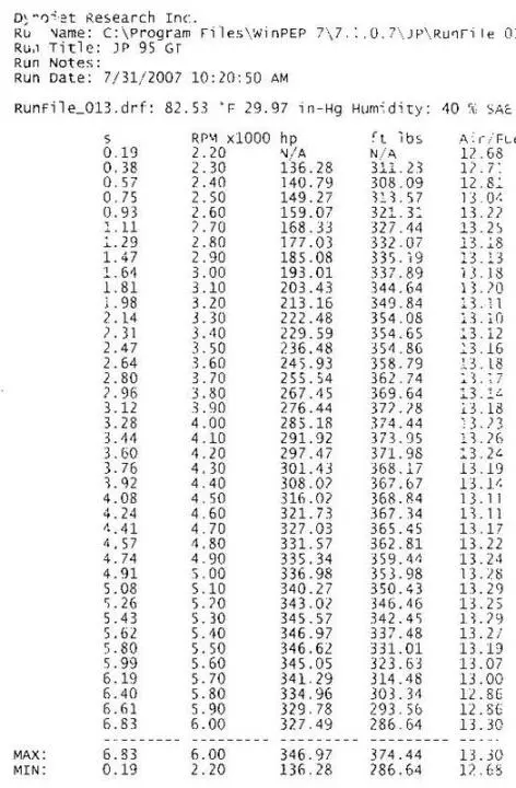

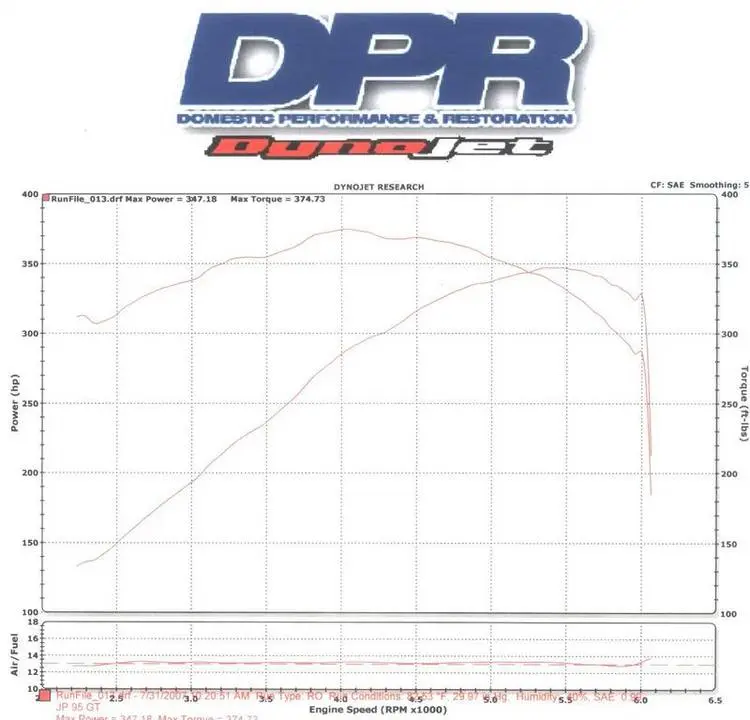

Numbers: 342rwhp and 368rwtq
I liked that and called it quits for tuning but we let it cool for about 20 mins and did another pull. I was rewarded with
Numbers: 347.18rwhp and 374.73rwtq!
Congrats on the new numbers! At what RPM did the peaks occur at now and before the long tubes?
Good question i have the old numbers at home i can check later on this dyno run i peaked at 5,500rpm. I went straight from the shop to work so i dont have it on me. Also when i get home ill put up the dyno sheet, and some pics, and i have a video of the last run.
I am surprised the C&L inlet pipe gained over the AFM power pipe. I know the main difference was in torque but I thought it would be down on upper rpm power but it actually done better.I am surprised! Nice numbers man!:lol:

Pics and Vids

I have spent most of my time researching 302-306 cubic inch combos.
When it comes to 347's ... I don't have much data so they always are
fun to look at :)
I'd not have thought you could reach the 1rwhp per 1ci benchmark
with the smaller size heads you are using.
With nothing more than small changes (fine tuning) in spark & fuel
you picked up 5rwhp & 12rwtq :nice:
Lets talk about the cool down situation :D
The cool down gave you an additional 5rwhp & 7rwtq which is nice :nice:
