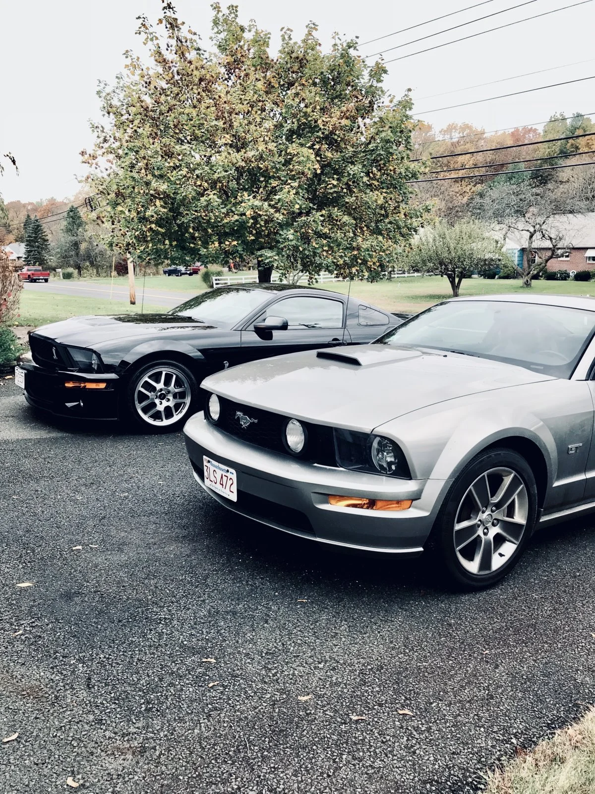

IMRC’s, I’d removed mine. But Glad to hear that helped, Rob! Love 05’-09’ ‘Stangs- (well, love most ALL ‘Stangs)..Meet my 08’s, GT, Shelby GT500..Clutches were nice enough to need replacing within 2 weeks of each other, lol!
Most recently the GT500, Twin Disc 1,000HP McLeod, there, & a McLeod Street extreme (500-600HP) in my Wife’s GT.(IT’S Broken in). Smooth as glass, zero chatter, noise, pedal effort- identical!!
Mentioned Pony’s are Sassy, think they communicate if 2 Pony’s are grazing too close! Too smart for their own good!

lol..ive only had her 3 weeks...the only thing i have done is to fit a cold air intake kit which a lot of people say trigger the fault codes????..and to be over here in the uk john you cannot give it beans all the time cos theres so many bloody cameras and police...must say,that black stang looks awesome..nice one..oh yeah..i have noticed whoever had the car before me has changed all the coils as well to Streetfire ones...so far so good....Rob
