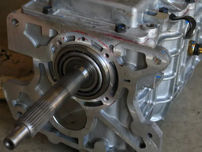

ook under car when i saw oil dripping from tranny between bellhousing and front off tranny

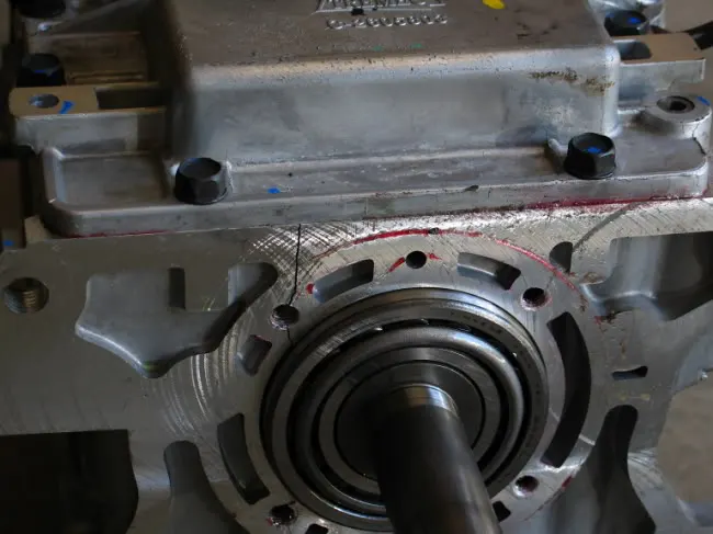

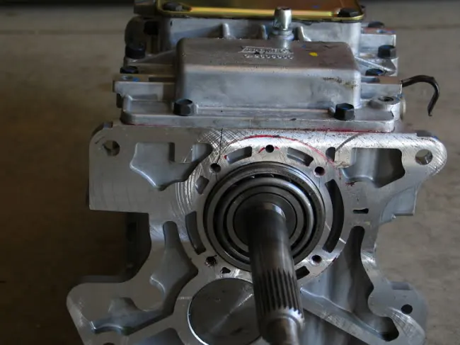

I tought it maybe front coveron top of tranny,so wee pulled tranny out ,
Nope it wasnt copver that was leeking , it was leeking under bearing retainer, wee look at little bit closer at bearing retainer when i spot little crack ,not long ,just small that runs under bearing retainer, so wee pulled bearing retainer and BAM ,that lille crack was looong ,all way down
In about 15 min i lost 2 qt of fluid and tranny was almost empty
So i called ProMotion same day and told they whats going on,they told me i have to call UPS and fill claim with them wich i did,
A few days after UPS truck came at my house to pick up tranny and to shipped back to ProMotion in FL,then i had to make about 500 calls to who knows what UPS#
So how it get broken it was droped atend and all that weight was transfeted to rear ,and it was cracked just when wee bolt it on bellhousing crack expand

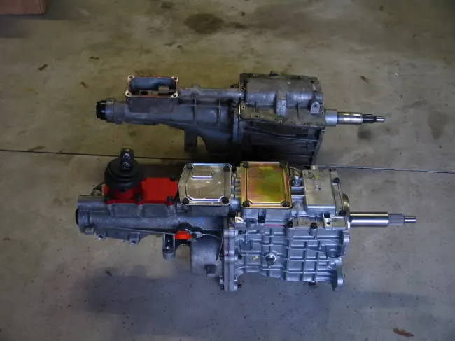

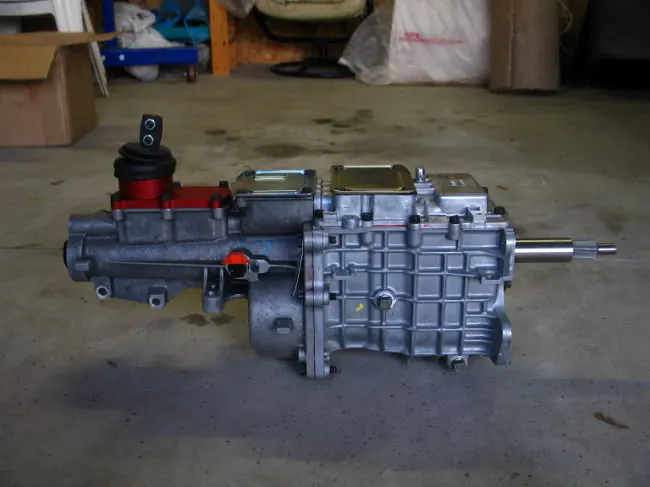

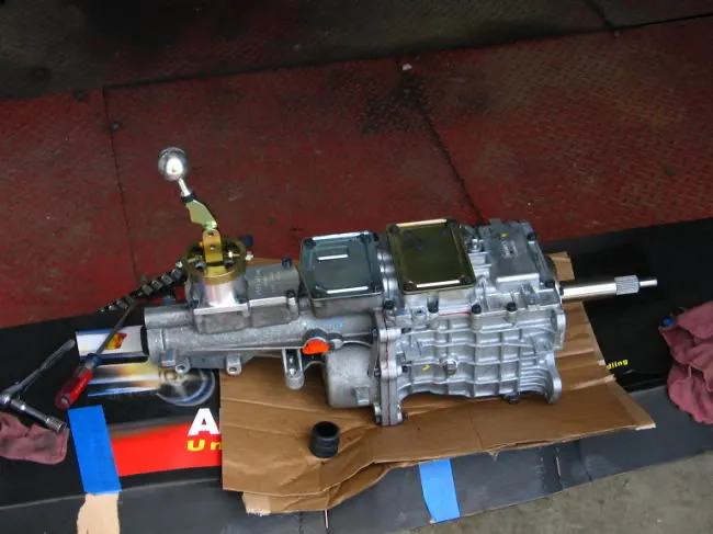

Here is some pics i took it
