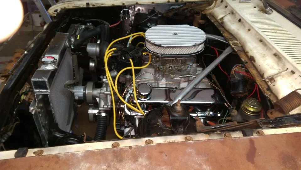

I have the standard 91 balanced flywheel to the 302, but I'm using the 65 bell housing and 65 3 speed standard. Was just wondering if I could even use that set up and what starter to use.
