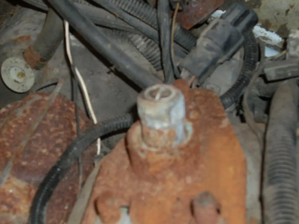

well here is a slew of questions for you guys, if you can help please do, i was looking for the eec test conector in my stang and there dosn't seem to be one, i have had a few fords and have a auto x ray scanner, but for the life of me cannot find it, second what color are the stock injectors? and i will have to get pics for this one, but the front struts have these big nuts on them with a flat head screw driver thing that looks to be a adjuster, the struts are yellow and have a blue lable of some sort, cannot make it out. there is also this read bar that goes from one side to the other, behind about 2 feet behind the stabalizer. there also what looks to me is a under drive pully on the crank only, it is a really dark purple like color, i think i will have to get pics of this stuff if anyone wants them, i have been planning on throwing some cash at this car, but if there has been other stuff done, kinda be a waste.
Yes that means there adjustable and the yellow/blue scheme makes me want to say Bilsteins

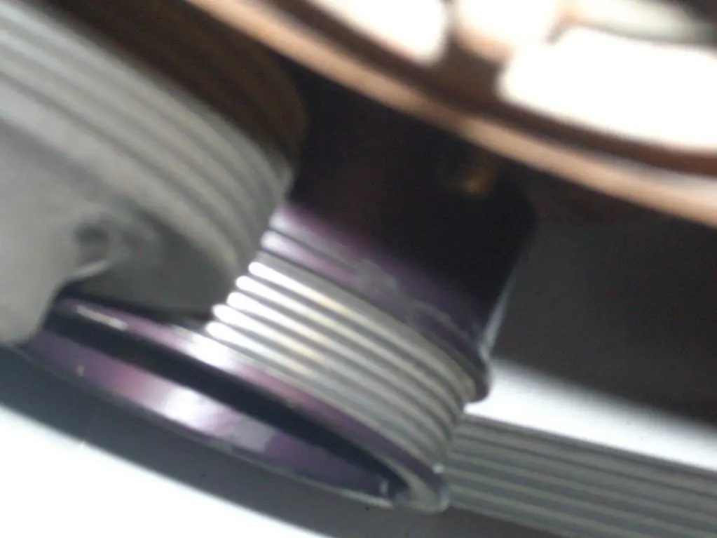

You should take pics of these for other people to help you ID

does anyone know the stock diameter of the crank pully?

The stock crank pulley is about 6".

thanks marylandstang, here's a bit of a stupid one, do you mean on the front were the accessories mount or in front under the valver covers, i know it sounds like a stupid question, i'll go out and look on my hunch and see what i can figure out. gotta get some pics of that crank pully. thanks again.

some pics of the stuff....
ok here are the pics of the strut tower and pully, i know little surface rust, but she has been sitting in a garage for close to 5 years. i'll clean her up... anyhow let see if i can attach photos... rust looks 10x worse in pics, holy crap..

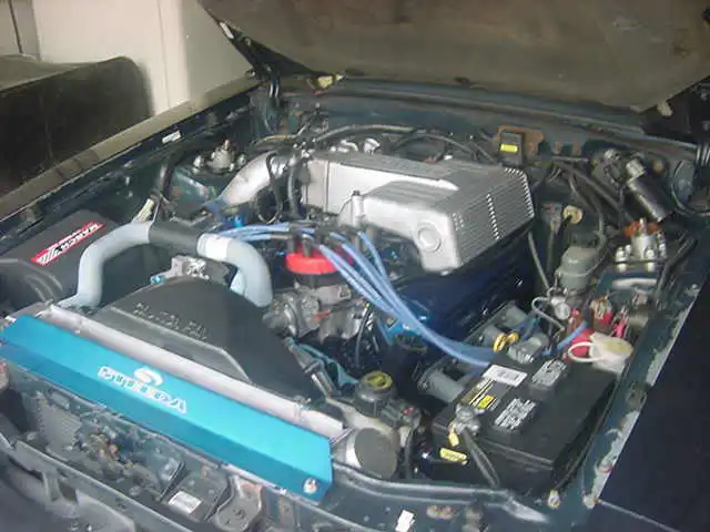

On the front of the head where the accessories mount. They'll be plainly visable.
You can see them in this pic. Just look at the front of the head and you'll see the 4 bars.
