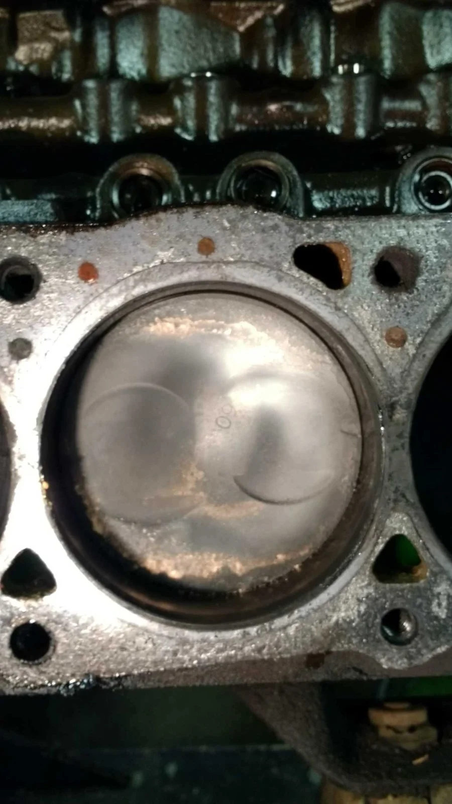

Recently had it rebuild, and the shop put a head gasket on backwards. It runs and drives, but gets hot. It has not blown the head gasket, and it has not been driven much, like 50 miles, since the rebuild. I thought it was just running warm cause it always did and tried to upgrade the cooling finally. Didn't help and thought I was stuck, but noticed the tab of the gasket sticking out the wrong side. Shop is about 2300 miles away so they are no help. Literally put me on hold whenever I call. Most papers got lost in the move so I don't know exactly what gasket they used.
Just need a quick suggestion for what head gasket to replace it with.Can I use a 4.100" gasket? Or does it have to be exactly 4.060"? Recommended brands? Material?

You can see the little tab of the head gasket, i believe it was the front left or right? It's been a while. Anyway, it shows on one side but not the other.

Either way....if the headgasket are indeed backwards they can cause over heating by blocking the coolant crossover points at the front. Depending on the gasket used. A bunch if gaskets are cut out in the front and rear even though the intake blocks the ports in the rear. The heads in a ford can be put on either side. So the gasket will face one way on the left and opposite on the right....but they usually have either " front" stamped on them or " head side " stamped.

The pistons are stamped .60 over and it was measured when it was torn down. I was shocked lol.
