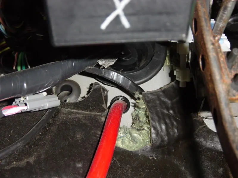

Go through the steering shaft boot.
I've seen a few people do that and I wouldn't recommend it. I drilled two holes just below the main wire harness that runs through the firewall. One of them is for my 2 awg power cable, and a smaller one for my alarm wires. Here is a pic from the inside...
