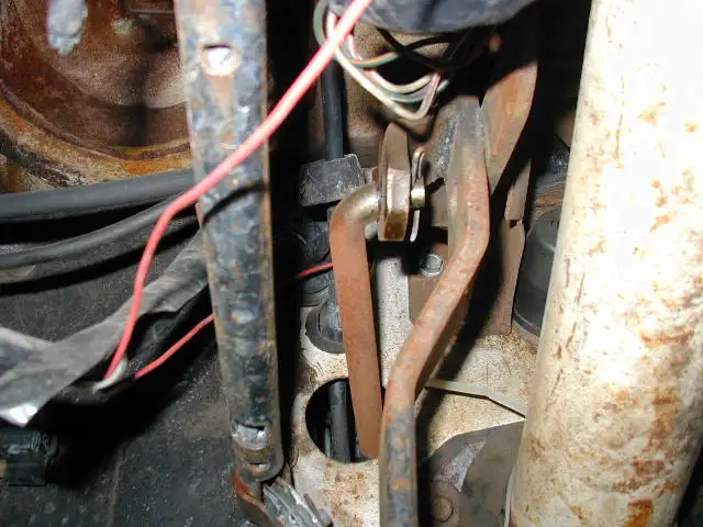

Anybody have any pictures of where the toploader linkage exits the firewall and maybe even where it hooks up to the pedal on any 67-70 mustang. I need to know for my hydraulic setup I haven't been able to find any.

There should be a plugged hole on the firewall you can punch out to feed the clutch rod through. I can't snap a pic because the rod is hidden behind a bunch of stuff.
Are you making this yourself or did you buy a hydraulic kit with no instructions?

Do you haev the clutch pedal in? It should be in line with the pushrod hole.

On the "ear" that sticks out the side of the pedal. I have to run but I'll post a pic in a bit.
edit - I took the pic with my old camera thinking it's be "faster" but I can't find the card reader. Basically it's in line with the ear of the clutch pedal, on the bottom hole. It is to the upper-left of the steering column. I think that's the speedo cable immediately above the hole.

Hmmm still having trouble finding it. The biggest problem is I don't really know what I am looking for. I have taken this whole car apart and swapping out the pedals and locating this dang thing have been the most tiresome by far.

Does this help?

Yeah thanks I appreciate it. I have been looking in that same spot and can't really see it. I will keep looking. Thanks Ron for taking that pic for me.
