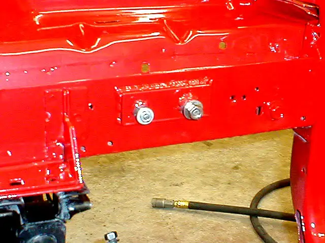

You asked for ideas so here's mine. On my avatar '89 I made the entire frame a ground plane. I welded a solid bar w/two 3/8" studs to the frame and ran the Neg batt cable to one then ran a 4ga cable from the block to the other stud. Welded a plate with studs to the other frame rail also and ran another 4ga cable from that side of the block to the studs. Any other factory grounds on the car were all run to a ground bar which was grounded to the frame stud. I've done this on every car I've ever built and have never had a ground issue.

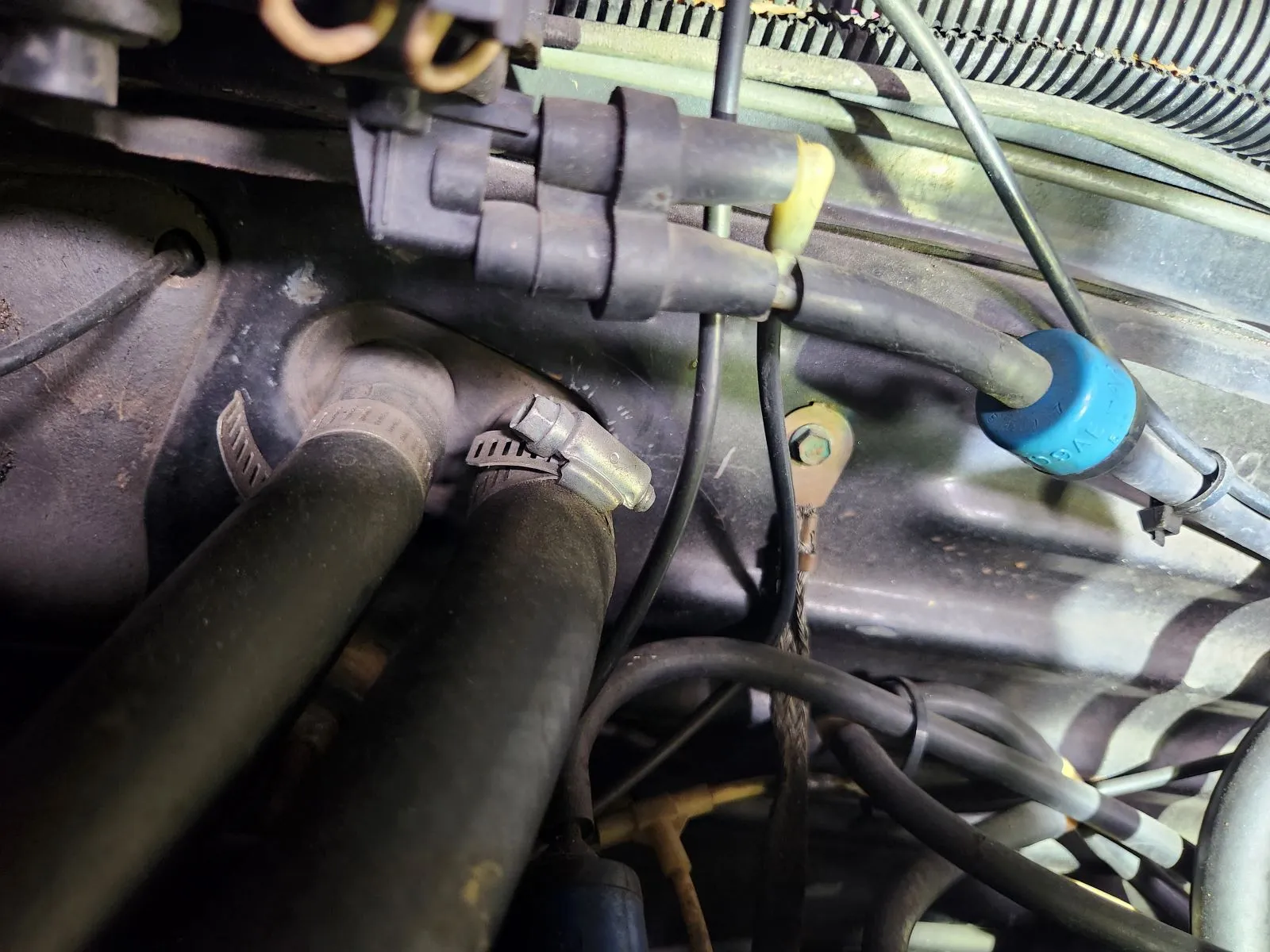

The stock engine ground wire on my 85 attaches to the firewall about 1-1/4" (towards the driver's side of the car) from the 3/4" heater core hose, at the same height as the heater hoses.
I can get a pic if you need one.
