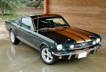

Except for the fog lights, which I took off, it looks like this. I don't have engine pics.
