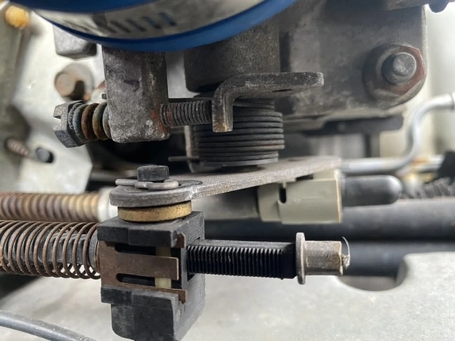

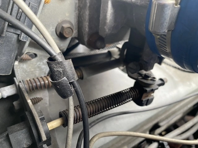

For #2... Do me a favor. Pull off the section of BBK tube between the MAF meter and throttle body and take a picture of the throttle bracket under the throttle body where the throttle cable and TV cable (kickdown cable) are connected. One common problem is the plastic mount for the TV cable breaks causing cable to not perform correctly. Misadjusted cable can cause soft shifts and is not good for long term trans health.

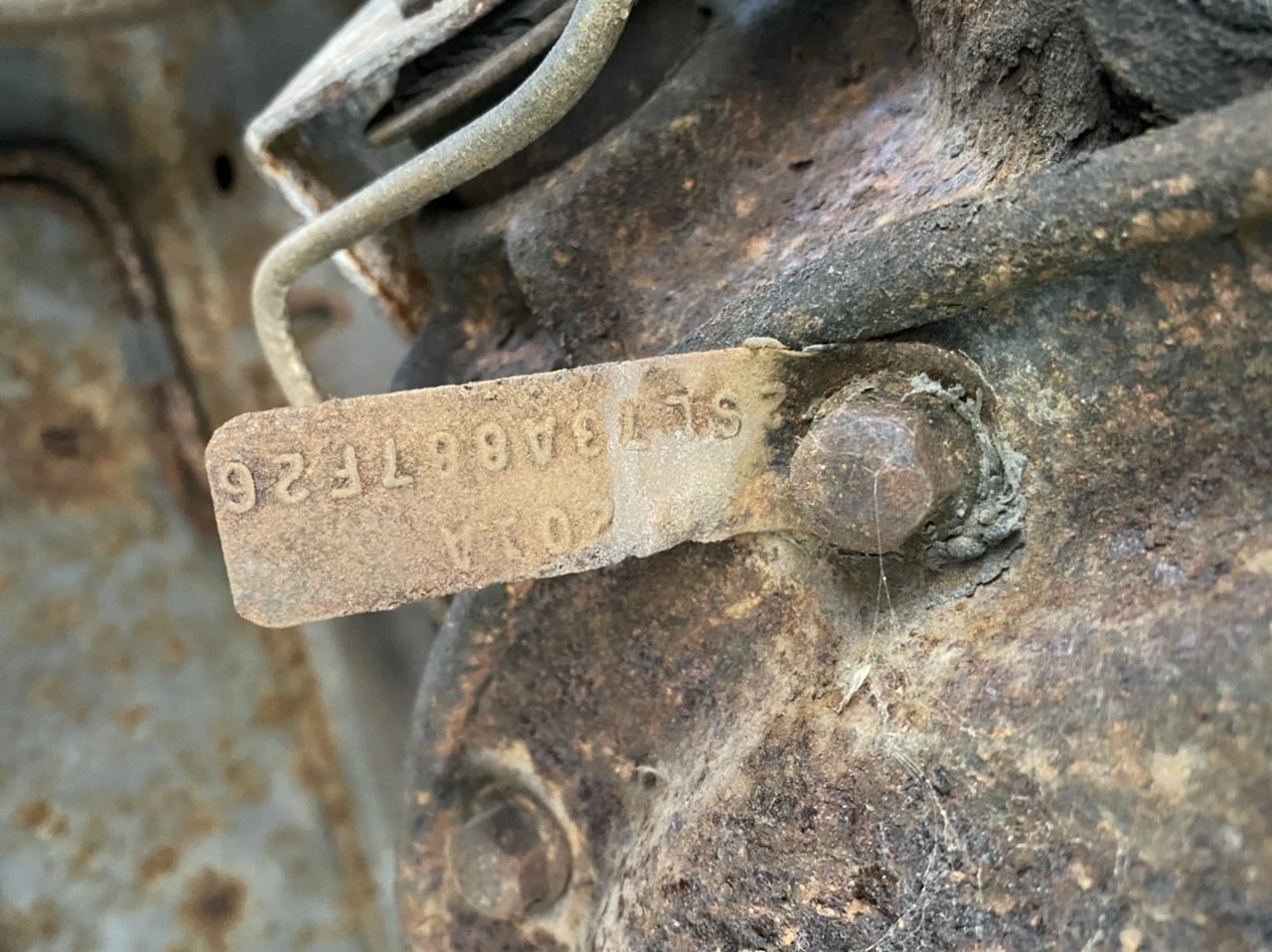

If there is a tag on the rear axle still, it will list the stock ratio as well (attached to diff. cover bolt). But these usually get tossed the first time the rear is opened up.

Not sure how to read the axle tag at the mkment and trying to beat the rain but jacked up the shaft turns roughly 3 3/4 times per 1 rotation of the wheel.
Also snagged a couple pics if the TV adjustment cables
