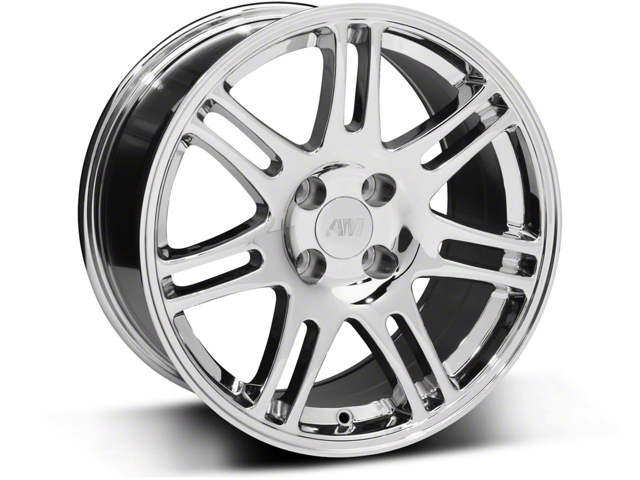

3. Many of us still run a 4-lug, nice wheels can be found.
BTW, FRPP aluminum drive shaft is $350. You can get four 4-lug wheels for that. If you hurry, they are still on sale, $93.99/ea. + lug nuts.

Not much you can really do to the 4lug setup. Rear disk, upgraded pads, new fluid. I believe max motorsports sells a kit for 4-lug brake upgrades, but at the end of the day you can put that towards a 5-lug cobra setup.
SN95 17x8 rims can be had for $200/set without tires these days. You can probably get a used set for $400 with tires.

If you're going to go with 4 lug disks in the rear it's not worth the trouble versus just going the full conversion. Plus you can go up in wheels to a much better selection of 5 lug wheels. It's well worth it in my opinion. It gives you so much more confidence and puts you on par with modern cars in the area of braking.
