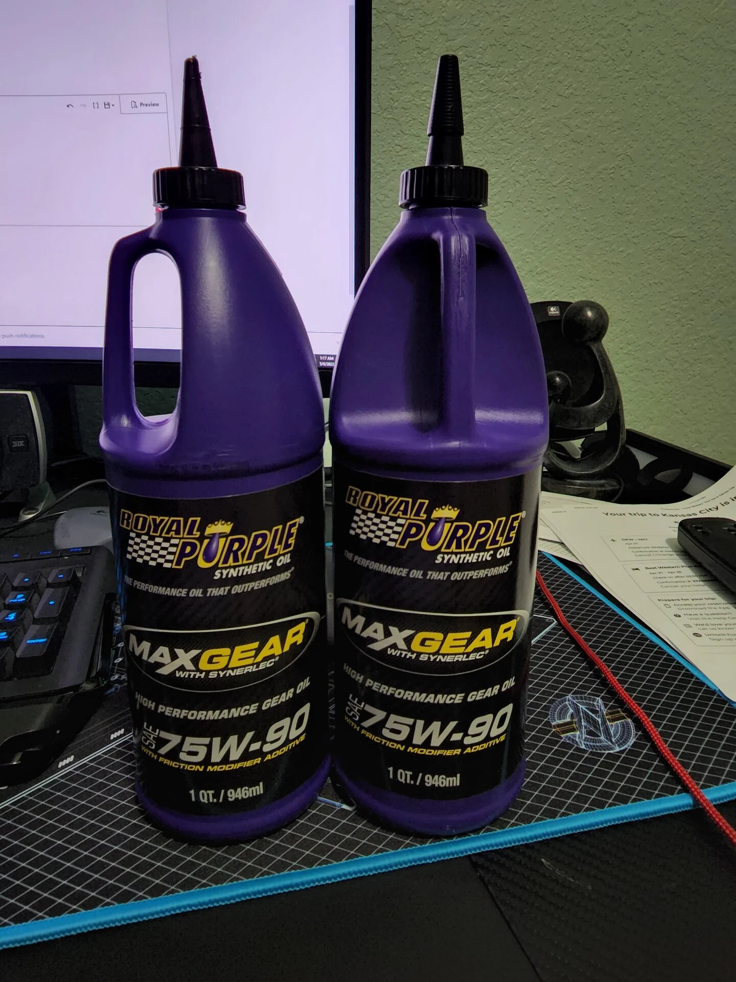

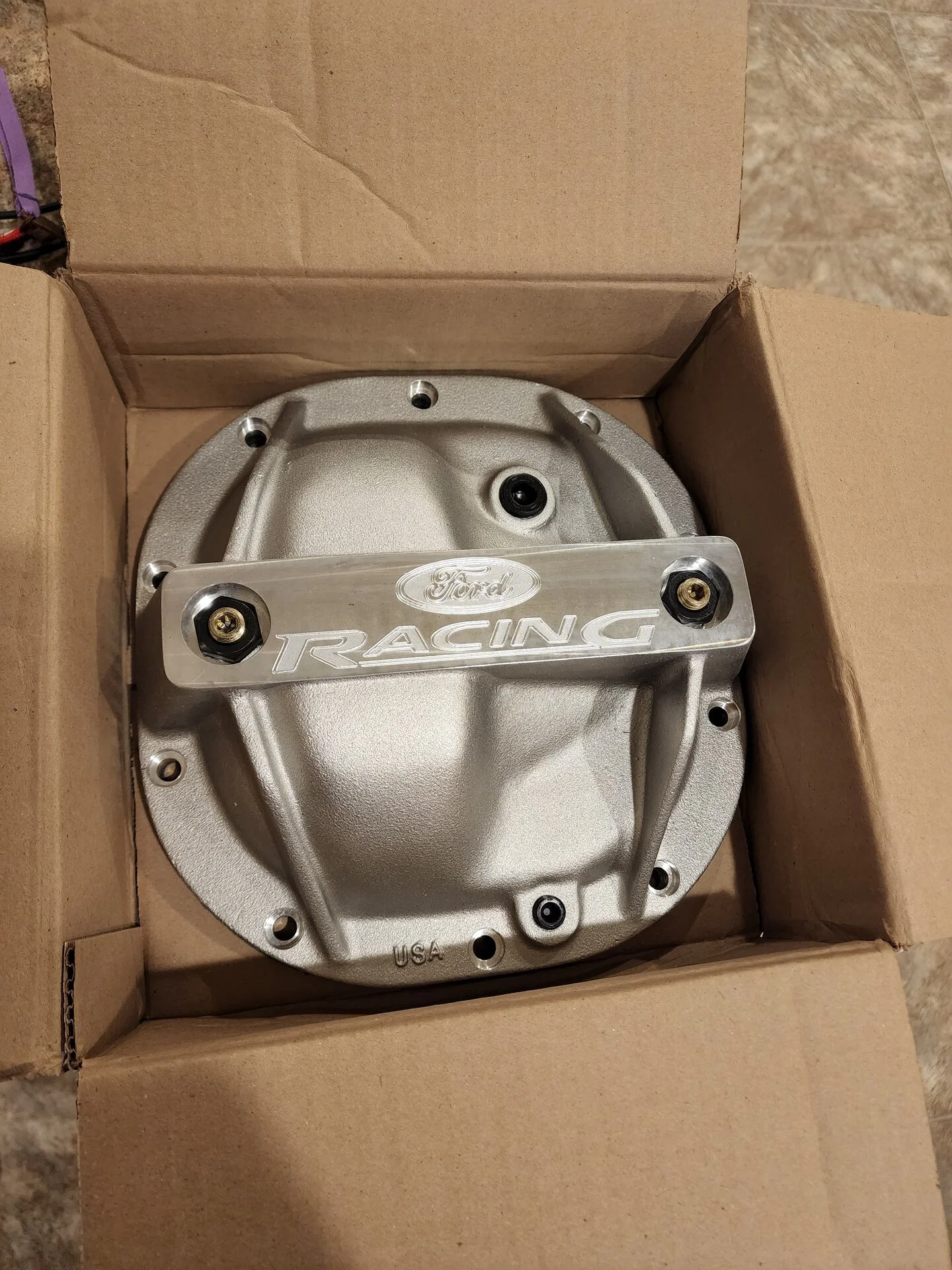

Going to replace the rear diff cover in my 8.8" diff. Is Royal Purple 75W-90 with friction modifier a good choice? I also purchased a lube locker gasket for the job.

Thatll all work fine , just use the factory fill port to determine if it’s full - not the one on the cover . Otherwise it will be overfilled

I was going to install a newer rear cover ( two of them on my 4 wheel drive) with drain plugs to facilitate draining them....
Watched some videos about how they can affect the " flinging" of the lube in a bad way for lubricating the gears.....

Not sure how a rear cover, especially on a 8.8" rear, could possibly cause any problems with lubing the rear gears.
Thousands of them have been installed and nobody is having premature gear failure from using one.
Now maybe on a 4x4 differential, where the housing/cover is much larger could potentially have an issue. Maybe, if overfilled. And even then, would have to be towing or heavy loads or something. Running empty I doubt there is enough heat/load to cause any damage.
I would recommend watching the videos...
TA rear cover on my Coupe for 20 years and zero issues. Also have one on the T-Bird for about the same amount of time and zero issues. I understand what the guy is talking about but he is specifically talking about the flat back covers which does not apply to any (that I know of) of the 8.8 covers. The flat back covers are on the large pickups and the put them on in hopes the cooling fins will reduce the oil temps.
Truck diffs, much larger. More room for error.
8.8 Ford is a different animal.
For one, the cover is basically identical to the stock one, other than being aluminum instead of stamped steel. The inside dimensions is pretty much the same. Not a concern at all.
You would probably be surprised that I only run 1 qrt of gear lube in the 8.8 in my Racecar that makes over 1,250HP. After 2 seasons, the ring and pinion still like like new. Bearings, like new. And...it has a Aluminum rear cover just like the OP.

Some of them say they already have it in there like Amsoil. If you go back with a conventional oil then you definitely should use some additive.
If you run a synthetic that’s says it has it then put about 4 oz less than full into the diff and drive it around in a parking lot doing figure 8’s. If it makes noise then add it. If not you are good to go.
The more additive you put in the more the clutches will slip so keep that in mind.
Some folks add an extra clutch (I did) and even move up to the F150 “Z” spring (I did) and that really makes the clutches grip.
Reactions: Scrapla347
