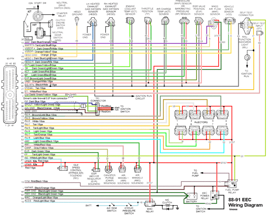

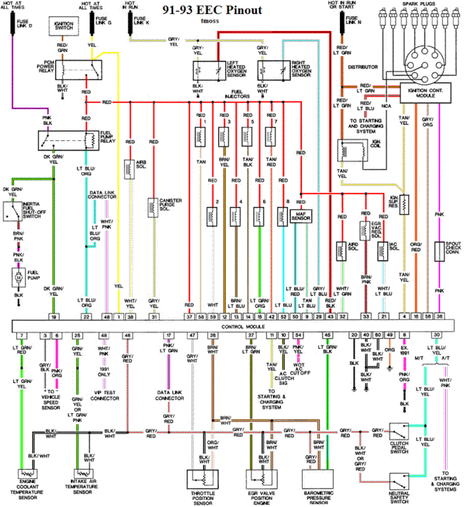

tonight im going to try to trace fuse able links. i think the one i need to be concerned with is on the driver side by the starter solenoid. I found 2 diagrams from t-moss.. It seems like in 1991 there were 2 different engine harnesses???!?!?!?!
88-91
91-93
WHAT THE HELL! :mad:
WTF does all that stuff mean??? lol...I've never been able to understand stuff like that.

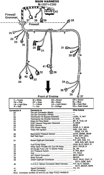

Oh, and here's a simplified diagram of the engine harness where the fp relay should be..
That relay does not exist on my engine harness. only the WOT relay. Which means there should be one under the seat, i did not see it unless its hidden under the carpet. My car was unmolested when i got it, so i can be almost positive that the driver seat has never been removed. That leads me to believe that my car is either different the most 91's or the friggen title has a misprint on the year and its really a 1990 :shrug:

Ford moved the FP relay under the hood an 92-93. I think i may need a harness from a newer car although im not sure.

How many connectors do you have on the driver side shock tower that connect the dash harness to the computer harness? You could have one or two plugs. Also, you might want to look into the horn issue first. You might have a wire that is grounded. Also, there is a difference in the dash harness between the 4cyl. and V8 harness. Been there done that. As most have said about the relay under the seat, it's not that somone has messed with it. It's the fact that the 4cyl. cars went with the FP relay in the ccrm and not under the seat. That does not mean the wiring/connector for the FP relay is not there. You need to verify that. Also, when you look under the seat don't confuse the connector for power lumbar with the relay connector.
As you've seen, since you removed the I4 harness, you need to find the FP relay pigtail from your donor harness or create/splice together a pigtail for the FP relay.
