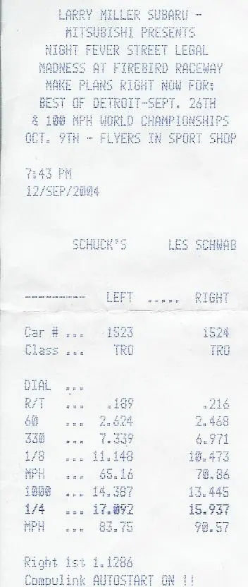

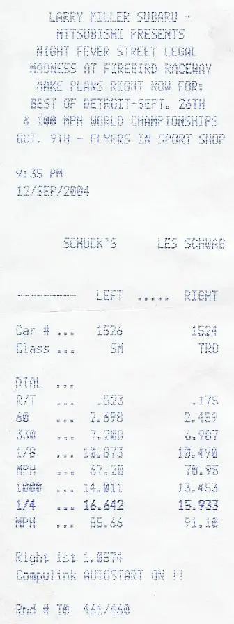

Hey guys thanks for the help. However my car did alot worse than I hoped for. I did three runs my best being 15.9 @ 91 mph. I seem to lose alot of power in the top end. Also the track is at about 4000ft and it was around 80-90 degrees out there. I had little or no tire spin. Launched at about 1500rpms.
Any advice on how to improve would be great. I have to get some better gears. Also I was thinking about getting underdrive pullies and a shift kit. Any other bolt on you guys would suggest. I want to get in the 14's and over 100 mph by next spring. Thanks
PS I attached my two best time slips.

The best bang for the buck is a quality torque converter,with traction it will cut off 5-7 tenths :nice: Get a good catback,and look into a 65mm throttle body,and look for a cold air intake!! Yes,get gears,373's are perfect for an aode.

Ran the numbers I did when I was stock. :nice:

Dont waste your time/money on a throttle body right now. Get the torque converter, gears, shift kit, trans cooler, catback and off road pipe, and a cold air intake. I say 4.10's for an auto....that is usually the most popular ran with autos
