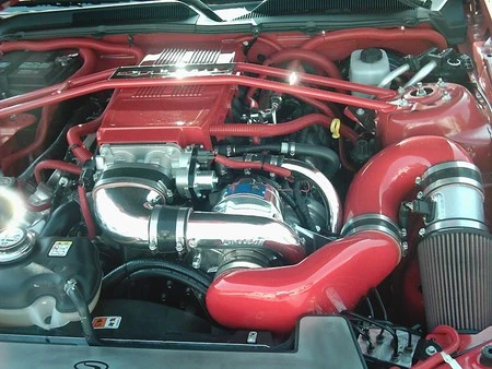

you mean like this...It works but the brace does make contact with the cover and presses on it some.just keep that in mind, but it looks great :nice:
I have the cover with the BMR brace and it is a very tight fit. I put washers under the brace which helped a little. So far I haven't had a problem, my guess is because of the floating motor mounts. Once I switch to the Steeda motor mounts I think it will be an issue and I'll have to come up with another plan.
