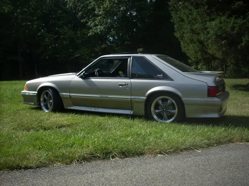

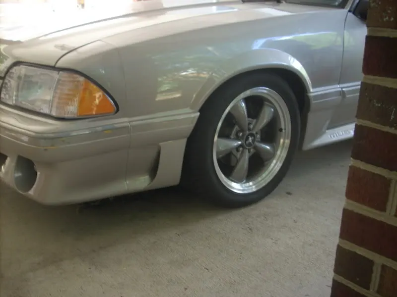

Hmmm, I have bullits on my car. The fronts are different than the rears. The fronts are more of a darker grey while the rears look more like aluminum. Also the center section where the lugs are are slightly different.. The rears, the lug nuts are like in the wheel. While the fronts look like the ones pictured, and the lug are is receded from the spokes.. If I were to post some pictures, anyway you may be able to identify what I got? I would like to get two fronts that match the rears as I like the aluminum look better than the dark grey..
you have 01-02 bullitts (the lighter ones) and 03-04 bullitts (darker ones) i didnt notice there was a difference either until i bought 2 of them and they were different.

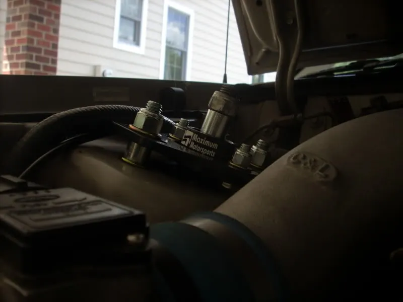

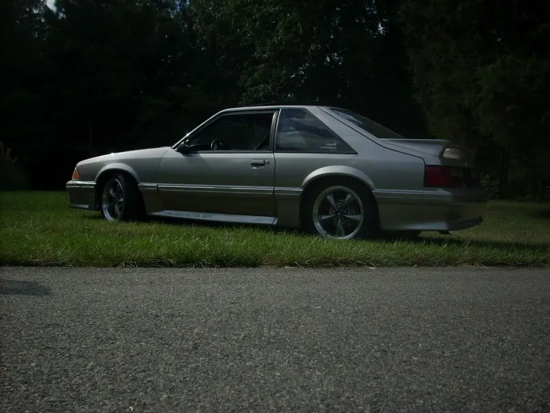

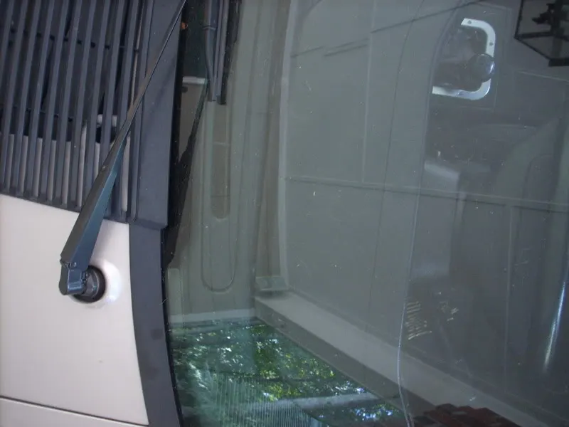

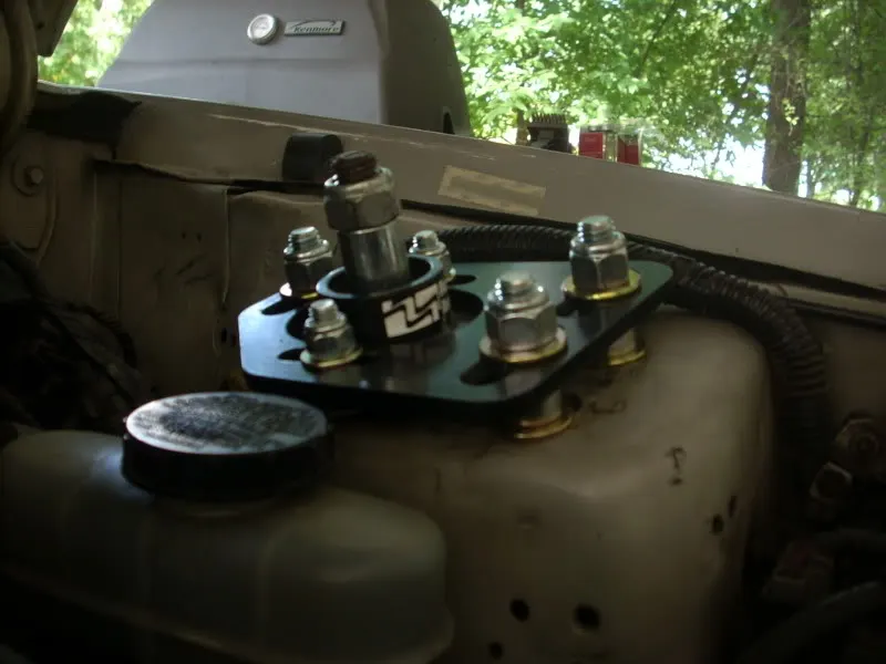

just finished installin the max. mot. caster camber plates and got the springs clocked right, now the driver sides only about a quarter inch lower, andi dont know what the tire psi is (measured from ground up). hopin i did it right. the dash i fixed with superglue and some plastic i cut and used the u bolts. holds good. now i just need an alignment and to get some tires transferred around.
dash fits good:

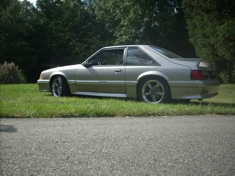

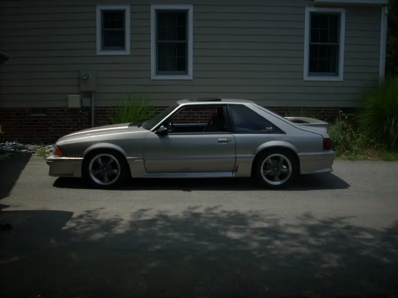

found the one thing thats gonna really bug me about my car:
http://forums.stangnet.com/790218-any-way-adjust-rear-ride-height-per-side.html
the back passenger side sits a whole inch higher than the back driver side and ive clocked the passenger spring each way allot and it doesent change. i guess im gonna swap the springs.

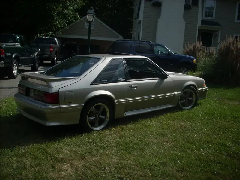

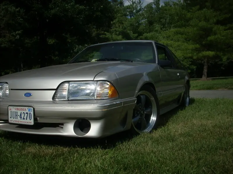

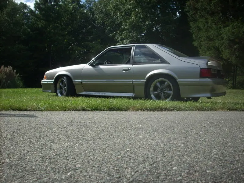

5 lugs done. still need to grease some stuff up and bleed the brakes some more. but it passed inspection. dude said i needed a right front tie rod, so im probably gonna get both front ones made by moog and have my shop do them when i take it to be aligned monday. still need to get it sitting right, still high in the back right.
concrete shot:
yumm:
and my wacky ride height:
pics are c springs with no iso's in the rear and the original ones in the front.
next week im getting it tinted (legal for va, 50 sides, and 35 on the back 3, nothing on the winshield and doing like 5 on the sunroof) aligned and new tie rods, and going around to some body shops to see about getting the front end stuff fixed. comments welcome.
