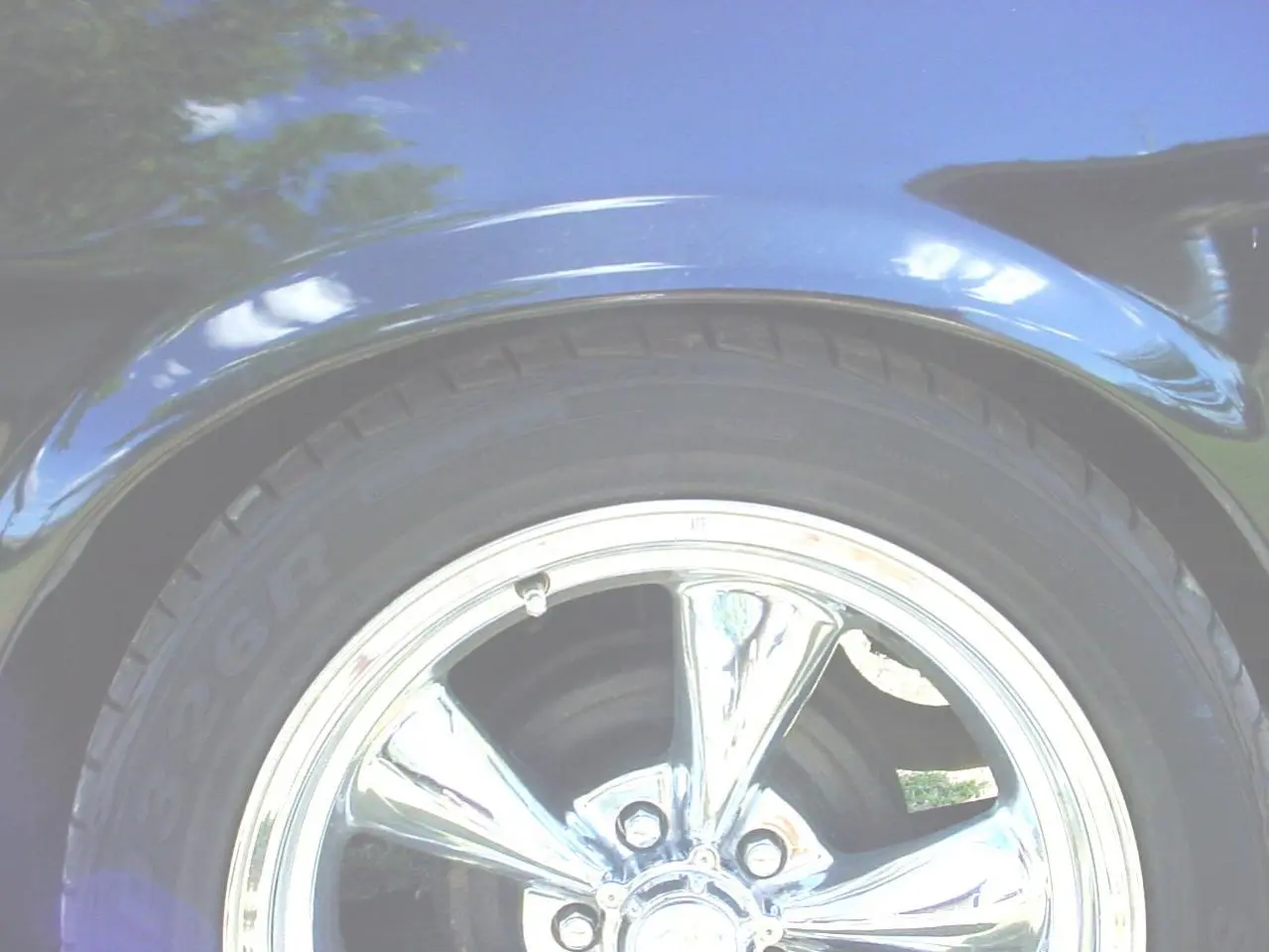

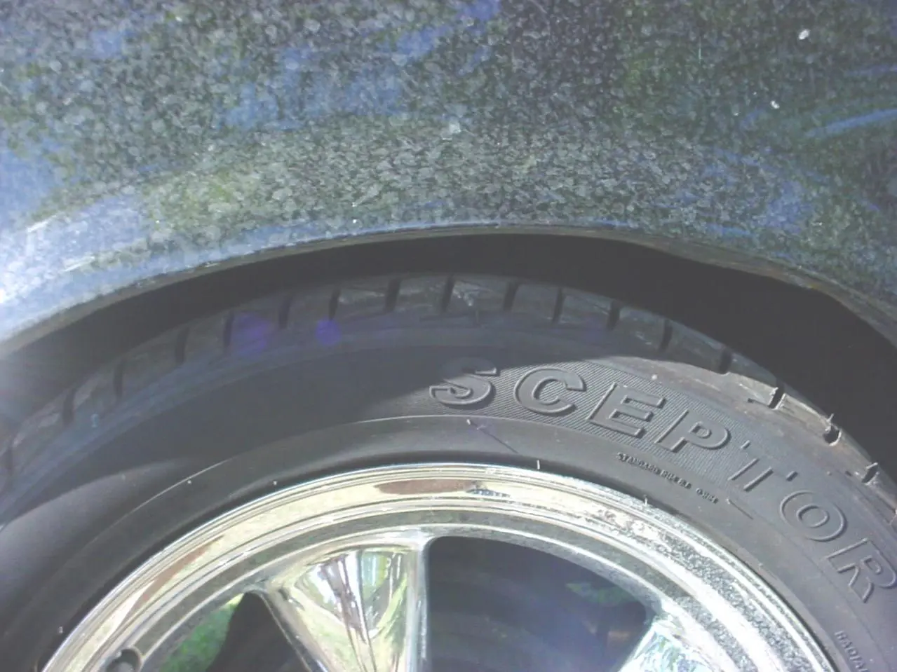

My next step is to change shackles so i can raise the rear 1 more inch. In think that will take care of 98% of the problem Here are some pics after springs, really no change in looks.

your springs are sagging. Replace with a 5 leaf mid eye and it will sit level. My car sits lower then yours so i went with shockwave's in the rear lift/stiffen the rear.Might not completely fix the issue because the backspace being 1/4" less but it will give a little more clearance.
oh, i just saw you had 235's. they should fit fine unless your springs are that weak and the suspension sompresses that much.I had 275 and now 26X11.50X17's

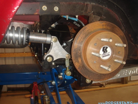

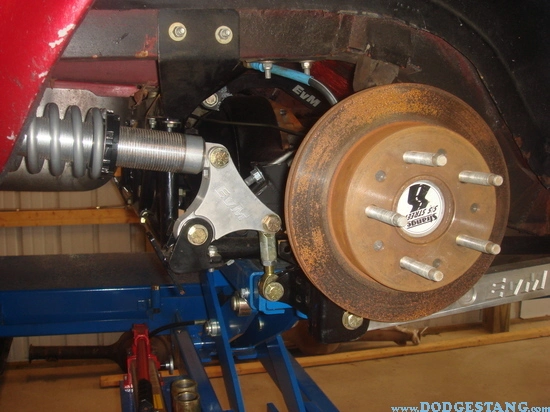

Here is a good link that shows what my rotors look like
2008 Ford Mustang - Centric Parts 120.61087 Rear Premium Brake Rotor
My only options to remove the spacers would be grind my wheels\calipers or switch to a different style rear rotor caliper combo.
