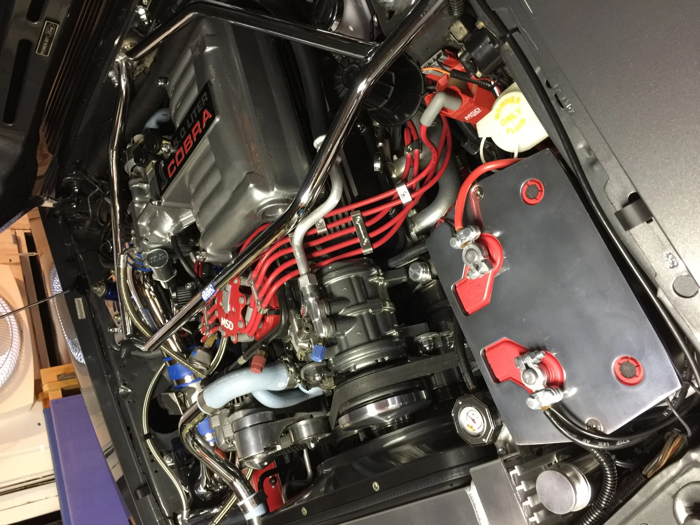

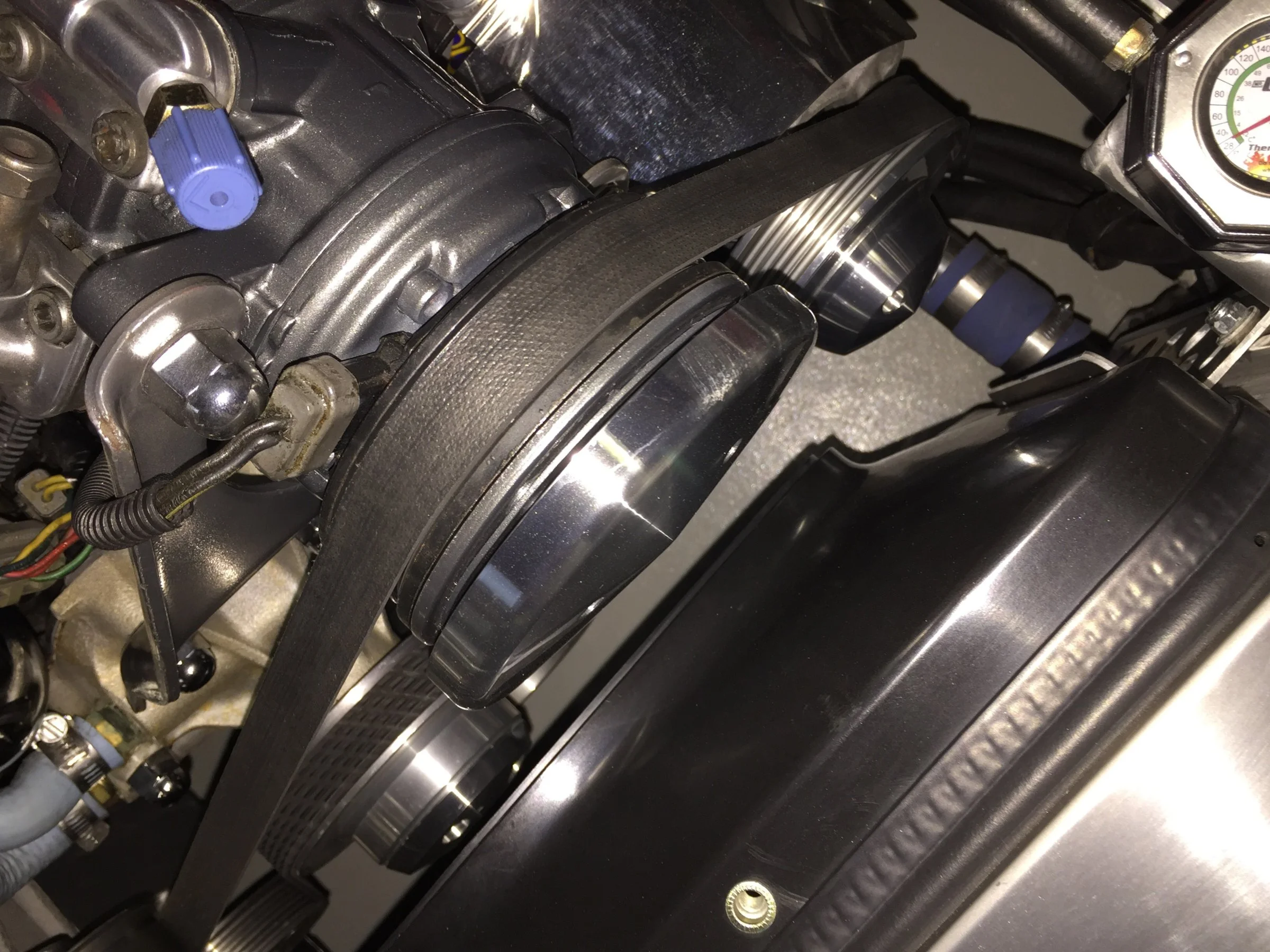

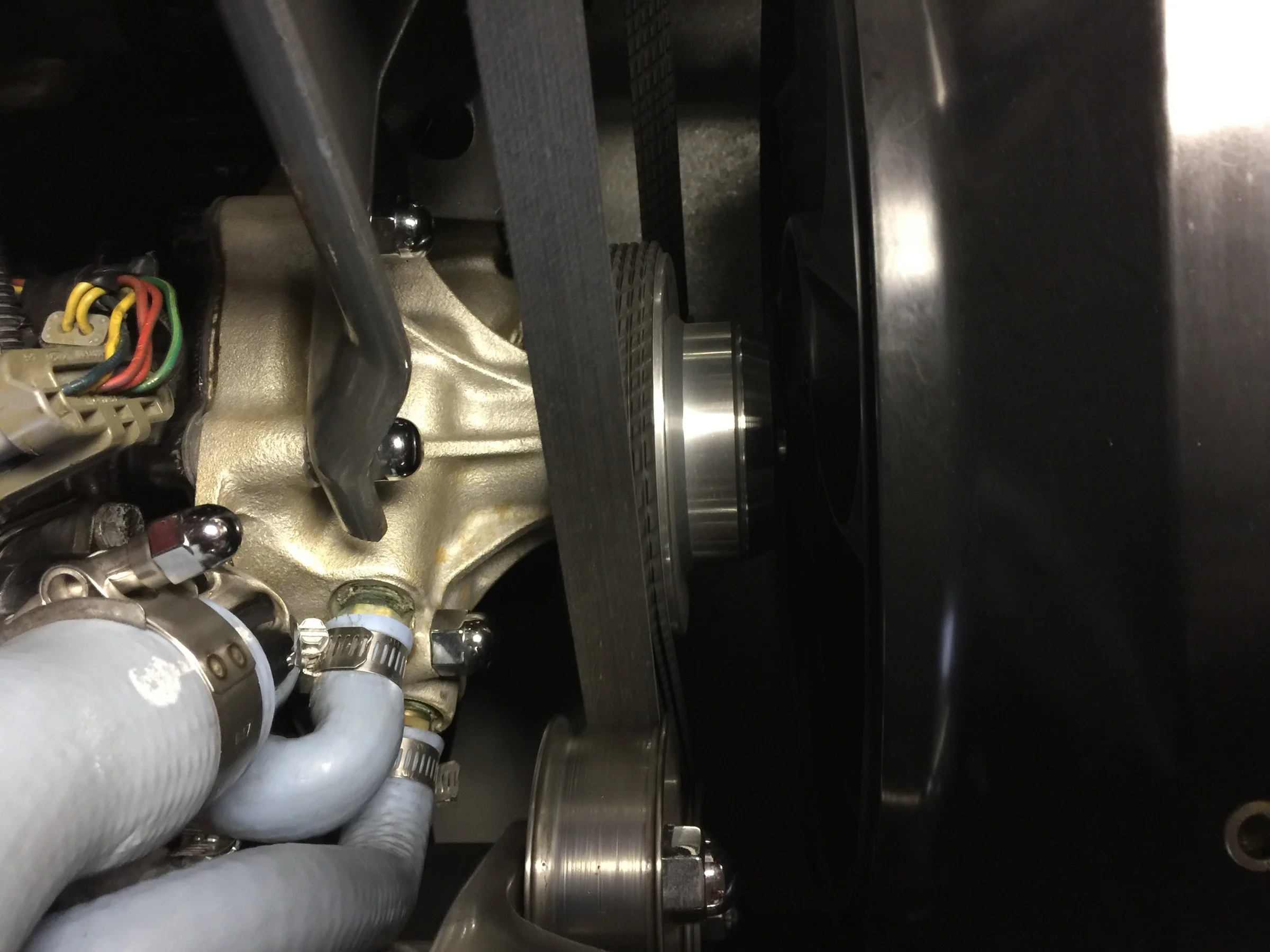

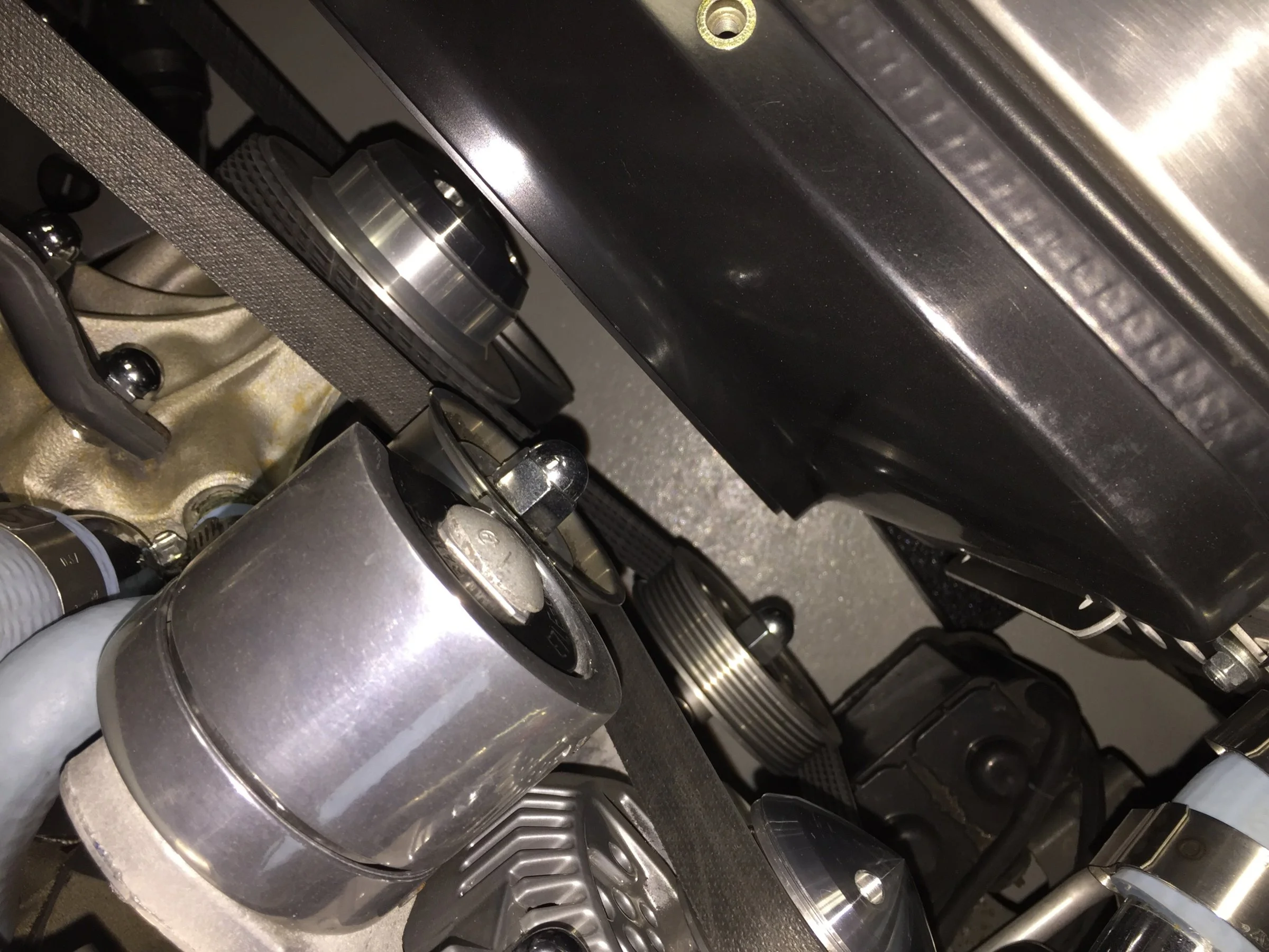

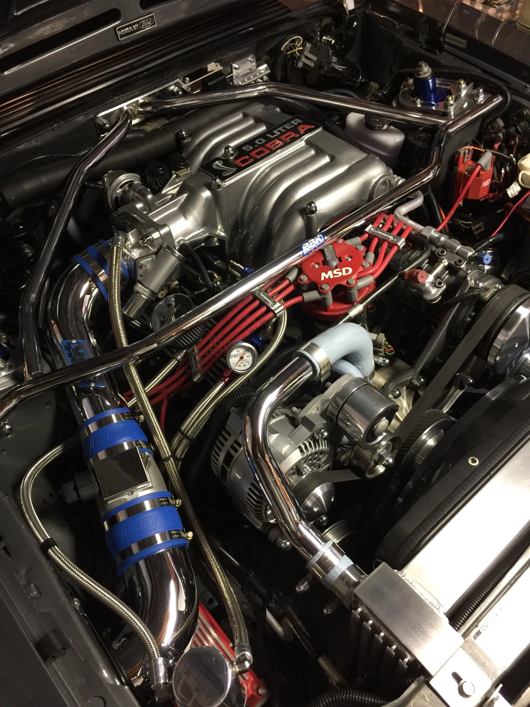

Removing the water pump nose cover is no problem at all. The question is, do you think that the radiator/fan combo could pose a clearance problem with a supercharger and the pulleys required to run it. I was hoping somebody had this unit in their fox and could say they were running a supercharger. Then I would know I’d be ok. I’m definitely not gonna scrap it. It was way too expensive to do that, plus, it works better than any other radiator/fan combo I’ve seen.
You'd really need to look up the pulley req'd for the kit you want to run and measure it against what you have. Since the supercharger has a dedicated belt the pulley will stick out further. Also, depending on goals, if a 6 rib does fit hopefully it's enough belt. Many go to a 8 rib due to belt slip.
guys with a Vortech that I know of with e-fans are @elarm1 @TOOLOW91 @mikestang63 I'm sure i'm forgetting a couple
Had that fan and an 8 rib setup on on my car with my s trim Vortech .
Switched to a ford contour dual fan and gained room and they outperformed that fan by a mile .98 degree weather in myrtle beach and never saw more then 195 ish .
Reactions: mikestang63
^this.... contour/cougar dual fan on mine...
TOOLOW91. U were running the same setup? Flex a lite 52185, with a Vortech system and you had enough clearance? If so, you are the man. That’s exactly the info I needed. That puts my mind at ease. Thank you for input and for everyone else that replied as well.
Yes for 2 summers . And then i made the switch to contour fans which was the best move I ever did .
