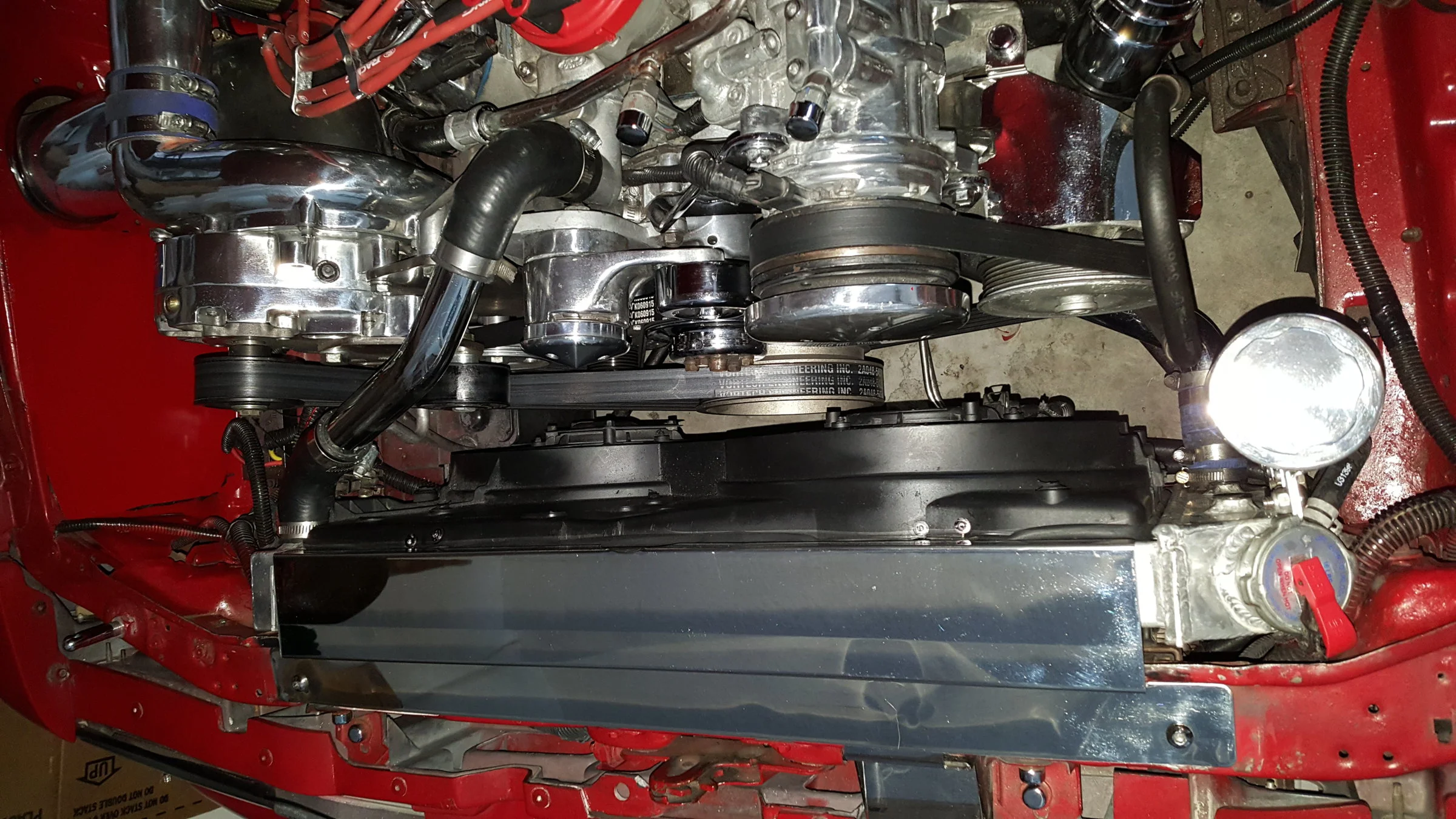

Had that fan and an 8 rib setup on on my car with my s trim Vortech .
Switched to a ford contour dual fan and gained room and they outperformed that fan by a mile .98 degree weather in myrtle beach and never saw more then 195 ish .

^this.... contour/cougar dual fan on mine...

TOOLOW91. U were running the same setup? Flex a lite 52185, with a Vortech system and you had enough clearance? If so, you are the man. That’s exactly the info I needed. That puts my mind at ease. Thank you for input and for everyone else that replied as well.

Mikestang63. That’s a Vortech unit as well?
Yes for 2 summers . And then i made the switch to contour fans which was the best move I ever did .

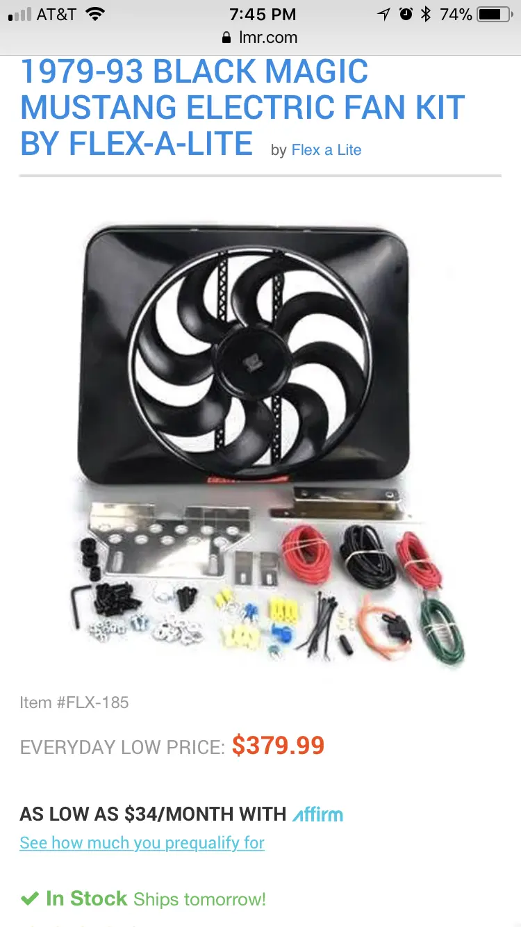

Where are you all finding these contour fans and is there a certain model etc that one should look for? I was looking at this one
This is what they run and I have the same fan.
https://www.summitracing.com/parts/RNB-620-104
Reactions: Reddevil91
That’s the one .

Reddevil91 said:
Wow that’s a way better price. Anything extra I’d need to buy for have it wired up and get it functioning?
You absolutely need a 3g alternator, I have this one from LMR
https://lmr.com/item/SVE-17046K2/Mustang-SVE-130-Amp-Alternator-Upgrade-87-93-50L
You'll need a fan controller. Lots of different ways to do this right. Some use a controller, some use a controller and relay. It's up to you.
I use is a FAL-33054 (flex-a-lite) variable speed controller with "soft start". It turns the fans on at 60% power so there isn't a big amp spike from a sudden load and then increase the power to 100% over several seconds. The controller also turns the fans on for 30 seconds after ignition is turned off to help with heat soak.
https://www.summitracing.com/parts/flx-33054

yes 8rib V3 with a $30 junkyard cougar fan....
