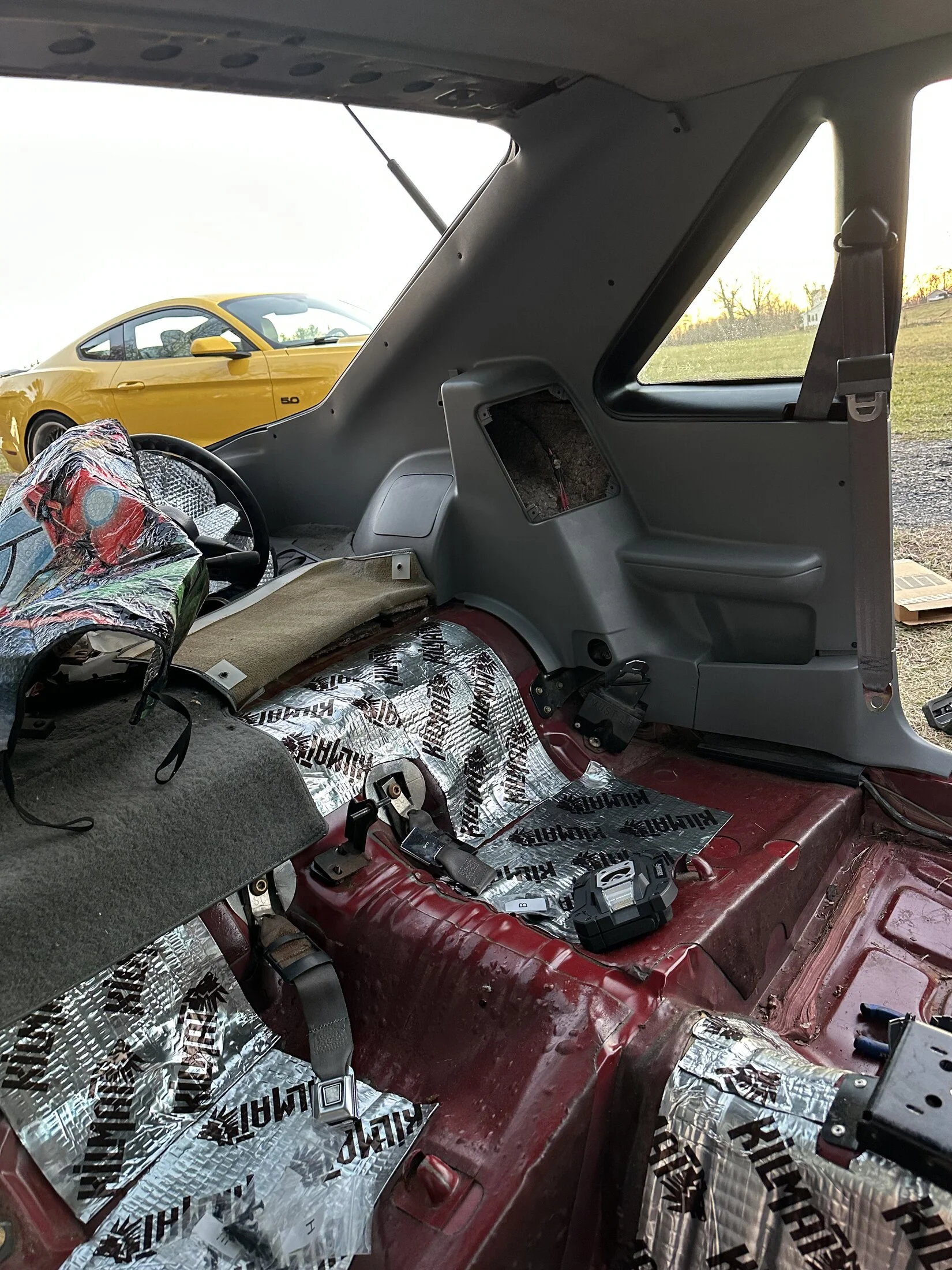

AeroCoupe said:

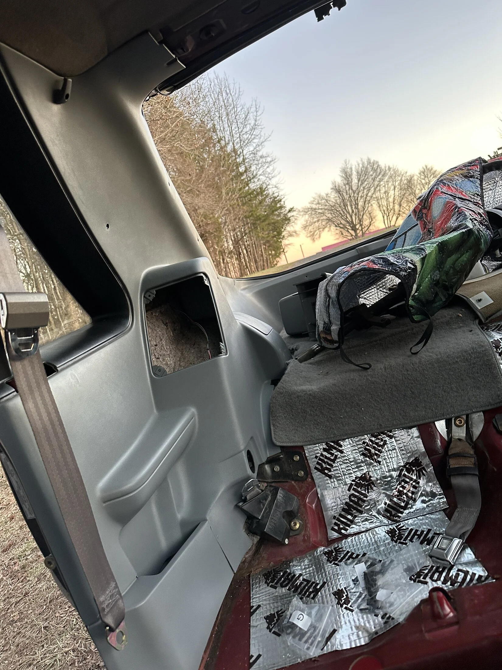

One way to stretch the sound deadening is to checker board it. We used to do 6”x6” squares on large areas like the roof and floor boards.
That is a good idea. I might go ahead and pull the headliner and do that for the roof since it’s already pretty much torn down

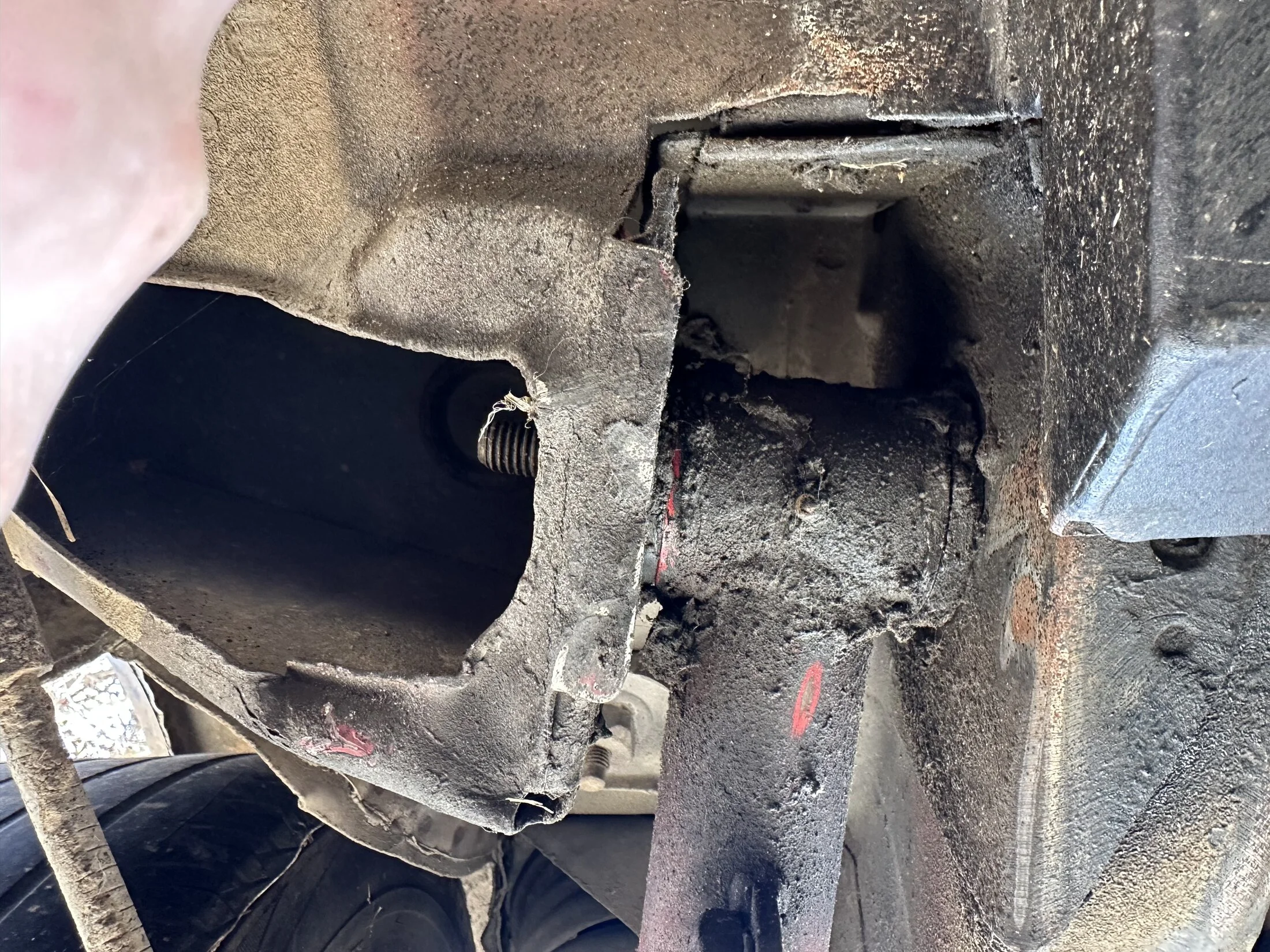

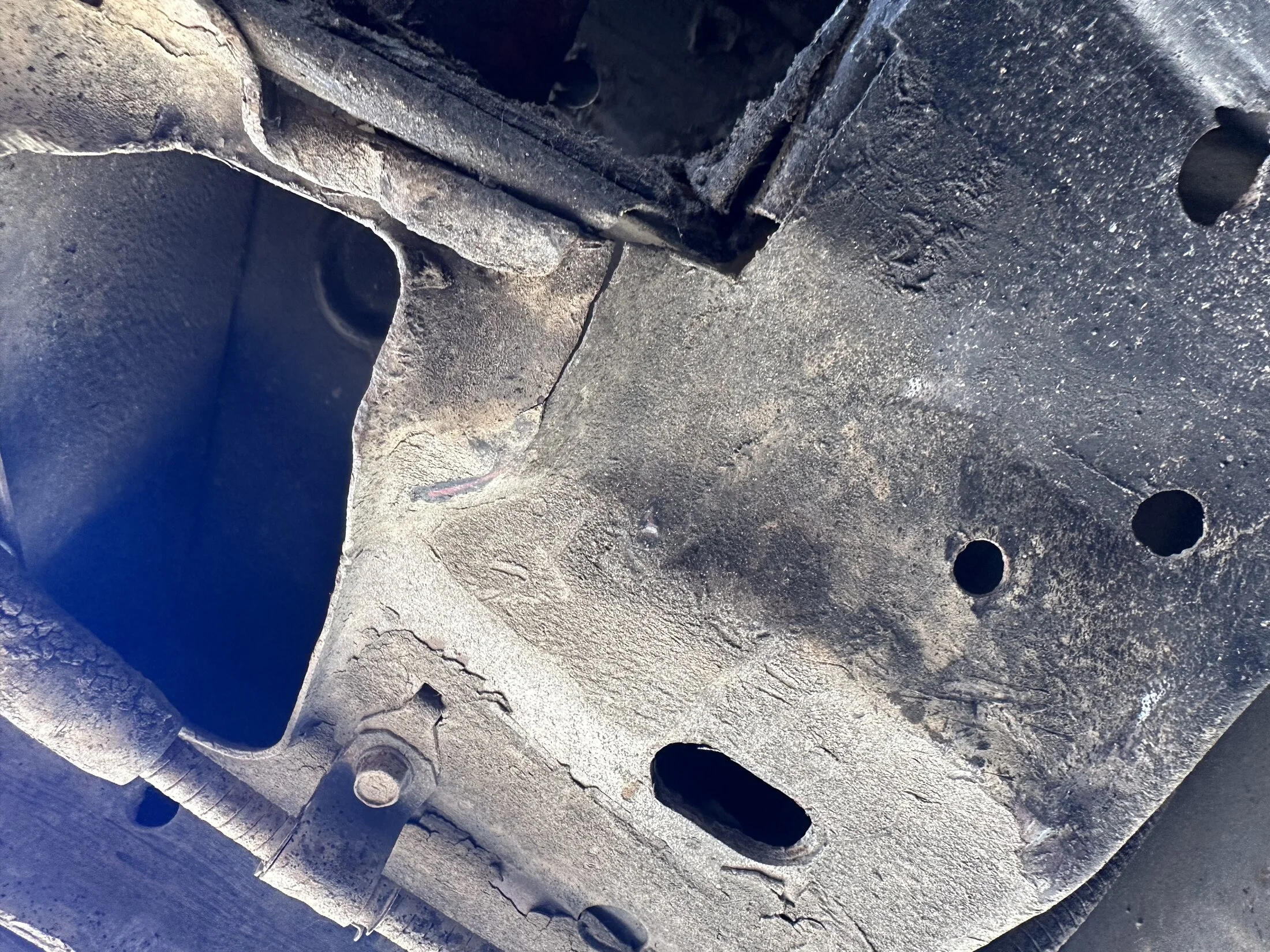

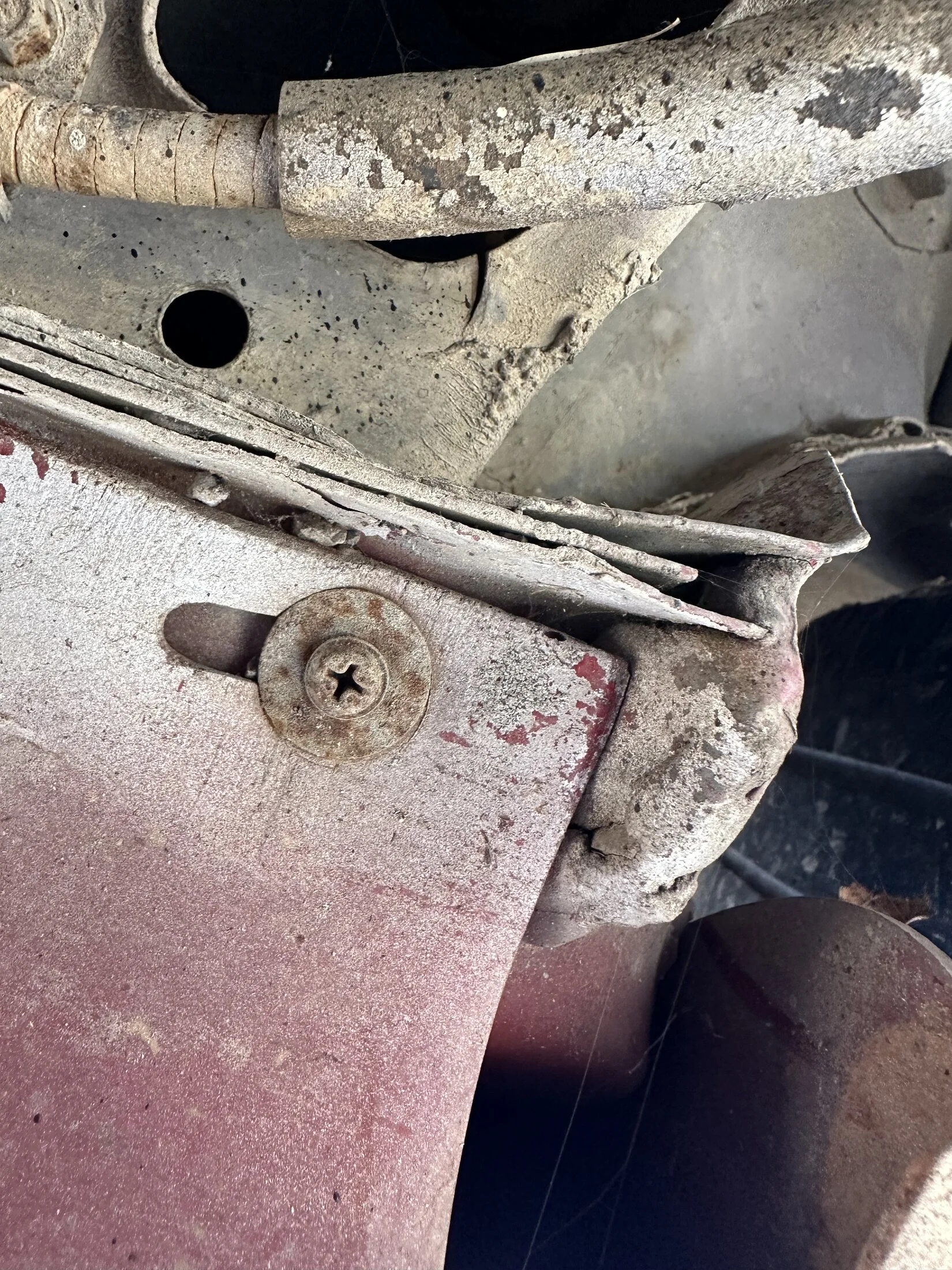

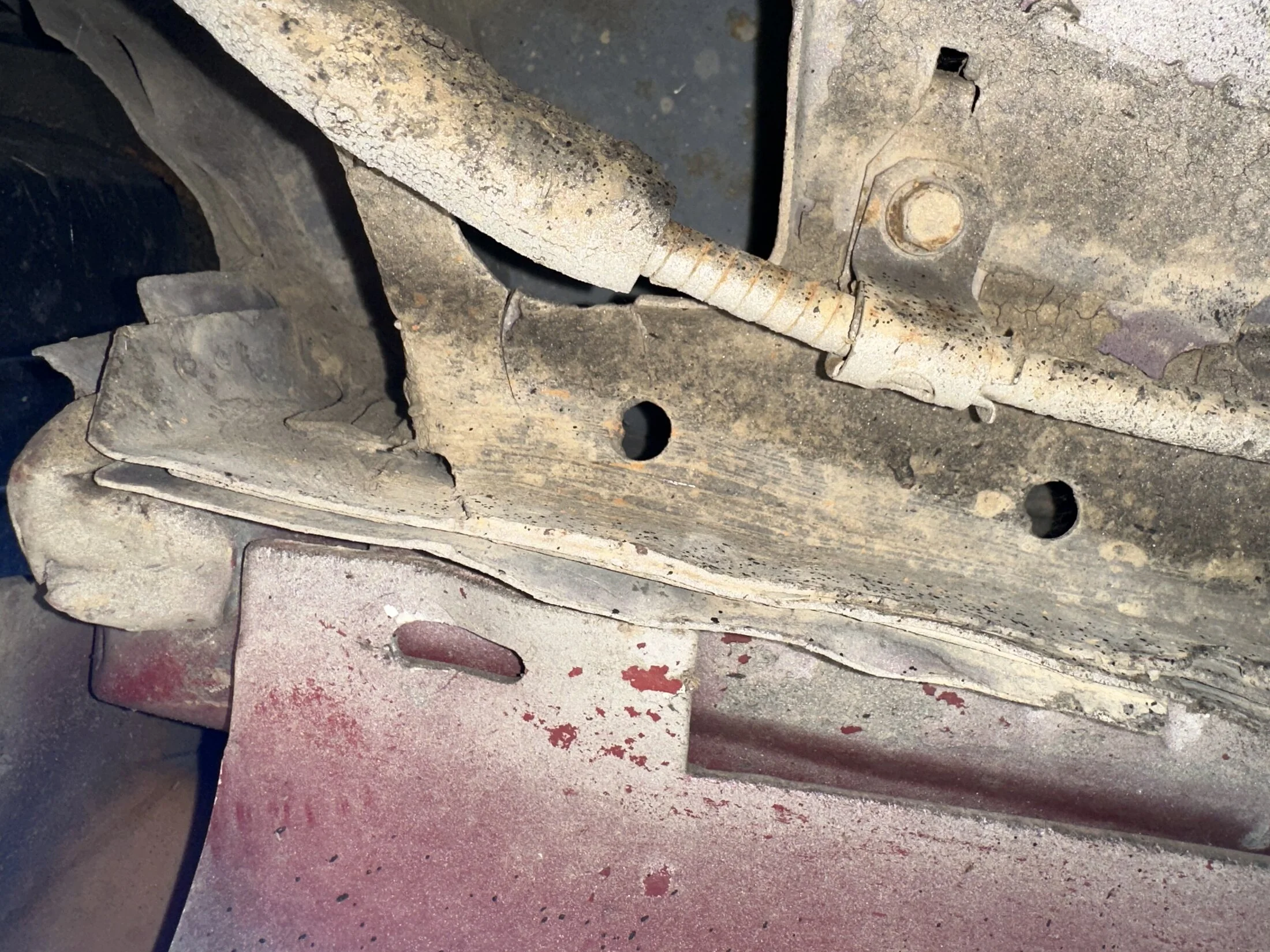

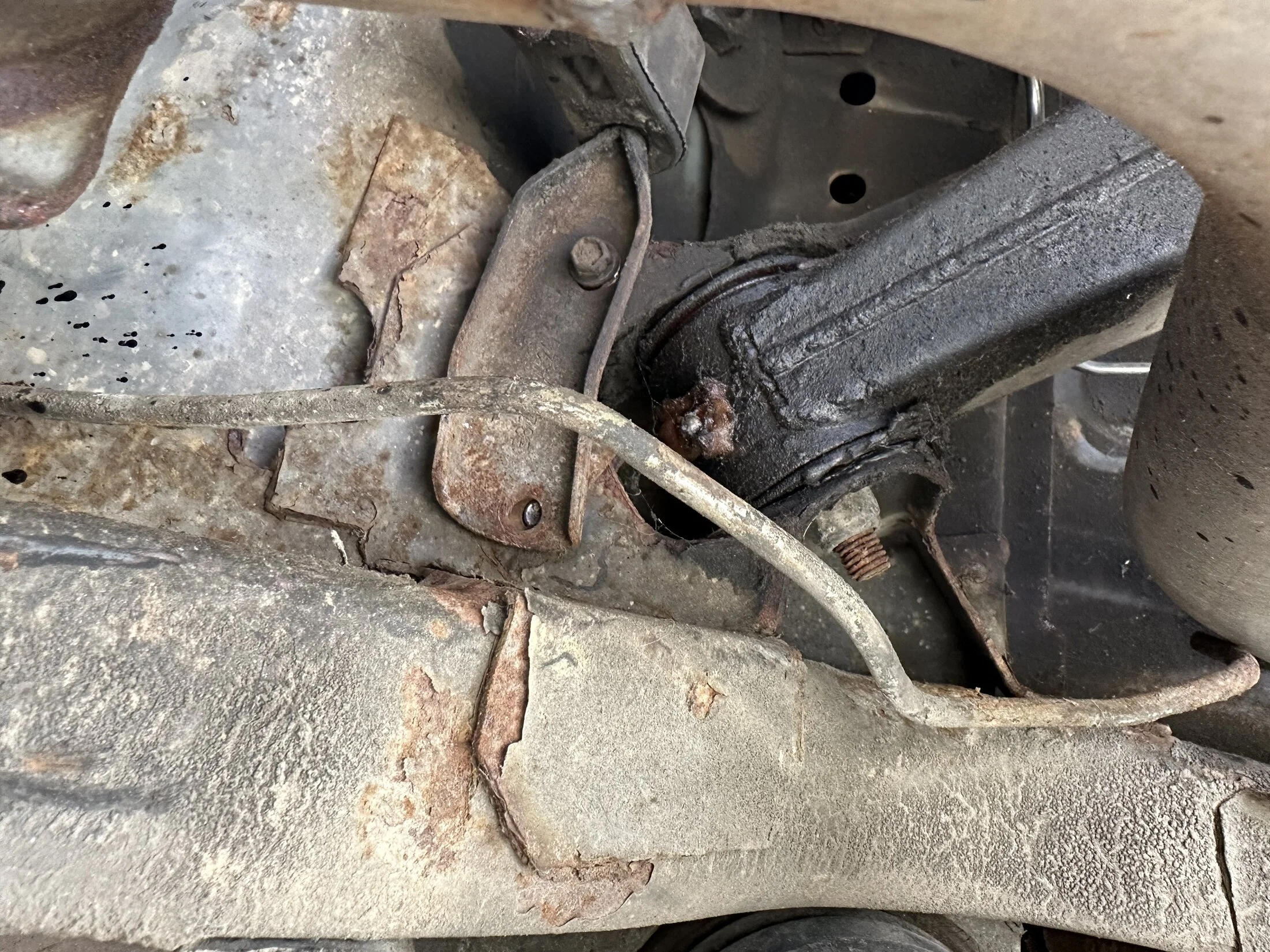

So this isn’t related to the interior rebuild but I did want to get everyone’s advice on this. I was reading some threads on torque boxes and them being torn which would cause popping in the rear. I decided to check mine today and the first two pictures are the drivers side. There’s two rips on it with one being next to the LCA and the other being closer to the body. The passenger side has one small rip next to the body and the fourth picture is just how the lower torque box looks. The upper torque boxes seem to be okay and don’t look too bad aside from being crusty. I don’t see any visible rips in them or the sheet metal beside them. The lowers are a little deformed from the years of jacking up on them is my best guess
So do these rips look fixable? Do you all think this could be my popping noise when creeping slowly though a parking lot or just creeping slowly in general? I’ve checked the bushings and while they’re not the best all the control arm bushings are pretty solid. The u joints are good and I’m not sure the condition of the clutch packs in the rear but I have had the gears swapped from 4.10s to 3.55s and was told everything looked okay. It popped before and after the gear swap.

Weld them up the same way as the cracks for the seat mount. Would also suggest stitch welding the seams where the torque box contacts the floor pan and subframes. Helps with strength and stiffens things up. Do this on both the uppers and lowers. Look for pulled spot welds and address them as well. Welding the uppers will require pulling the back seat and having fire watch. If you are by yourself you can soak a heavy towel and cover the area you are welding in the car.
Wanted to add to my comments above. You will need to remove the UCA's and LCA's from the body mounts so you can also weld up the seams that are on the inside of the torque boxes and upper mounts. Also, cannot stress this enough, clean the areas that you are going to weld. The cleaner they are the better the weld quality will be. Start with degreasing everything then move to a wire wheel (you can get 1/4" shank wire brushes for your cordless drill) and get all the surface rust, paint, etc. off the weld area. After you weld them up wire brush everything again, wipe down with some brake cleaner, allow dry time, use an etching primer, and then either paint or use undercoating.
I just removed the rear end and drive shaft so my buddy had a lot of room to weld things up. If you do not want to change transmission fluid at this time you will need a tail housing plug to put in the trans when you pull the drive shaft. You will also need to plan on plugging the brake lines. I also ended up cleaning up the rear end (power washed, degreased, wire wheeled, and painted) while it was out of the car.
Is it a lot of work? Yes, but if you do all of this your car will thank you and your wallet will later down the road.
I appreciate the info. I guess it’s time for me to stop making excuses and finally get a welder. I’ll only be able to get a flux core for the foreseeable future since I don’t have my shop yet and only have access to 110. Do you think a flux core would do as long as I’m extremely careful and practice plenty before attempting the welds? Also for the one big crack should I drill a small hole in the end of it before welding as well?
I need to replace the upper and lower control arms anyway so I guess that would be a perfect time to do all of that. I’m honestly disappointed that the boxes are ripped but happy I found it before it got bad. If you have any advice on flux core that would be wonderful because I’m so new to welding it’s not even funny. I once again really appreciate all the info and advice

So your torque boxes have small cracks and no where near ripped.
My Miller mig is 110/220 and will weld with shielding gas on 110. Keep shipping welders until you can find one that does both 110/220 and can work with shielding gas.
That’s relieving to hear. I didn’t know how bad they actually were in the grand scheme of things. I’ll check some more another day when it’s jacked up again for any more cracks or tears. I’ll definitely get a gas 110/220 as that’s what I wanted to begin with I just didn’t know that was a thing. I greatly appreciate your help and all the help you’ve provided so far.

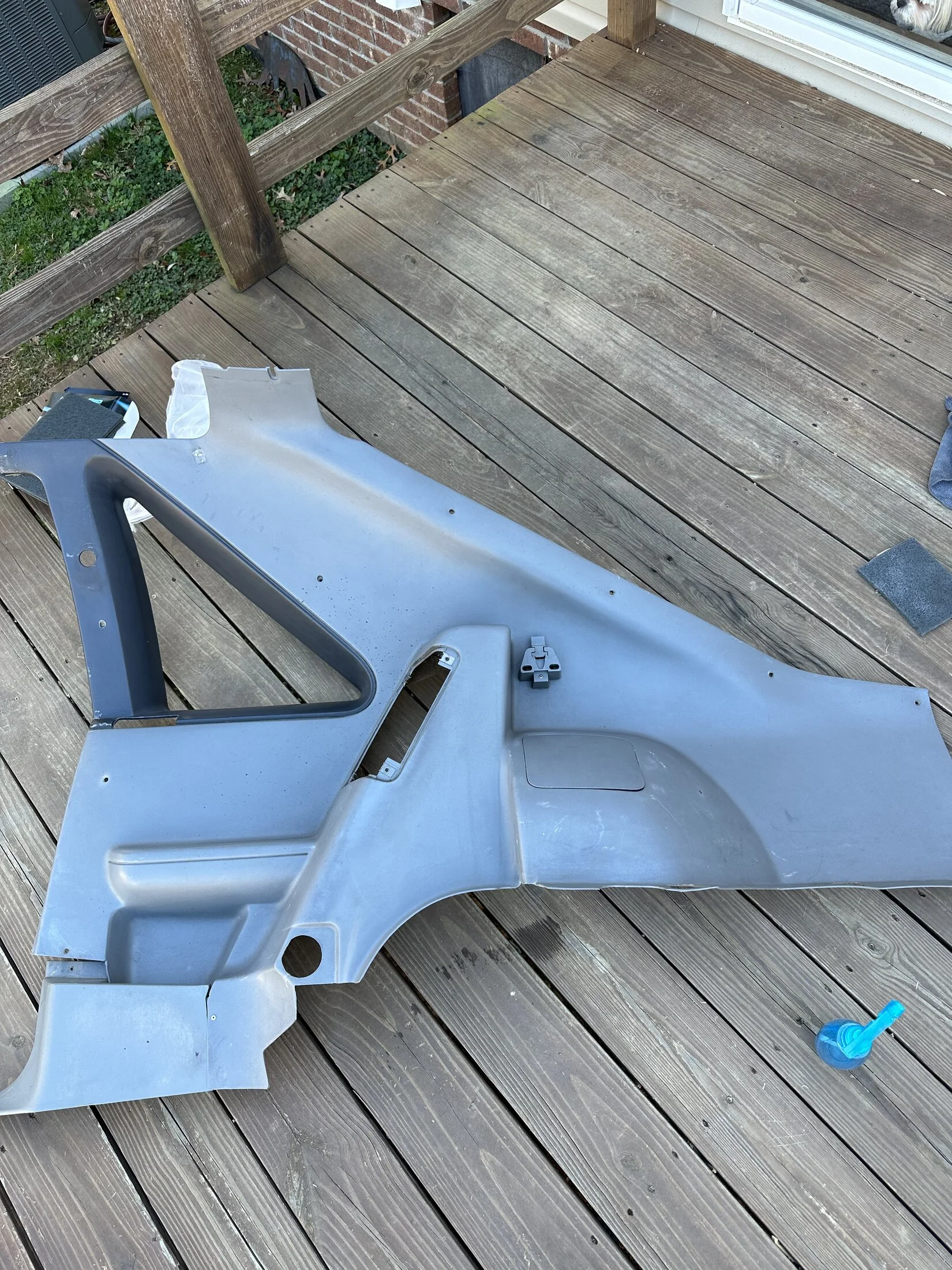

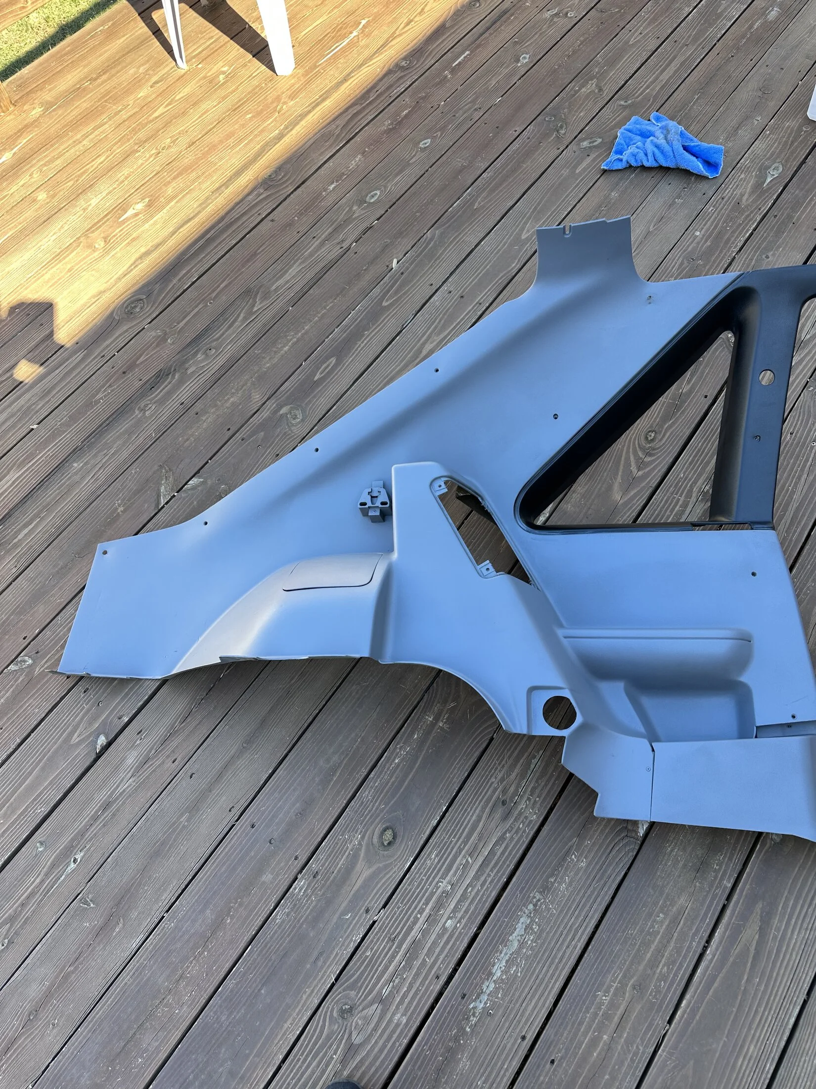

Another day of what feels like little progress. I got the rear quarters dyed and I feel like they came out pretty well. Let me know what you all think.
Not the best photos and even though they’re not the same panel they both pretty much looked the same before and they both came out great on the after. Definitely happy with it. I also got the new computer bracket in and the new evaporator drain seal in.

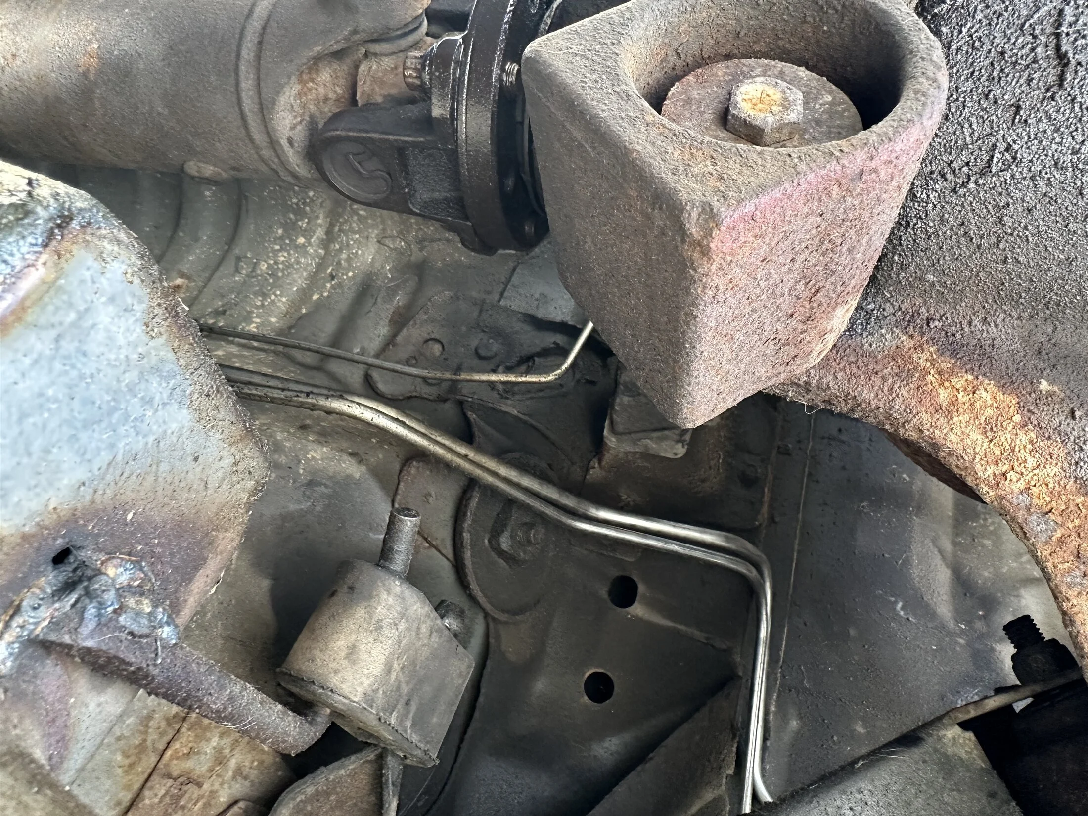

If you all have been through the whole thread you’ll remember I complained about the subframe connectors rattling against the drain on the passenger floor pan, I fixed that today with a piece of the scraps from the closed cell foam. Tomorrow will be dedicated to dyeing the dash and the rest of the plastic interior pieces.

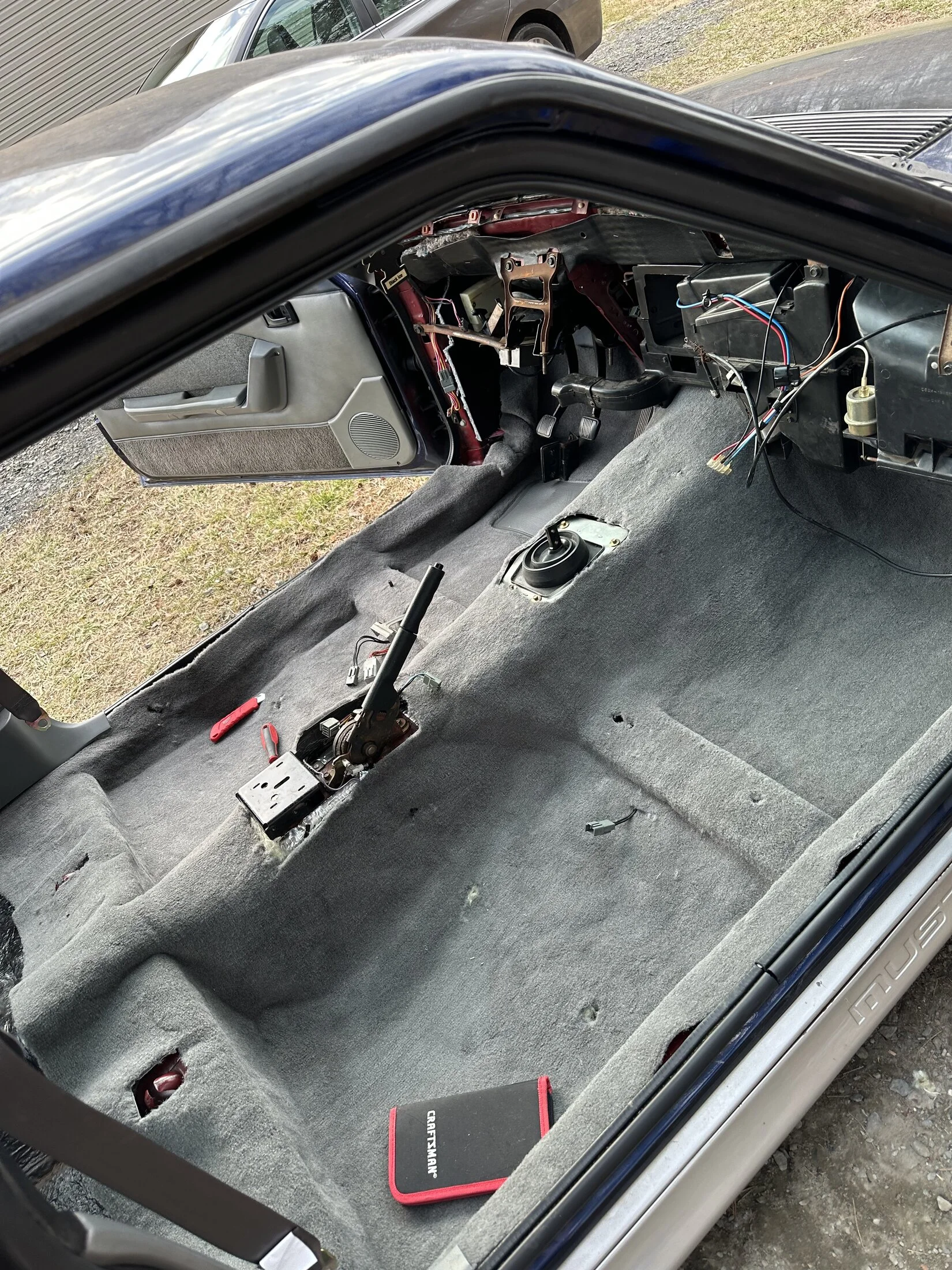

It’s been a long time coming but new carpet is finally in. I don’t really have an excuse as to why it took me a year and a half other than the guy I had do the patch work had the car for at least 7 months of that year and a half lol. Passenger side fit perfect with no issues at all. The drivers side was a different story and still isn’t 100% but it’s pretty much there.

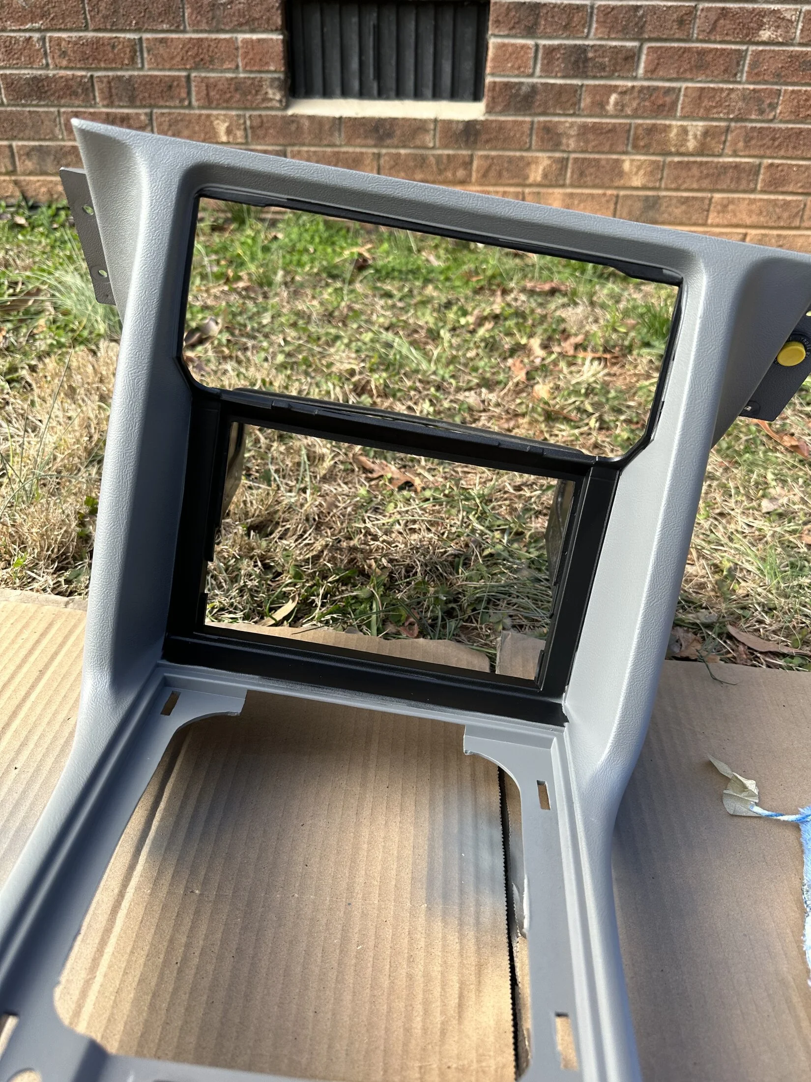

I also got the center console dyed today and the cup holder console matched.
This isn’t the original one from the car. I replaced it because the original had some big gouges in the plastic by the radio well area. Tape lines certainly weren’t great but I’m no painter so go easy on me lol. I really like the look of the SEM presidio grey with the SEM satin black. I’ve been at it about 5-6 days in a row at least 10 hours a day but this progress thread is finally coming to a close. I’ll update once the dash is officially in and everything is hooked up. I just want to give a huge thank you to everyone who has helped along the way and given excellent advice. If it weren’t for you all I would’ve given up a long time ago

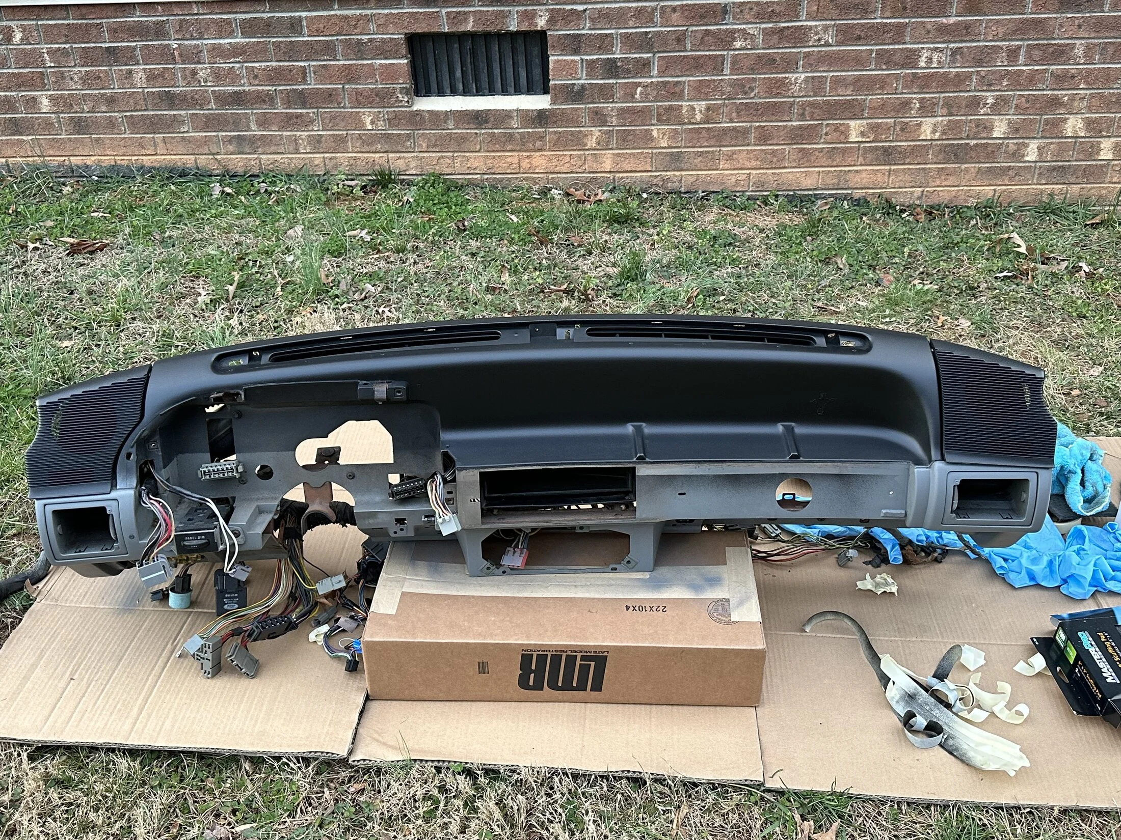

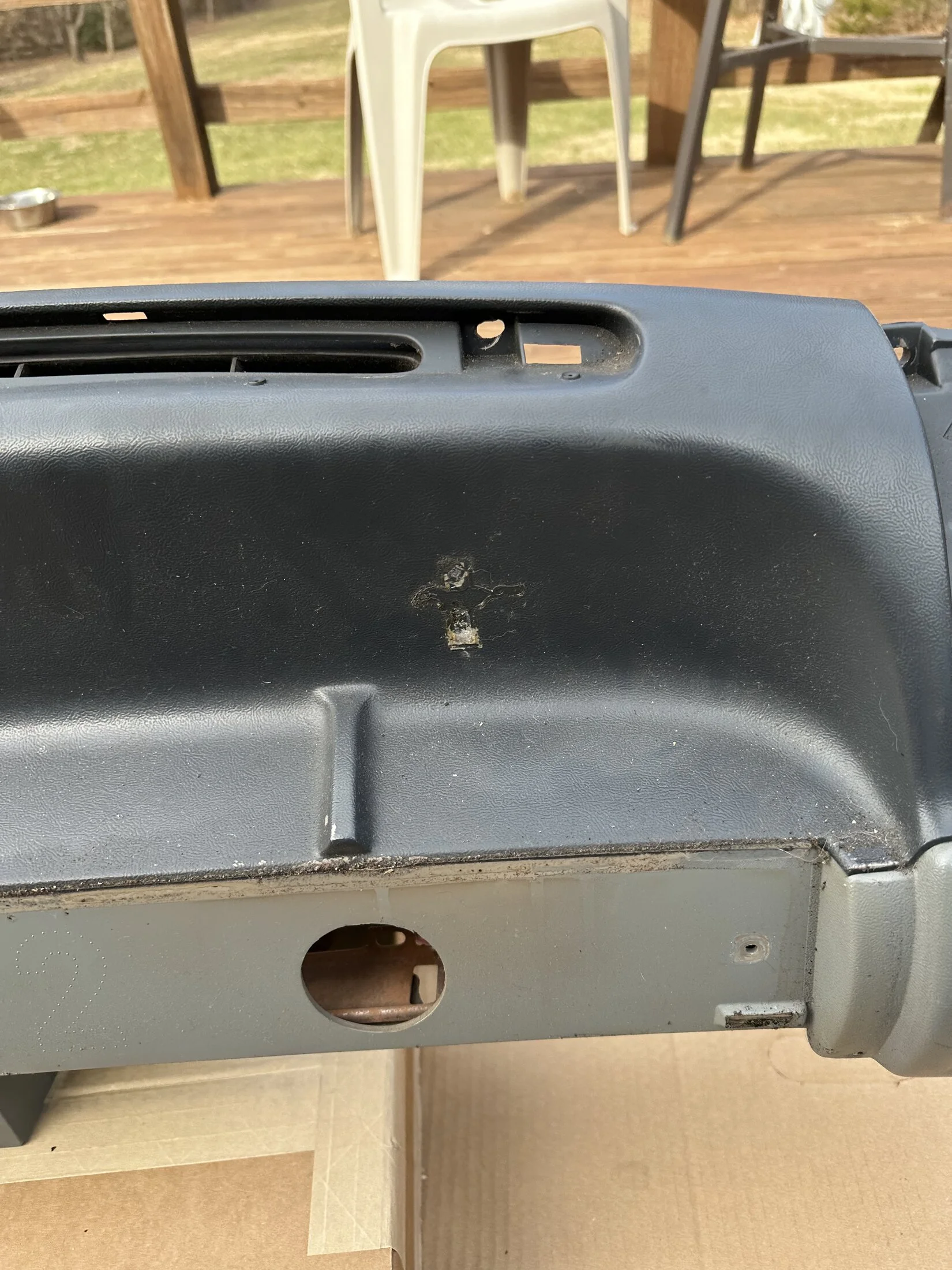

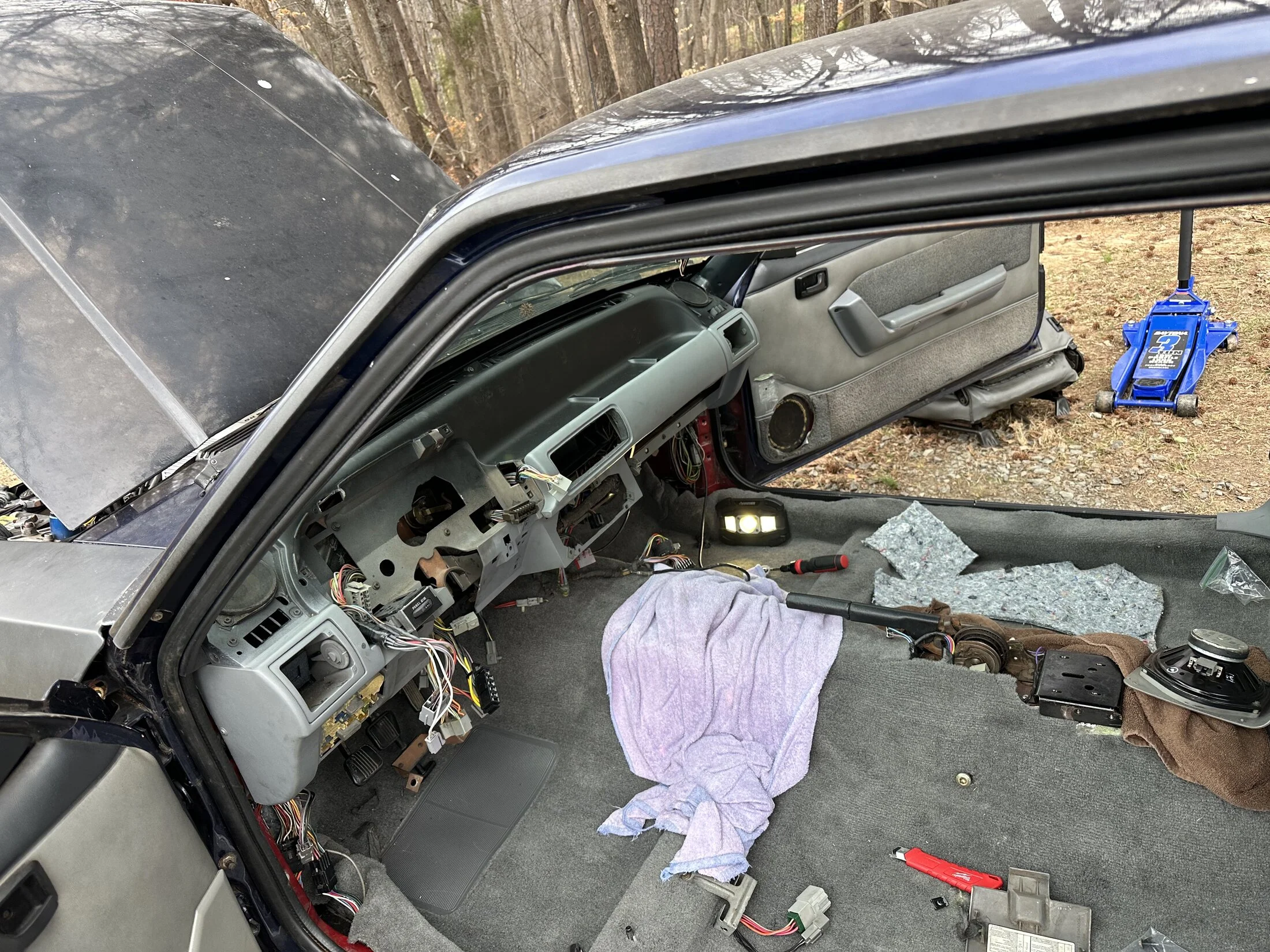

Well the dash is in and that was no fun job by myself but I got it done. The gigantic dash harness gave me a lot of trouble but I eventually got it.
I had a whole lot of trouble with the hvac temp control cable. It didn’t seem to like any way I tried to route it and it is super stiff which it always has been. It’s crusty and nasty and I should’ve replaced it while I had easy access. I also can’t get the bundle of wires by the drivers kick panel to cooperate. Other than that though I’m just ready to get it back together the rest of the way. Hopefully the weather permits
