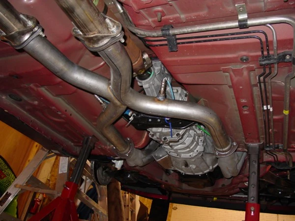

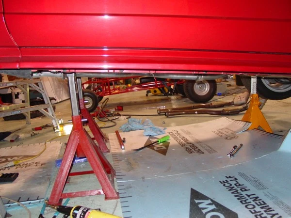

FRCFED4.6 said:
They SUCK.. The fit was horrible and the price difference didn't even come close....
Again, No problems. I've been installing headers for 20 years, took ahwile on this combo but like anything in life - the next time will always be easier.
I can say that I've never installed any other brand on a 4.6
I've attatched a few pictures on my install

Are you satisfied with their quality? And do you happen to have part #'s for them?
Also, the obvious next question, do you think the price vs performance was worth it?
I for one feel the pipes are worth $220. I own a business and have plenty of money (not to brag) and have spent 10's of thousands of dollars over the last 20yrs drag racing. I've paid top dollars for parts at times that weren't worth a hoot!
I ordered the pipes at a local speed shop, opened the box before I took them home and I'm satisfied
BTW I threw the boxes away and my shop didn't write down any part #s on my invoices.
Took the car to the track and destyoyed the rear end on the first pass but I'm sure the car will run high 12's with the mods in my sig.
