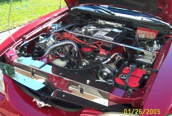

Great Mod...and worth the $$$.
I used the stock rad cap.
I kept my stock cover for awhile, and just painted it black with Krylon Fusion..
Then recently I got this cover from UPR:
