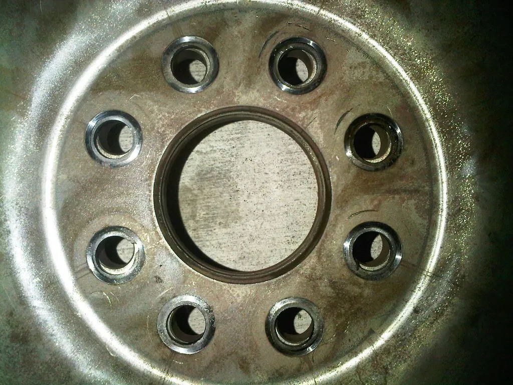

Hello Folks- hoping to get some guidance regarding my issue, appreciate the space.
I have a 2000 GT A/T which was totaled in an accident- body shot, engine great. I found a 2002 GT manual which is cherry and has a blown engine. From all I've read on the boards and in asking other Mustang pros in person, it was supposed to be pretty seamless taking my 2000 engine and matching it with the 2002 manual tranny. Hasn't been the case so far- the flywheel bolt pattern is just ever so slightly off (pic attached).
I'm not sure what to do here, I'm pretty bummed and soon to need a running vehicle to get to work. Can anyone tell me why this may be the case, when I've never read this as being an issue? Will I need to have to have a flywheel made for me from a machine shop?
+1 on above. Move to a different O'clock position and it WILL fit assuming the base number of bolts are the same. The 2000 GT should have an 8 bolt flywheel whereas the 2002 GT should have a 6 bolt flywheel.
When converting a motor from automatic to manual remember to remove the pilot bearing. Otherwise the torque converter won't fully seat.

I've turned it and turned it repeatedly, but to no avail. The forum doesn't seem to allow me to post an attachment, so I placed a pic of my problem on Flickr. You can see where the bolt hole edges are slightly off. And again, I've rotated and rotated and this is the best I can get.
Here's the pic:
http://www.flickr.com/photos/awwphoo...n/photostream/

Count the number of bolt hole on the valve covers. The Windsor and Romeo are different.
There WERE some Romeo's produced with 8 bolt cranks. They are rare. Ford ran short on 6 bolt cranks and used what was onhand. But this goes to show how similar the motor's are.
In my own case, I took out the 2000 GT Windsor and replaced it with a 2004 Romeo from a Crown Vic.
It looks like you are comparing the flywheel to the flexplate. Have you tried it on the motor? Note, the bolt holes are NOT symmetrical which is why they have to be re-clocked.
Thanks WM- yes, I was using the flex plate as a guide, as I wasn't matching it well up against the motor. I'll try a little more carefully again, and appreciate the info on the windsor vs romeo cranks
Ok. So here it goes- I feel like a dumb***. I tried lining the holes up, didn’t work. I posted. Basically everyone said keep turning. Tried for 30 minutes, no luck. Posted. People said “keep turning, go slow”. I turned some more, slow. No luck. Posted. People said “no, turn very very very slow”. At that point, I started thinking nobody understands what I’m trying to say here, they just don’t get it. I’m turning it and turning it and everyone here seems to have no idea what they…. Oh… it’s lined up…
Thanks everyone. I’m man enough to come back and say you were right and boy was I wrong- but hells bells, it’s almost like you have to chant, turn, close one eye, whistle and speak some magic to get the holes to line up. I’m still not sure I’m not damaged by the whole experience.
