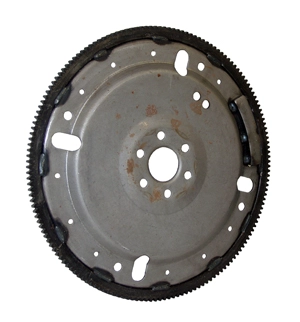

New to this forum. I'm doing an EFI swap into a '66 using the engine from a '90 Mustang GT w/auto transmission. I have a World Class T5 that i will be replacing the auto with. Is there a difference between the flywheel between the auto ans manual? Thanks..
an automatic transmission uses a flexplate rather like this one;

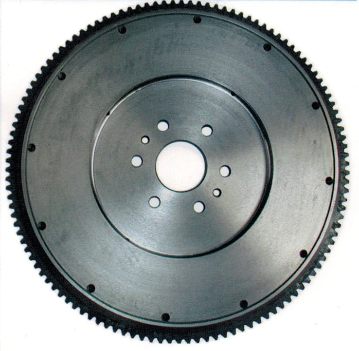

where as a manual transmission uses a flywheel like this;
