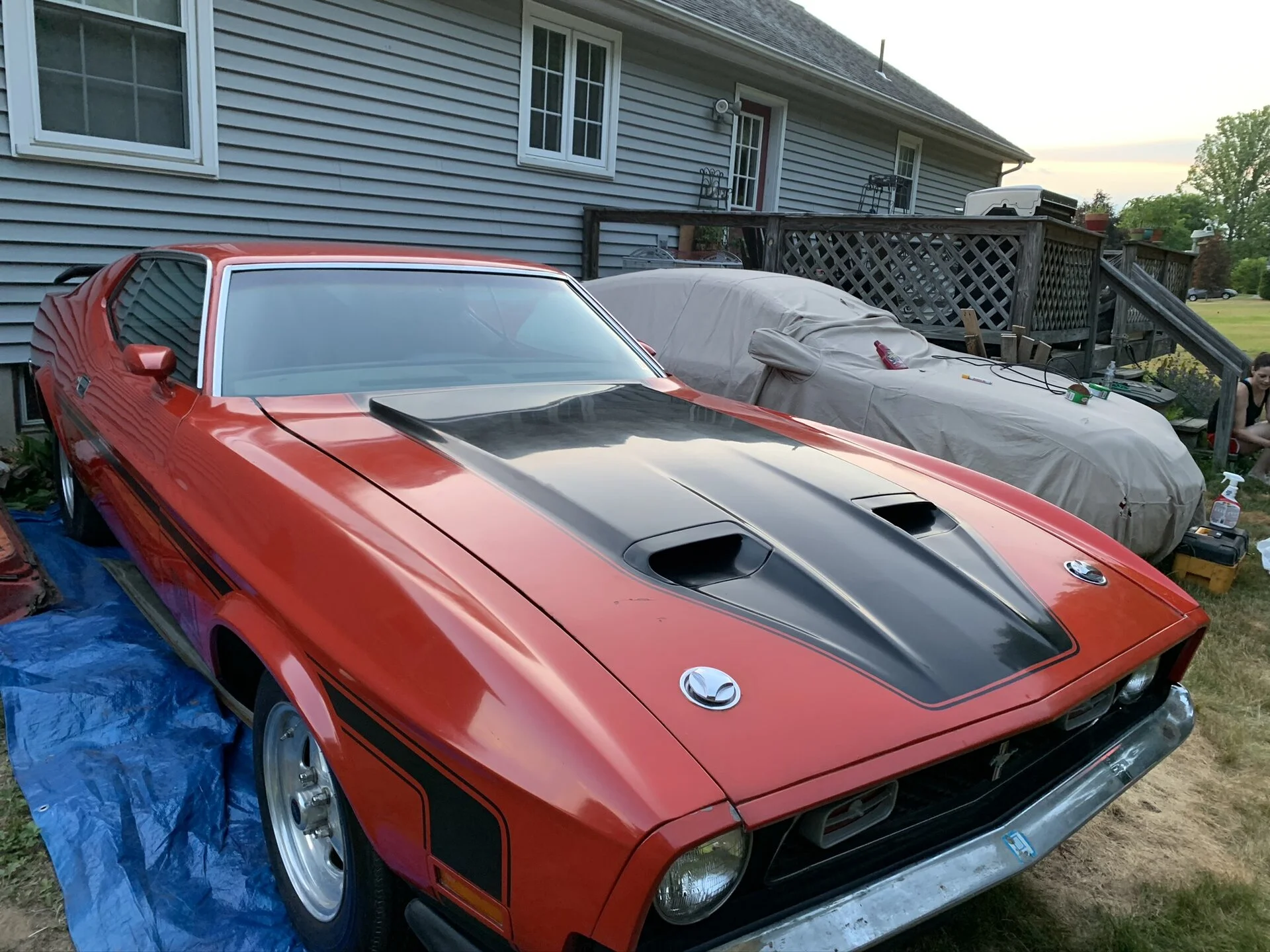

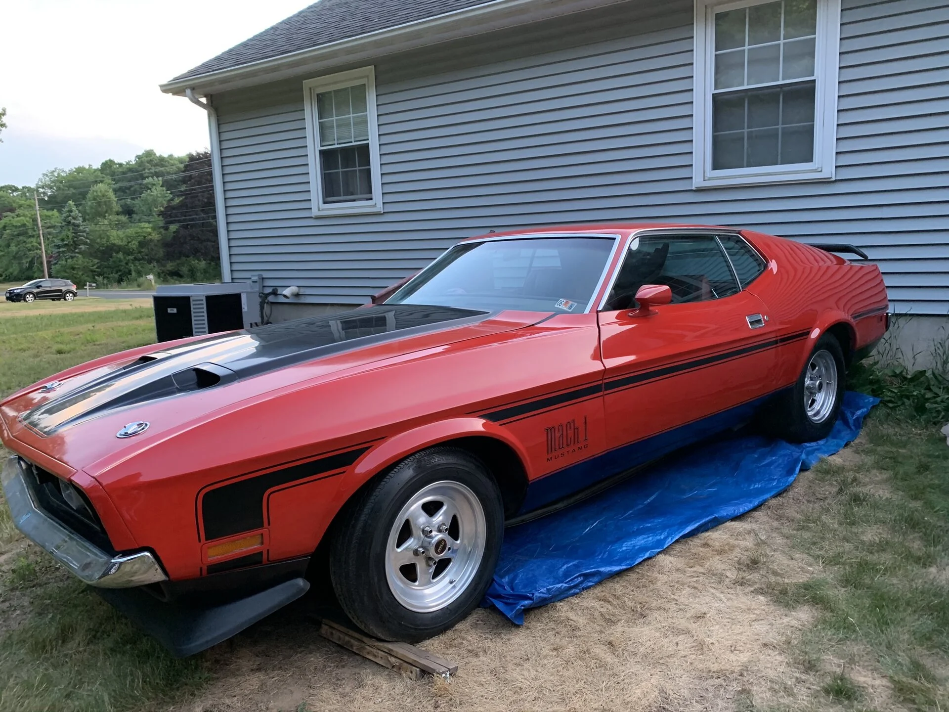

Any Pic’s of your 69’?
My 71’, 351C w/ built FMX. Last pic’s taken before the motor came out & I stuck it on the lift. It’s miffed... 408 In process..

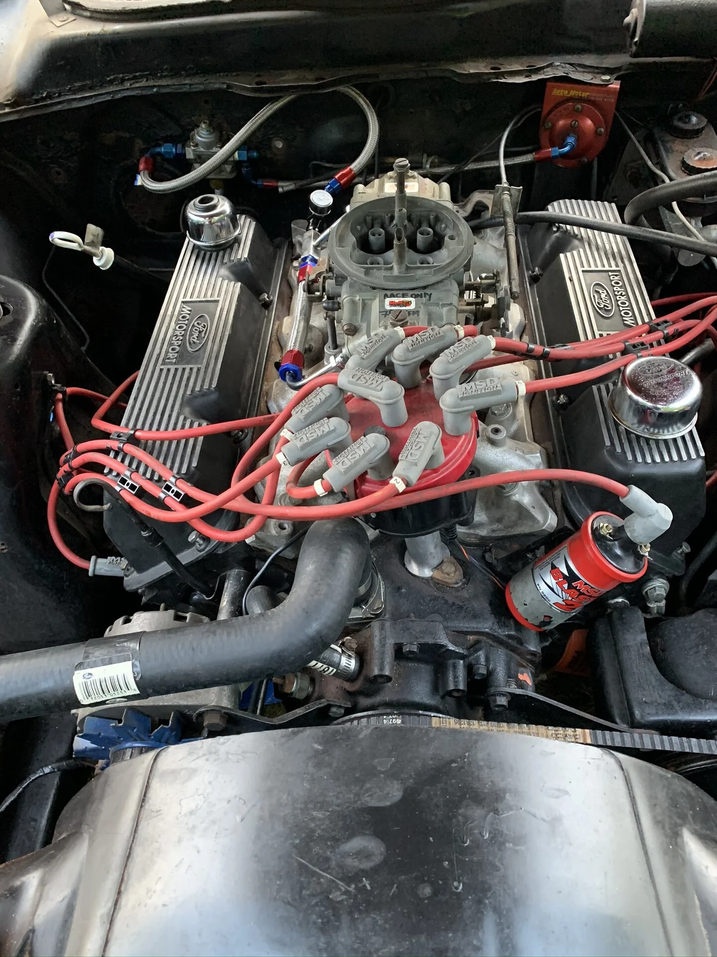

I don't have the aluminum heads and have only the 600 cfm carb. Heads are studded as well. At 5600 rpm it ran 350 for torque and 325 horses. Engine builder thought it would run around 285 to 300 so they were suprised with the numbers. I also have the dyno video as well. I just want a street machine, not planning on going on the strip. I like the lumpy cam in it. The anti-freeze is a bit rusty coloration, but i hear thats quite normal with a new build. I was running water to flush it out, but had to flush it out as temperatures were dipping to freezing on clear nights.
