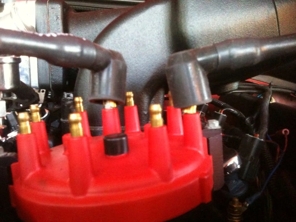

Broke down and bought some Livewires which I have wanted for awhile. Have had them since Feb but just got to the point of being able to install them on the car.....or so I thought...
Not sure WTF is wrong w/ these things but they are getting sent back for another set.

Travis .. they sent you the wrong wires .. send them back and get the correct ones. Ive had my set since 07 and there still perfect.

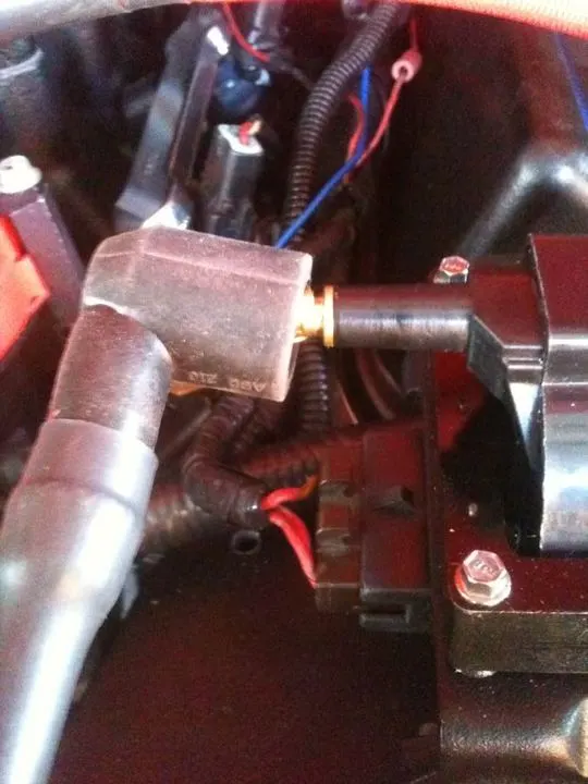

+1. It's the totally wrong wire set, not necessarily a reflection of the quality of the wires themselves. Those are for an old style distributer where the lead goes into the contactor.

I'm not really to happy with summit right now. This wire set and the power steering pump all came in the same order back in Feb. Like you said in my other thread Kurt that pump is for a 93 and these wires were not for the cap I have. I ordered the right parts I always double check and even my order in my recent orders section shows I ordered the right parts, but they sent me the wrong parts twice in the same order. Ive never had any issues with summit and Ive been ordering from them for along time but maybe it was rookie training day or something.
Ive run Taylor, Ford Motorsport and I just wanted to try these. I did send them back to get a replacement set
They have two part #s for our eng type that are easily mixed up, if you ordered from Summit you ordered the wrong ones.
How do I know, I did the same thing. I sent those back and they sent me the correct ones. I run those on my car and love them, plus they look great with the sleeving!

yeah they do look really nice which is why I want to keep them. I called DUI first and they guy said they were defective, so I called summit and they said they were the wrong ones. It was obvious they were not meant for my cap.
