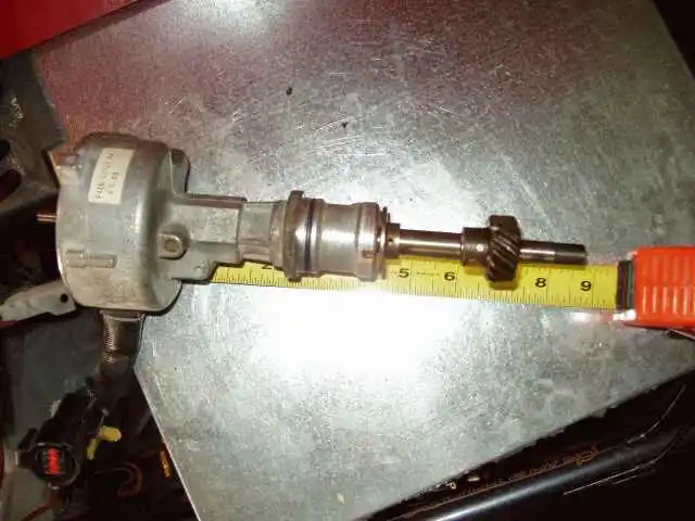

Do you have this stock dizzy that is .5 inch longer? Take a pic of it next to a measuring tape, ill compare it to my stock dizzy..
Lengths
Don't know how good the pic will be. The lengths I measured are:
8 1/8" from bottom of "head" of dizzy to end
5 1/2" from where the dizzy seats on the block to end
1 1/2" from bottom of gear to end
Hopefully this may help. Thanks for your help!
Part # F4ZE 12127 AA

85, 78, & 94 dizzy in hand
yellow1995Cobra said:
Hey no prob man. Like i said before all the late model 302's are the same (longblocks, besides pistons), so any carbed dist for any of those years will work for you, do you have the aftermarket one, or are people telling you the shaft lengths??
I actually have an '85 stock dizzy & a '78, and both are shorter by 3/8", below the gear.
Every supplier (and 5.0 person) I've talked to has said the dizzys are the same, but the fact that the ones I have are different lengths concerns me. I am guessing that the '94 was lengthened to give it a bit more strength or something. I would just try it if I had some certainty that the oil pump shaft would engage, and engage enough not to snap.
