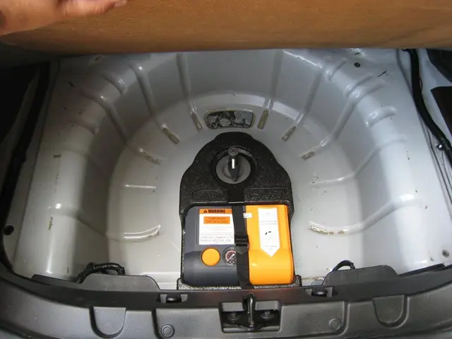

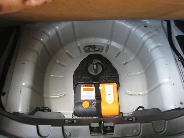

Spare tires....we don't need no stinking spare tires!!! :mad:
this resembles my trunk after i got my cobra brakes :)

As for the spare issue. I had the factory bullitts with OEM size tires so i could rotate, so i would do the spare to the rear and put a rear wheel up front. Never had to do it thankfully. I do waaaay too much long distance driving to run without a spare. Sometimes i would carry another 17x8 mustang wheel when i was going far from home. AAA blows. I can change a tire in 10 mins...why wait 2 hours for them to do it for me?
