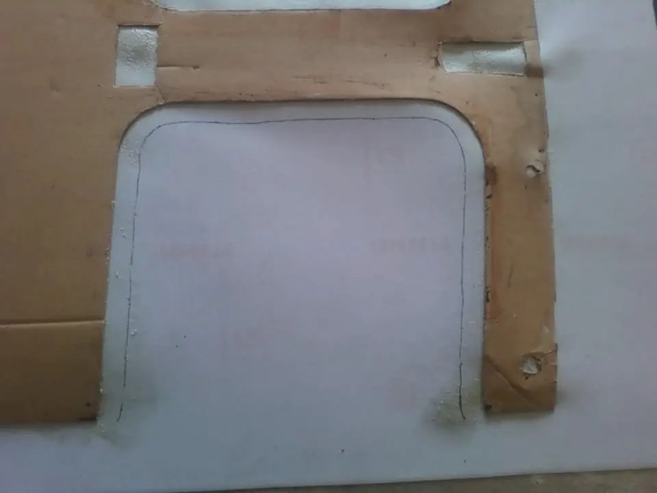

Here you can see the cut lines for where you have to stretch and tuck for the roof openings.

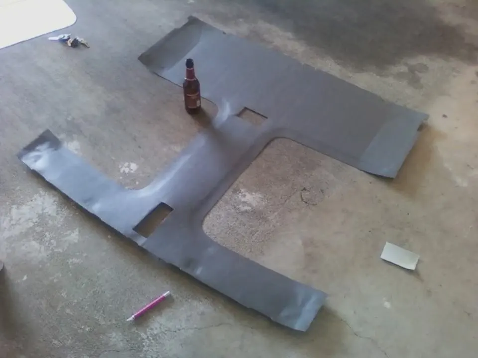

A rolling pin works really well to get out the bubbles and make for a smooth surface. But I'm a dude, I don't own a rolling pin. So I made do with a beer bottle. :nice:

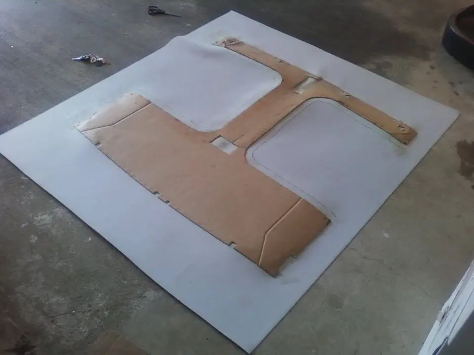

I glued the backing board and the liner together, but I also stapled the edges that would be covered by interior trim for extra hold. It works pretty well, just make sure the staples get covered up. Sorry about the crappy cell phone pic.

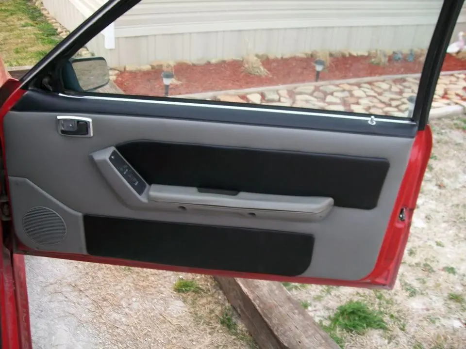

BTW, Jo-Ann fabric store is the ****! That's where I got my vinyl for my door panels.
